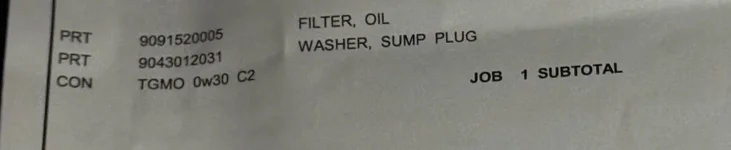

Confirmed, 0W-30, C2.
The engine was immediately less rattly. Very happy not to have the 0W-20.
Also got a sample for an oil analysis. I am curious to see how much diesel is in the oil.
