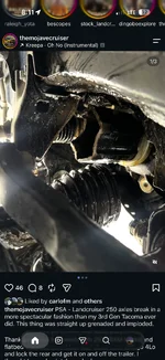

Another one bites the dust.
This popped up on my instagram feed.
Also note looks like the driver side as well.
Yeah, we get to be part of this lol
Just like the 100 series guys and the busted front diffs
Guess it’s not as bad as the Tundra peeps
