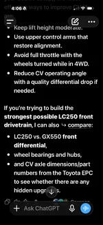

For what it’s worth
Mostly confirming previous research on the subject
