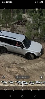

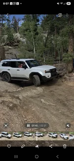

Wanted to update with some information. I just upgraded to 275/60/20 Continental Terrain AT SL on my stock LC/LC. I drove it 1200 miles at strong highway speeds to Colorado, handles great, relatively low noise.
Yesterday I just did Hacket Gulch... performed unbelievable. For a true do it all tire, with occasional off roading, I couldn't recommend enough. A++
