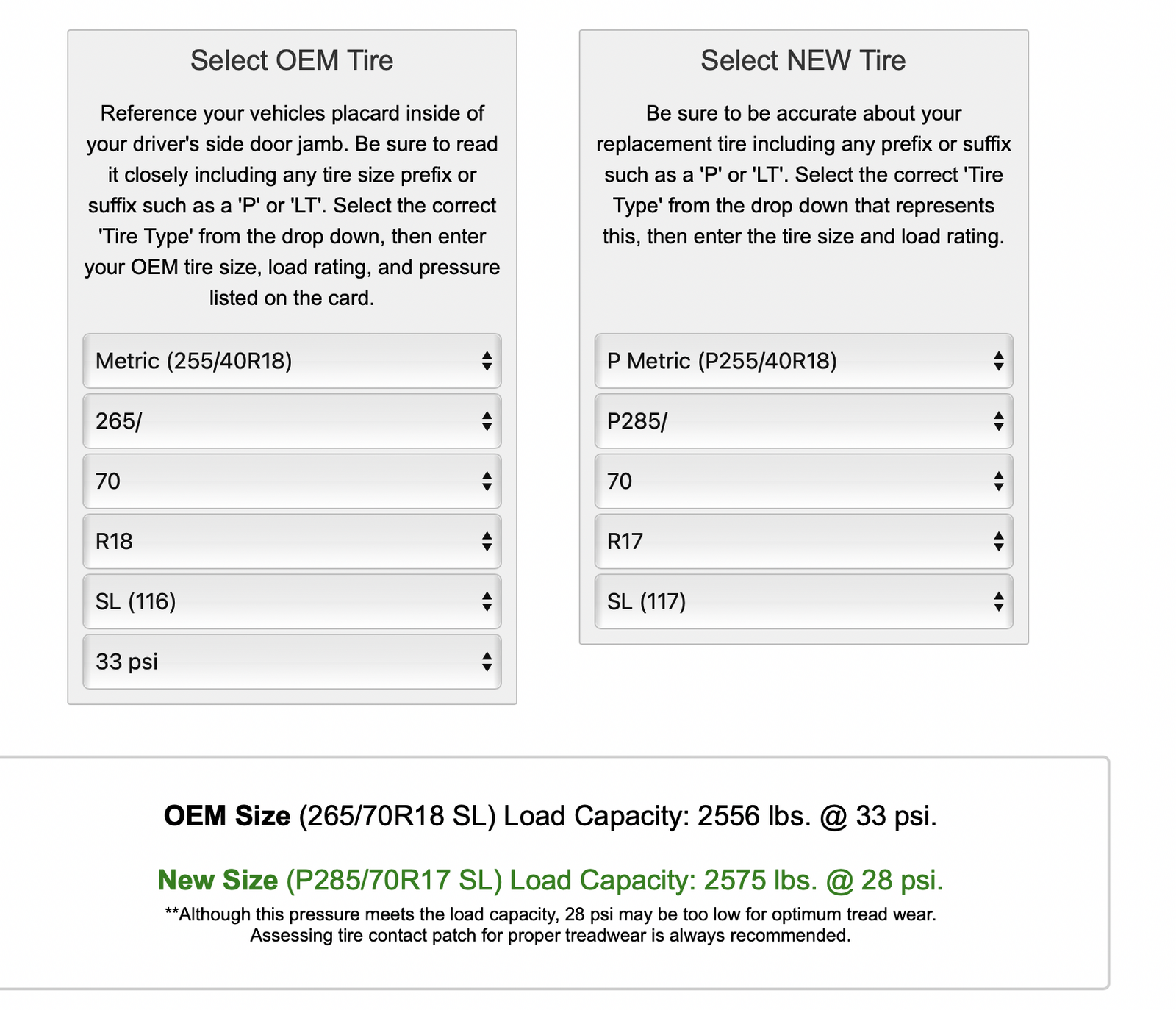

I'm going from the stock 245/70r18 rated by Toyota for 33PSI to 285/70r17. I put this info into the tiresize.com calculator and it suggested 28 psi which is what I'm currently running: Tire Pressure Calculator

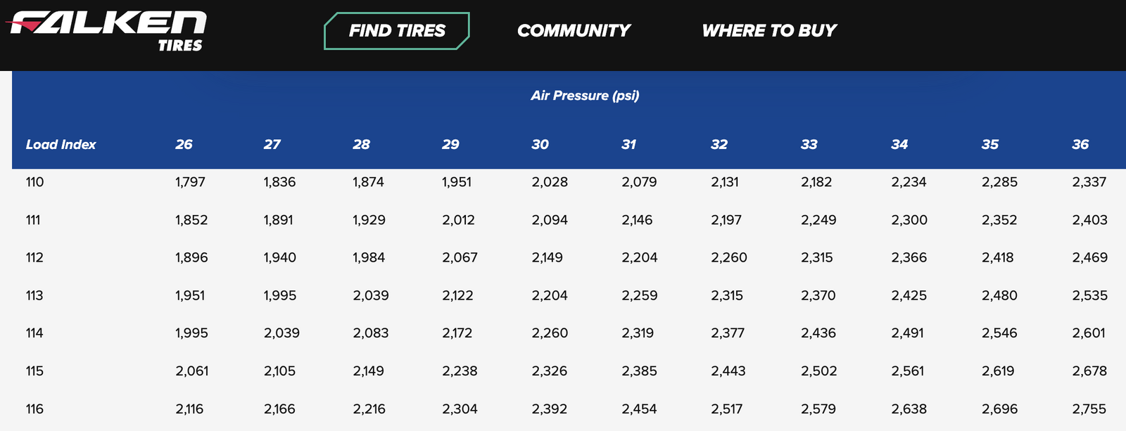

I did find some charts on Nitto's website: https://www.nittotires.ca/sites/default/files/2017_load_and_inflation_tables.pdf
According to them, the SL 116 load index can support 1830 lbs per tire even at the lowest pressure listed of 22 psi. 28 psi would get at 2216 lbs per tire which seems plenty for this weight vehicle. When they installed the tires, they had them inflated to around 33 psi, and I noticed the bumps in the road were a bit more pronounced. Lowering to 28 psi seems to have softened the ride. Also, since I'm using a narrower 7 inch wide wheel on a wider tire I'm erring on less PSI to get more even tread wear.
Decided to look at the table again and with the new information about the load index on your tires (110 load index) compared to the OEM 20" tires (112 load index). I'm including a screen shot of the table from Falken. I think I accidently misquoted some of the values.
110 at 33 psi is 2182 lbs. (245/70R18 tires)
112 at 33 psi is 2315 lbs. (265/60R20 tires)
Since you're going from the 110 to a 116, here are the relevant values and psi that make sense based on the 110 at 33 psi:
116 at 27 psi is 2166 lbs (pretty close to the load for the 110 index)
116 at 28 psi is 2216 lbs
116 at 29 psi is 2304 lbs (pretty close to the load for the 112 index)
I double checked the load index on the 20" tires and the load index is 112. I think it's curious that Toyota would specify an inflation pressure to match two different loads. The conclusion remains the same - looks like 27-29 lbs is a good range of psi on your tires.

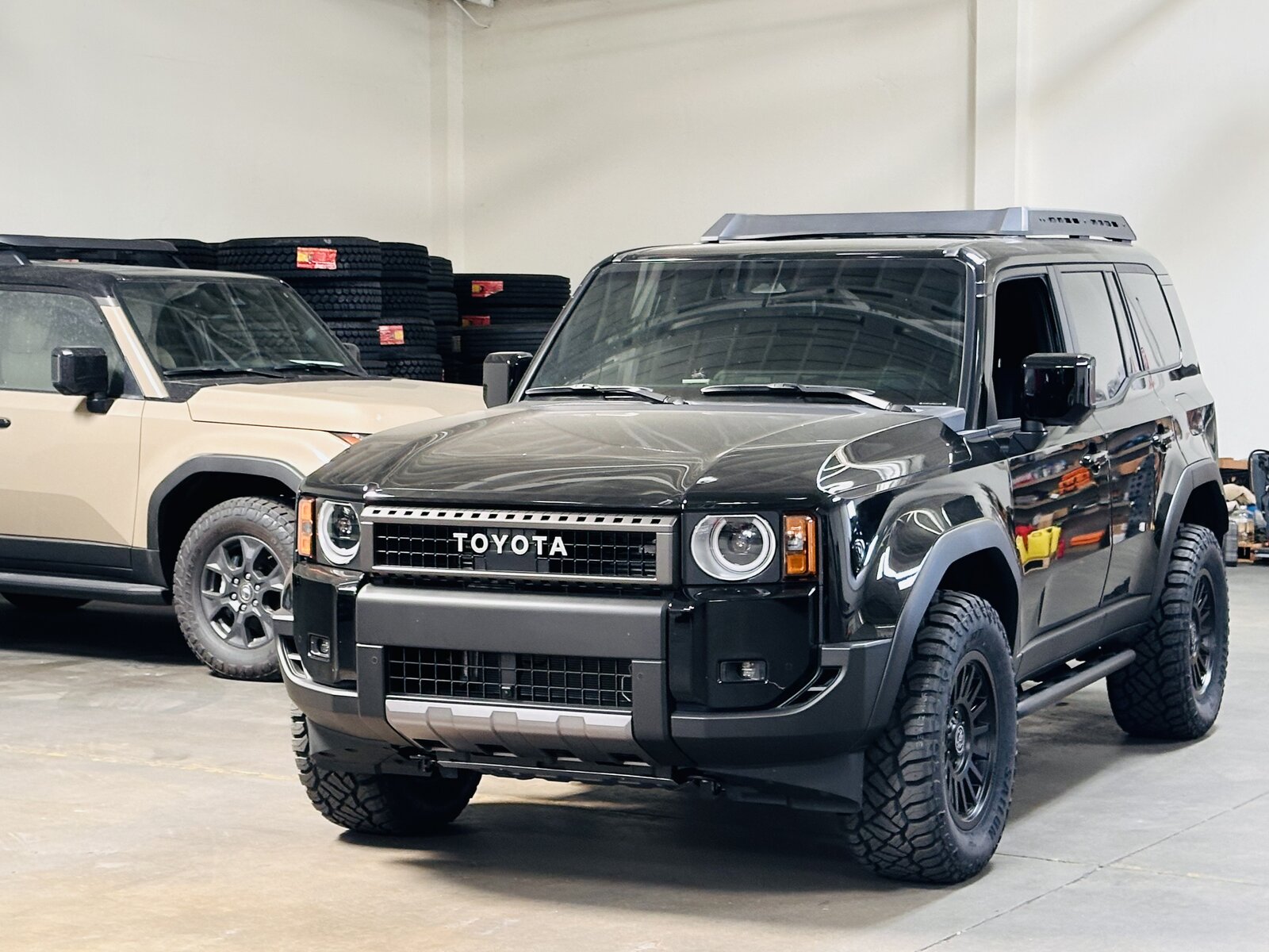

We just got our 1958 last week and have made the wheel/tire switch (on stock suspension). Prinsu Pro roof rack and CBI step rock sliders are on the wayโ€ฆ
Method 703 17โ€ +35 wheels
Falken Wildpeak AT/4 285/70/17 tires

@uraniumrich maybe you can help me with this. Just swapped out my OEM 18's w/Michelins (265/70/18 SL116) for Method 703's with Toyo AT3's in SL (P285/70/17 SL117). According to the door placard on my LC LC (premium) the pressures on the OEM SL Michelins should be 33psi. In reality they were aired up to 36/37 from the dealer. Using the Tire Pressure Calculator the recommended pressure for the AT3's in this case is 28psi. The Toyo's came aired up to 36/37 from the tire shop. I was going to air them down to 33psi to soften the ride. The calculator does have a note that 28psi may be too low. Any thoughts on what pressures I should run?
Since these are SL tires, the inflation pressure is based on the load index. GIven that the difference between 116 & 117 is negligible, I'd probably run 32 psi based on the Load Inflation Tables. The change in tire size would be important if you had gone to an LT, but isn't a factor for SL tires. But, the best way to ensure proper treadwear would be to do a chalk test. Although the online Tire Pressure Calculator is a nice tool, I'm always leery of the black box that just spits out an answer. That's why I stick to using the ETRTO standardized tables used across the industry.
And, how about a pic of the new wheels on your rig? You can't just flex on us that you leveled up and not share a nice shot!
As requested, it's been raining for days so forgive the dirt. I think it's the perfect look for the truck. The amount of sidewall just really looks right. I was tempted to grab a pic of the front with the jack still under it, had that level'd out/lifted look... looked really good. I asked for a million pics of the poke before purchasing, so here's some of the poke too (very minimal). I went with a full size spare as well, no fitment issues. Next up bigger mud flaps, and a chin tuck.
