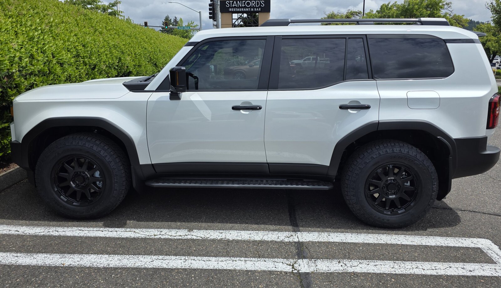

Hi, I posted some pics above of my rig with the new tires and rims on May 22. I have a very loud hum/vibration coming from what I believe is the front. The setup is 285/70-17 with the method 304 rims. I hope Discount Tire can fix it on Monday, if not they have a 30 day guarantee that I may need to take advantage of, I would rather not go that route. I did get their blessing putting them on so hopefully this can be fixed with a simple rebalance.
I have heard that the BFG KO3s are hard to balance, I will keep you updated. I will also, maybe, be looking for a different tire. I will reread the posts to see what people are recommending. Mine is a 1958, stock suspension, with the only mods being the Rhino Rack Recon and the tires/wheels.
