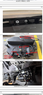

Hi , I have resources to get aftermarket fuel tanks for LC250 / GX550. two size available.
1. 10 gallons tank installing at left center of the vehicle (weight distribution 50:50)
2. 28.5 gallons tank located at the spare tire (I bought 28.5 gallons for my lc , and it’s in transportation)
If anyone would like to know more information about fuel tank, I will keep posting updates.

Thanks Robbie! Have these been tested for these vehicles? I keep hearing about proper tank pressurization for the Hybrids. Also, how does the computer respond?
It is great to see these promising options. Thanks to everyone for investigating them.
In addition to the possible warranty, testing, and software integration issues, it would be helpful to also know any impact to ground clearance. Some larger after market tanks can reduce departure angles or other clearances depending on where they are installed.
