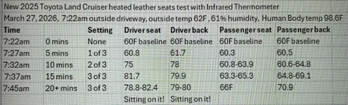

Heated seats not working properly in the new J250 Land Cruisers is a known issue which our dealership and Toyota USA is trying to ignore. 8 trips, weeks in the shop. They say "there is no range and it's within specs." If there's low-med-high there's a range and industry standard on many SUV makes & models is: low ~85-95f, med ~95-105f, high ~105-115f. *** 60.8-77f is not ok. In the shop with thermal imaging the highest is 73-77f. Filed complaints and it will take attorneys to resolve. 2 major issues: hybrid engine lag on uphill take off is safety issue, Toyota Engineering issue even in Sport mode "nothing we can do". Otherwise I like the vehicle and the FJ80 I had all decked out.
