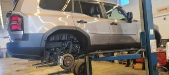

I went the DIY route as I didn’t want to wait. 20min a side. Very easy and no more squeal.

Ordered back in Nov. and just getting the fix in next week. I’ve learned to embrace it as character over the 10 months lol
They fixed my brakes in four month and replaced not only the springs but the struts and pads as well :)
