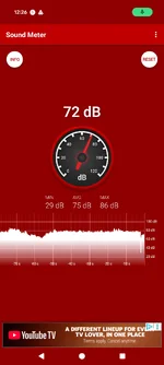

No different observations in terms of hood. Road noise I can't tell with only 2-3 dB less.
Last night did just passenger side fender and now seeing 75db average, down from just over 80 baseline, so it is making a difference. Note that OP used 1/2" in a lot places where I am only using 1/8" dynaliner, so he'll get better results
Planning to do driver's side fender tonight and have an update soon.
Key takeaway: it works.

interestingly, today i opened the app on my normal drive to work where i first tested for a baseline, and for whatever reason, i was back at ~80... :mad: maybe windier out today, IDK... but felt let down by all the $$ and work. guess i need that 1/2" stuff

Did you end up doing the other fender?
yup, driver's side has a LOT more material in it too! weird.
