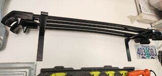

"...I don't have the FE,. I have the LC and the cross bars on the roof definitely cause wind noise. My wife thinks the cross bars make it look cooler so I am dealing with it for now..... LOL..."
I had the exact same comment from my wife - cool cross bars. As much as I hated to admit it the cross bar wind noise at highway speeds is definitely a thing. A sound meter app on my phone showed about 3 or 4db quieter without the bars. It's not a lot, but enough to take the noise level from slightly annoying to reasonably comfortable.
Since they are so easy to take off and put on, my compromise for now is to remove and store if we take a long road trip
