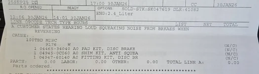

2025 LC owner here and also a victim of the squeal. I purchased mine at the end of September 2025, and the inevitable squeal arrived shortly thereafter. Like others, it was squealing only in reverse and not all of the time. I took it to get repaired on Jan 30, and I was surprised that the dealership had everything in stock and got it done that afternoon. I can definitely tell a difference in the braking, which is a good thing. It feels more consistent. I was pumped! But then....the squealing came BACK on Feb 1!!!! And I swear it's louder than before. It just happened after braking in drive after it had squealed in reverse, which it has never done.
Anyway, we have been dealing with snow and ice here in SW Kentucky - could the squealing now be because of the salt on the roads? :) Maybe?? :) Or did this fix not work? :/ Maybe I need grease? Help.
I have attached the invoice for the work done.
