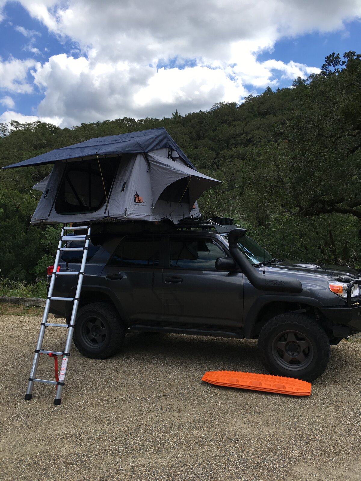

Yes they would, but the machined lip is growing on me. It looks understated which is something I was going for. Like it 's stock factory but with bigger tires. My last 4Runner was a beast and I just am not pounding on the trails like I used to.
