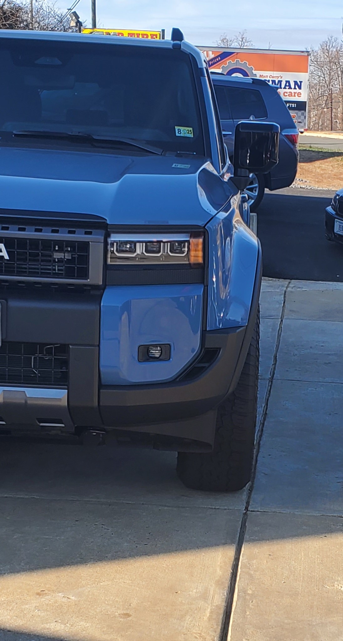

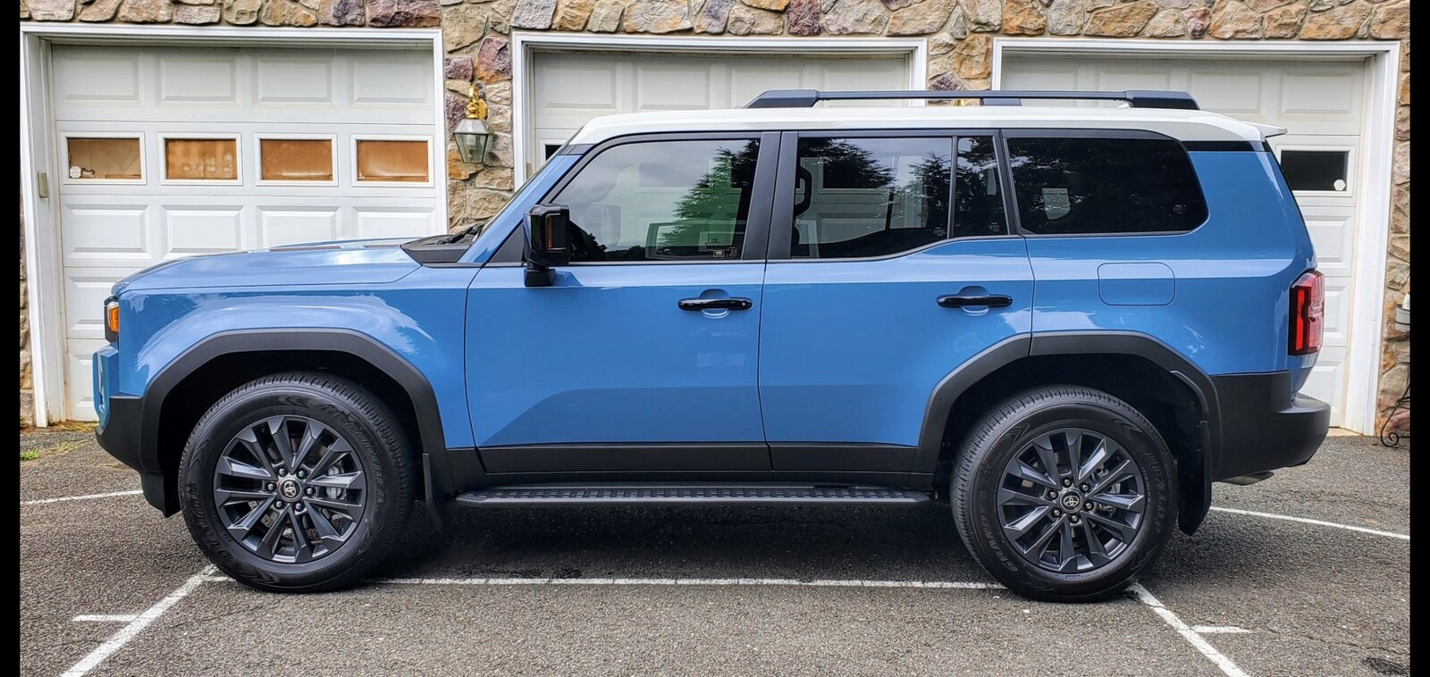

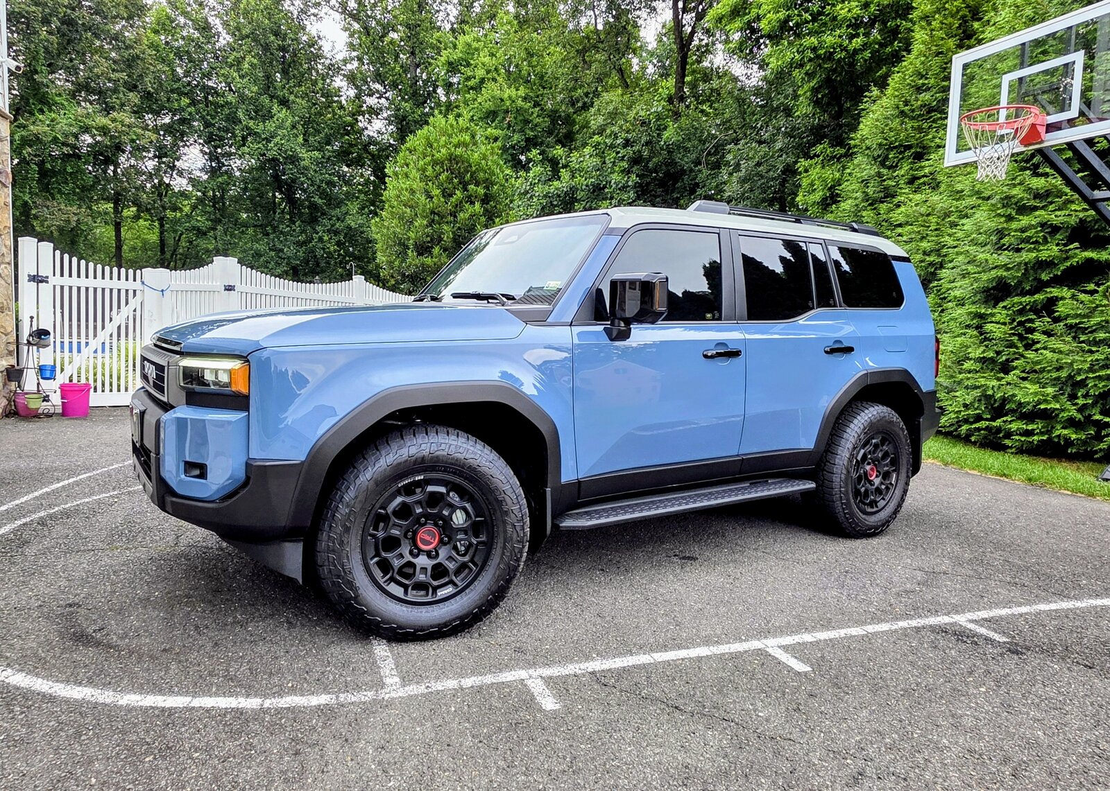

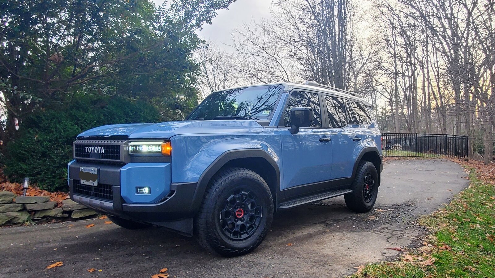

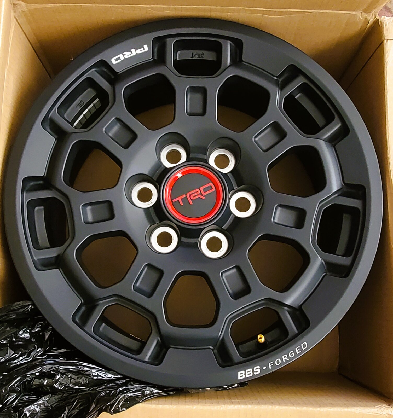

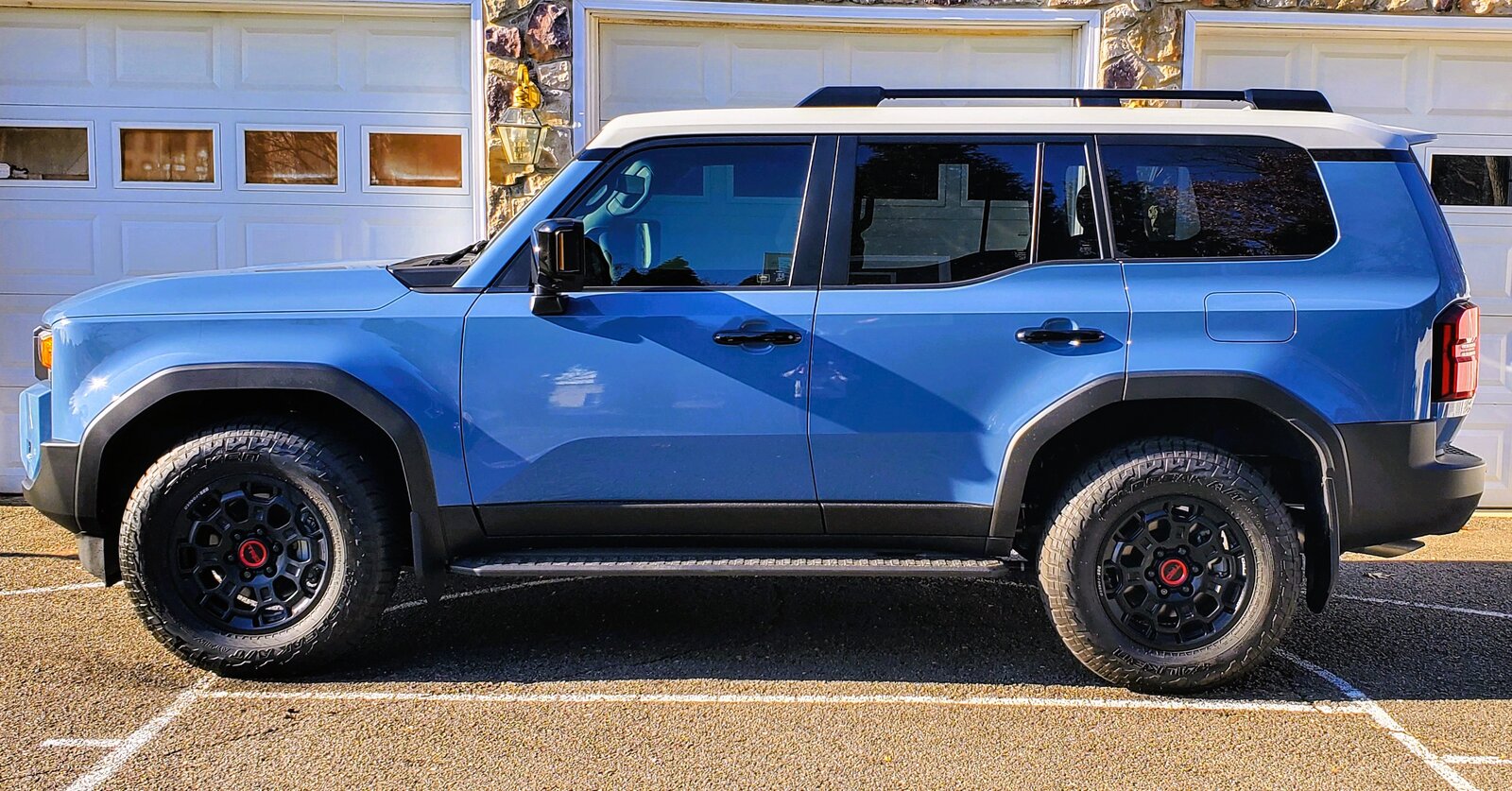

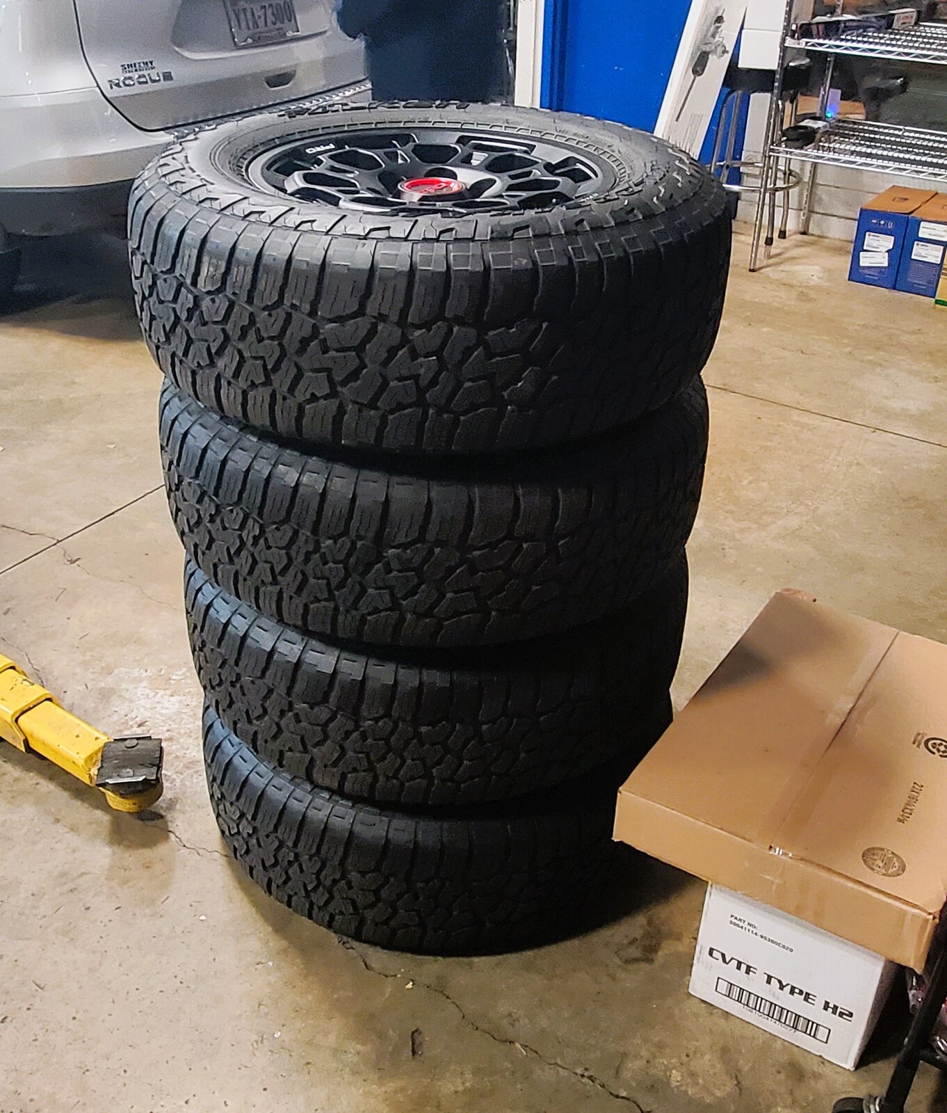

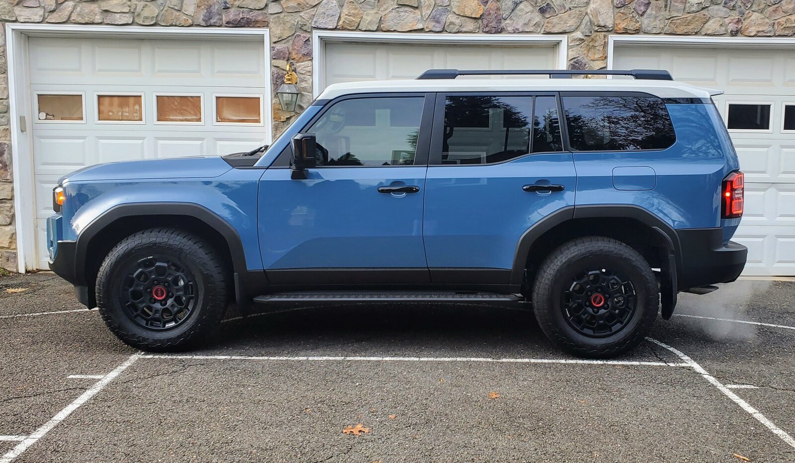

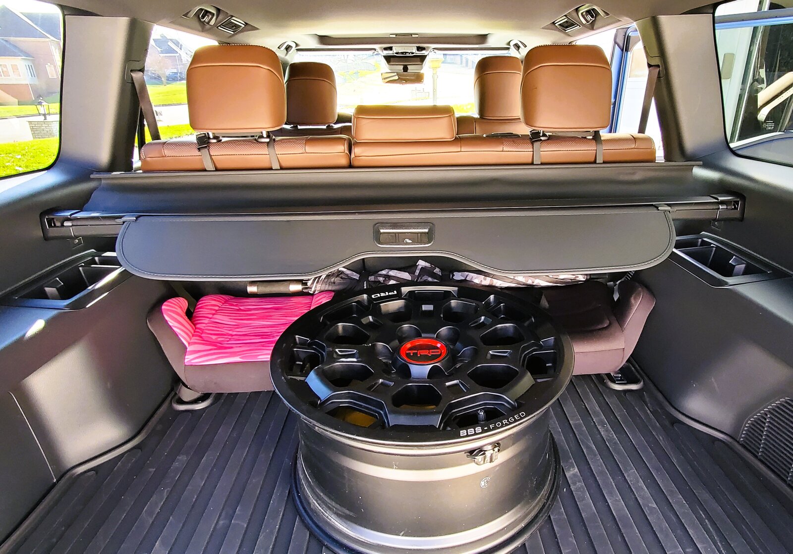

Got the 18" TRD Pro BBS wheels/tires mounted and LOVE IT! Def changed the whole look and much more rugged looking now. Drives just as smooth as the OEM 20s that were on this before. Maybe slightly more road noise than before and MPG impact TBD, but to tell you the truth, don't care. It just looks awesome.
Here are the details, etc.
(5) OEM Toyota TRD PRO 18" BBS Forged wheels on Falken Wildpeak A/T AT3W (285/65r18)
Part #: PT960-34220-2F (18x8.5) (47.5mm)
(20) Genuine OEM Toyota Black Lug Nut Set of LC/Sequoia/Tundra Black Lug Nuts (14mm x 1.5mm)
Part #: PT076-0C200-02
(4) Genuine OEM Toyota Black PVD Alloy Wheel Locks (14mm x 1.5mm)
Part #: PT276-34200-02
*TPMS swapped from OEM wheels
*You can use the OEM lugs. The OEM 20" black chrome lugs use 21mm socket, but the black ones noted above that I am using require a 22mm socket
*The 285/65/18 tire size fits in spare location. No issues
View attachment 22296View attachment 22297View attachment 22298View attachment 22299View attachment 22300View attachment 22301View attachment 22302View attachment 22312

Ref MPGs: OEM 20s was in the 22-23 mpg range, but the current mpg calc in car has it at 19.7mpg. Seems about right maybe 2-3 mpg less. There is def a bit more noise than OEMs, but wouldn't hesitate to do it again. Go for it.

Were the existing valve stems on the BBS wheels compatible with the TPMS swapped from OEM wheels?
@Isrmath: No issues with the BBS wheel valve stems using swapped TPMS :)

Do the BBS wheels have the same offset as stock LC wheels?
Do you think the drop in MPG is due to the Nitto Ridge Grapplers, or the wheels?
No. The BBS are +47.5 and OEM 20s are +60. So 12.5mm diff (~0.5" less positive offset).
I run Falken Wildpeak A/T AT3W (285/65r18), not the Nittos. Didn't have a chance to weigh the OEMs vs BBS, but anything was better than the 20s. fwiw, i checked the computer on the LC and after my daughters weekend of driving around town it was up at 22.3 mpg, so who knows. IMO its a trade-off of better looking rims than the 20s for slightly more road noise. Sort of like getting the FE roof rack (or similar). Functional and looks cool but expect more noise, mpg impact, etc.
