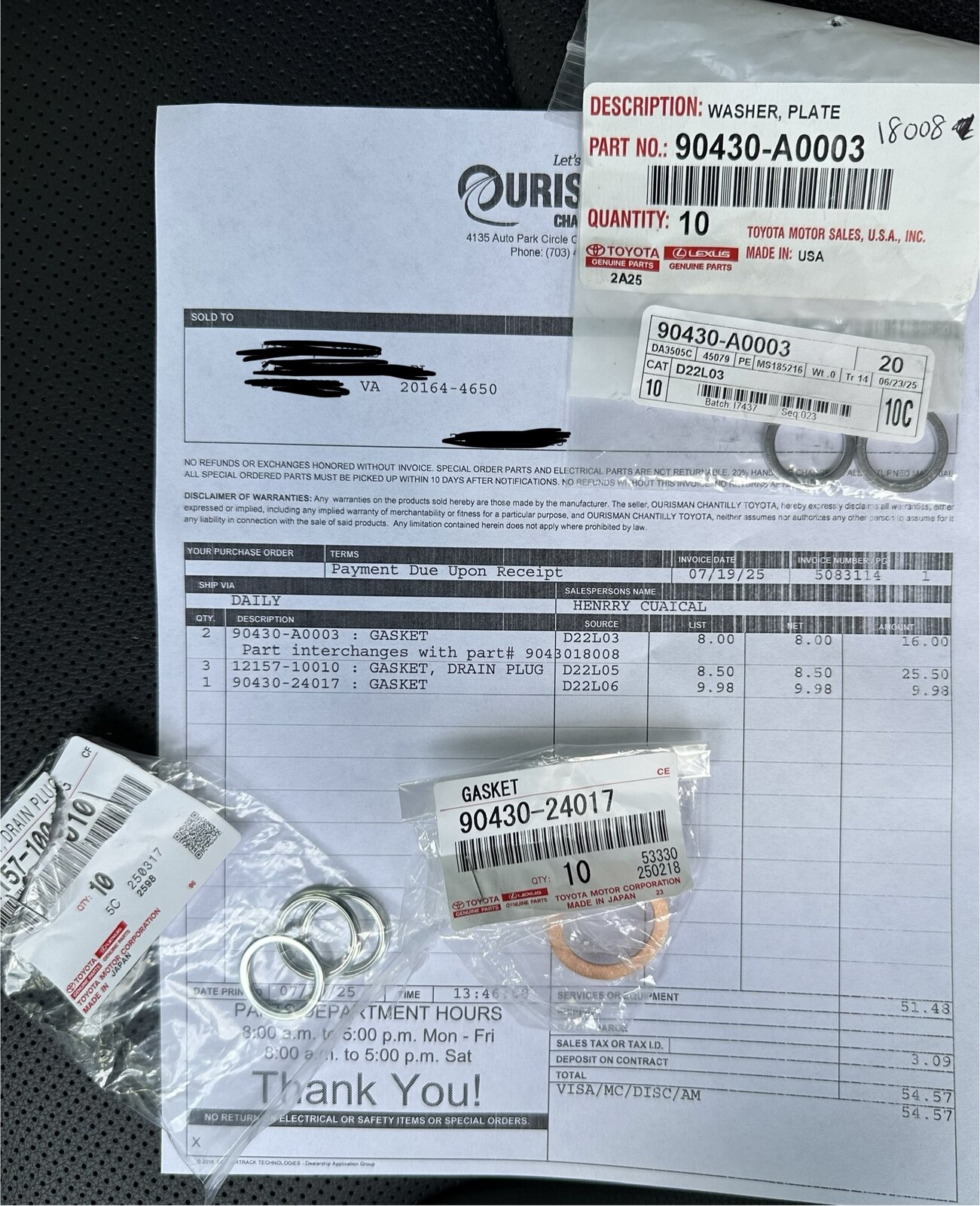

I just bought the washer and gaskets from my local Toyota parts dealer and I was shocked that it cost over $50 for gaskets alone.
I’m not sure how they justified the prices.
I’m sorry but you got robbed.
I think $17 is a little steep.
Edit; I’m sorry I just realized that you got a quantity of 10 each. IDK the quantity on the bag shows 10 but your receipt shows 2,3,1. Dealers probably have a huge mark up.
Yikes, I purchased my gaskets from my usual very overpriced dealer for $10.00 including the tax.
I returned the washers and went to another Toyota dealer that’s about 15 miles from my home (AutoNation Toyota in leesburg Virginia). They sold the same washers for $16.
When I first bought the washers from Ourisman Toyota, I even asked the parts rep if he was selling me 10 quantities for each kind and he assured me that he wasn’t and the prices was correct.
Some dealers are just criminals.
