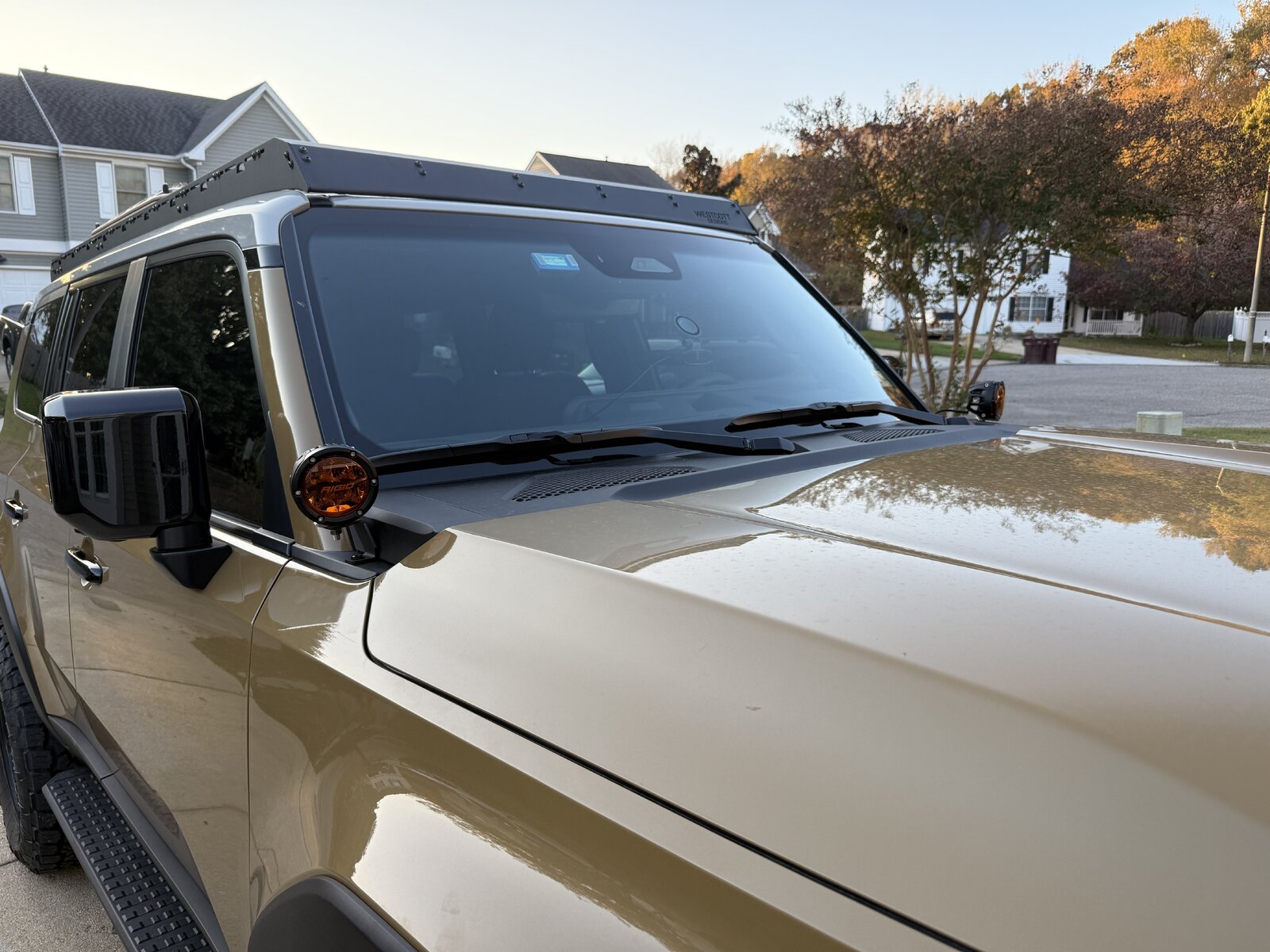

Looks good. What light and brackets? Or better yet, got an install thread? ๐Ÿ˜€
The lights are Rigid 360 4โ€ Amber.
Bracket are for an F150 -$16 on Amazon
2 - M6 1.00 x 40 mm Black stainless bolts
4 - black stainless m6 washers
2 - 1/2โ€ ID 3/4โ€ bronze Flange Bearing
Install took me about 2 hours which included wiring the lights in to my Garmin Switch.
Total cost less the lights was about $30.
They are very sturdy. If you ever want to take them off and install Nashfabs solution or something the brackets can come off and just screw the bolt back in with the black washer and youโ€™ll never know it was there.

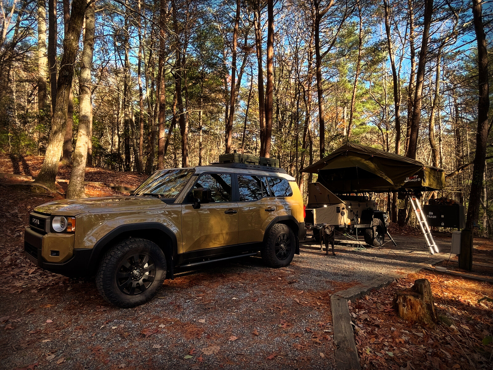

Very nice! Would you mind sharing more photos of the overlanding gear and camp setup?
Happy too! The trailer is a Turtleback Getaway, I post some images of the setup
-22 gallon water tank
-2 marine grade batteries (5-7 days off grid power)
-Solar panel inputs
-King size mattress in rooftop tent
-instant hot water heater
-33โ€ offraod tires
-dual independent suspension, no cross axle
