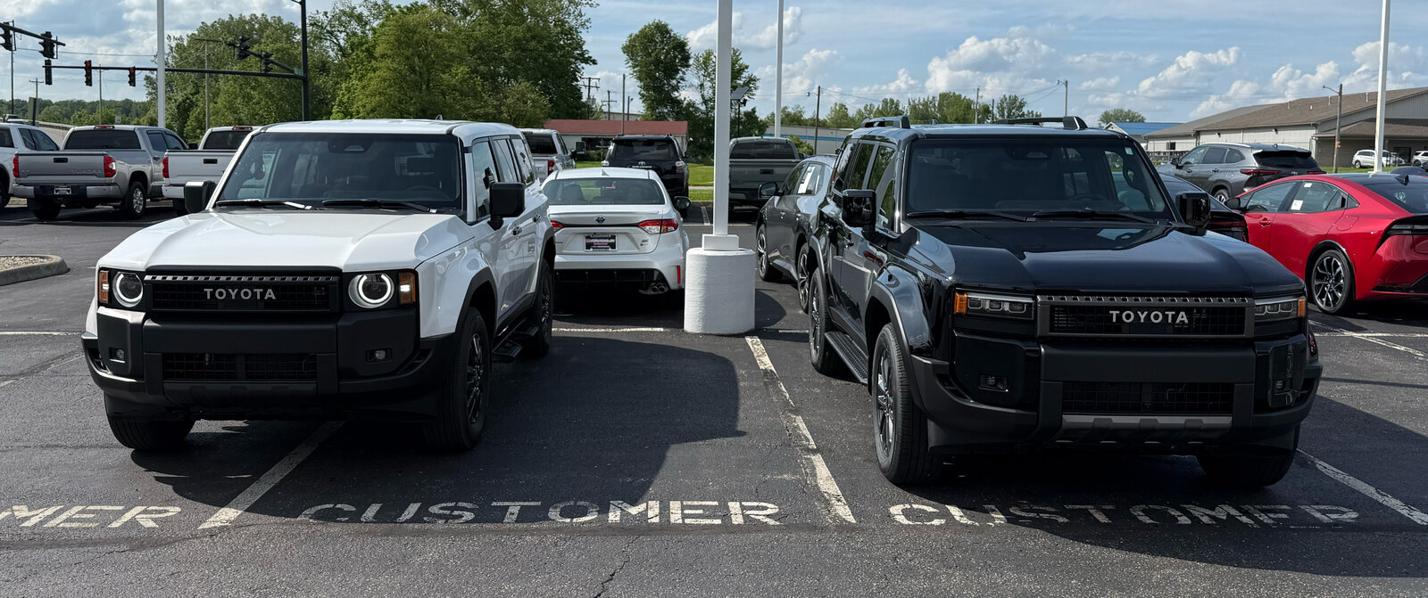

This saga has a happy ending!
I brought the truck in to check the oil, as requested. The drain plug was clean, the oil looked new. They had no issue providing me a sample as requested. They felt it looked good, and offered a credit for future service - but I expressed I still had concerns for longevity. The service manager asked what I felt would solve the issue, and I brought up the idea of trading my truck for another.
The GM was on board, no convincing or arguments needed. They offered the full amount I paid for the old truck without asking, and they were happy to find a truck elsewhere or work with me on the black premium they had on the lot. I wasn't excited about black, but the brown interior won me over. They offered the same amount off on the premium that I got on the 1958 without me even asking, and offered a hugely discounted 10yr/100k extended warranty.
As I specifically told the GM - mistakes happen, but how those mistakes are fixed is what actually shows what an organization is made of. It means a lot more to say the dealership made a mistake and then made things right. I felt these guys were 100% honest the entire time, never any attempt to deny responsibility, and never any pressure for me to just deal with it. It's a smaller-town dealer, and they said specifically they want to be sure customers are happy, tell their friends, and keep coming back. I absolutely believe it - and I will definitely give them another shot whenever I need dealer service. I suspect they have implemented some procedural changes to ensure mistakes like my oil incident don't happen again.
Side note: The 1958 was the cooler of the two, and I will miss it. I loved the round headlights and cloth interior. So cozy and timeless. The LCLC Premium though is a nicer truck, and I'll probably be happier with it in the long run. I love the brown interior, and the stereo sounds excellent by comparison. The camera seems nice too - I was fine without the 360 on the 1958 because of the great visibility, but the backup camera was pretty bad. Unfortunately my new truck does lack the SBD, and it does have 20 inch wheels. I'm not super excited about the wheels, but it does feel like it handles a little sharper. Overall, very happy with the outcome of this entire story.
What a great dealer! And the black with tan very nice. Congratulations on making out of this mess.
Thanks! First car in a looong time with an interior than wasn't black or grey. It almost tempted me to upgrade in the first place.
