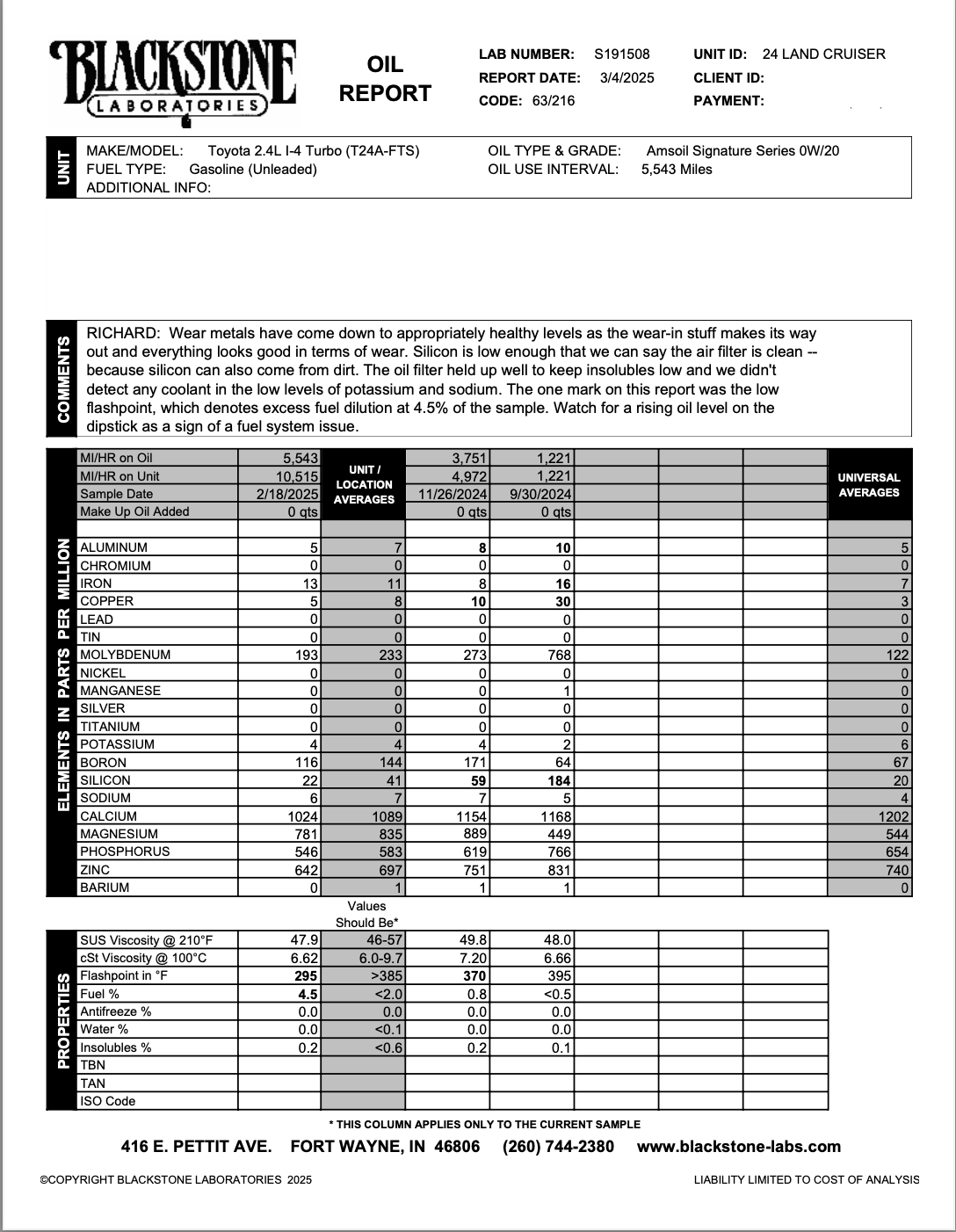

I'm wondering if anyone else has noticed a significant amount of fuel dilution in their oil analysis? This is my third oil change (with analysis with each change). While the change interval was a little longer than I'd like (5,543 miles), I was surprised to see what seems like a significant amount of fuel in the oil. As a result, the flashpoint of my oil was down significantly. Beyond stating the obvious - fuel is the enemy of our oil - can anyone shed some light on potential causes?
Just a little background on this oil change. The change was completed after a 6 hour road trip in very cold weather. We finished the road trip on a Monday night, the engine sat overnight, and then I changed the oil the next day (in other words, the engine was cold.) The temperature in my garage was kept in the 40-50 degree range. I had to choose between changing the oil a little early (about 4,500 miles) or a little late (5,500 miles). Given that I'm using high quality oil (Amsoil Signature Series), I wasn't overly concerned about the extended change interval.
Any thoughts on this?
Here is a summary of your oil analysis report from Blackstone Laboratories:
Overall Condition:​
  • The wear metals have come down to normal levels, indicating that the engine is breaking in well.
  • No coolant contamination detected (low levels of potassium and sodium).
  • Air filter is working properly (low silicon levels).
  • Insolubles remain low, showing the oil filter is functioning correctly.
Potential Concern:​
  • Fuel dilution: The flashpoint is low (295°F), indicating 4.5% fuel dilution. This suggests excess fuel in the oil, which could be due to a fuel system issue. Keep an eye on oil levels and dipstick appearance.
Key Metal Wear Readings (PPM):​
  • Iron (13): Within normal limits, indicating typical wear.
  • Aluminum (7): Normal, no excessive wear.
  • Copper (5): Well within limits.
  • Lead (0): No concerning bearing wear.
  • Molybdenum (193): Additive from oil, normal level.
  • Silicon (22): No contamination from dirt.
  • Calcium (1024), Magnesium (781), Zinc (642): Healthy additive package.
Oil Properties:​
  • Viscosity (6.62 cSt @ 100°C): Slightly lower than the expected range, likely due to fuel dilution.
  • Flashpoint (295°F): Low, indicating fuel contamination.
  • Water & Coolant: 0.0% (no contamination).
  • Insolubles (0.2%): Low, confirming clean operation.
Conclusion & Recommendation:​
  • The engine is in good shape, and wear levels are normal.
  • Fuel dilution is the only concern (4.5%)—this may indicate a fuel system issue (leaking injector, excessive idling, or rich fuel mixture).
  • Keep an eye on oil levels and check for fuel odor on the dipstick.
  • If fuel dilution increases in future tests, further investigation may be needed.

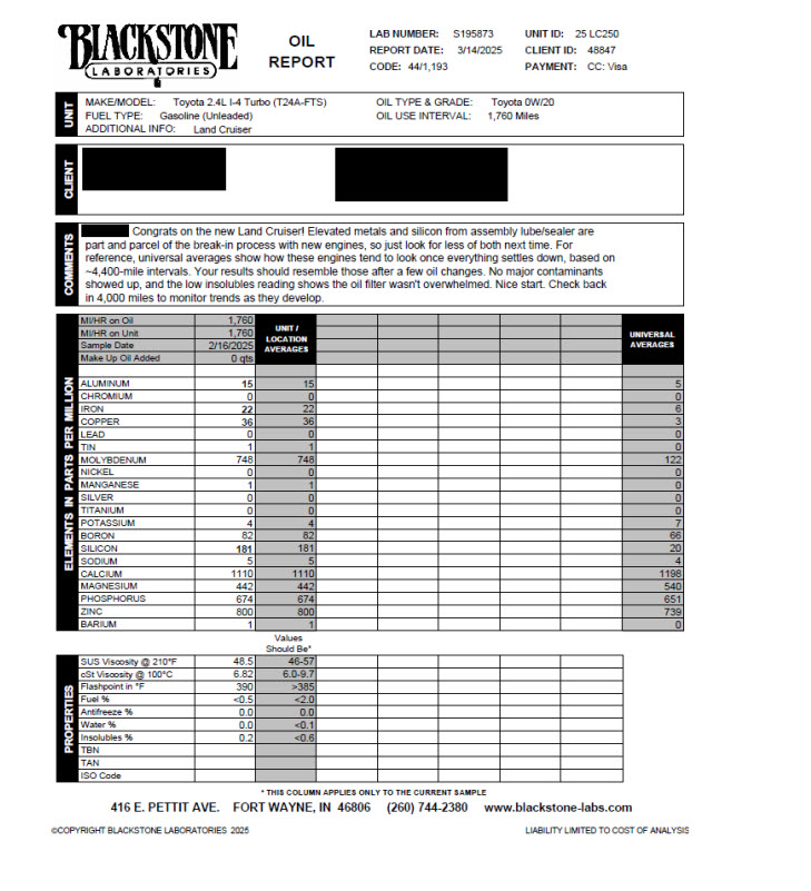

No Fuel dilution in my report, albeit only 1,760 miles on the oil.
Mixed driving, but it never sees not getting up to operating temperature. All trips are at least 10 miles at 40 MPH just to get into town with the first mile being 25-30 MPH.
