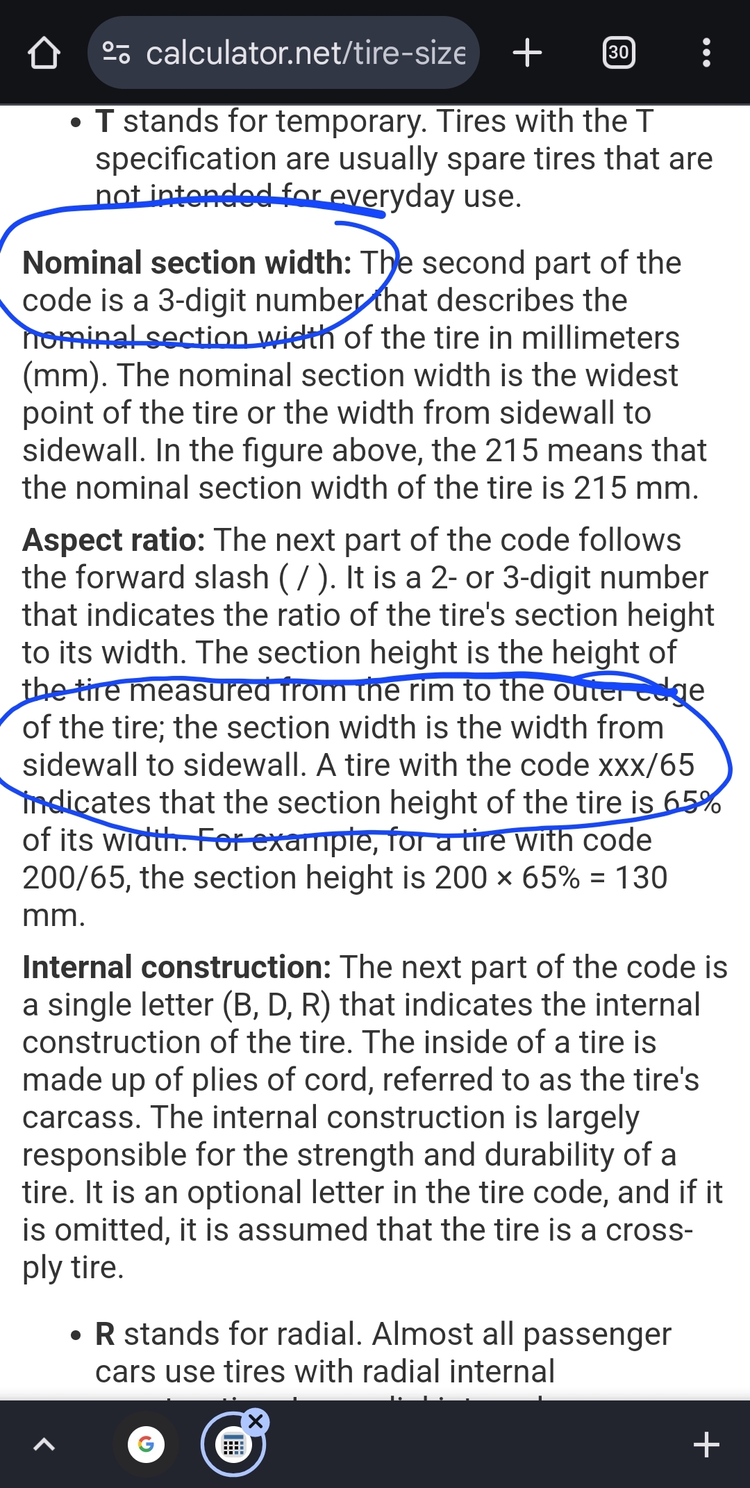

I think you think you are schooling us here but 285 is a width measurement only.
...he is schooling yall.
It just takes a simple google search to confirm. Yes, aspect ratio is a percentage, but some don't know where to apply that ratio percentage toward.
There isn't a random floating constant that you apply the ratio toward and you magically get 33.7"

You're missing the point entirely. Yes, I get it, different diameters will change the speedo.
But, the width has an impact on the diameter. It's in the freaking calculations lol
But your probably like my friend and went either the medical or law route, because math doesn't seem to jive with you ✌️
Is a 265/70R18 the same height as a 285/70R18? No. The width has a direct relationship to the height. Therefore, changing the width does change the speedo.
So what if I use a 285/65r18 ? How much is the width changing the speedo in this scenario?

Okay, lets do the math. Lets assume a 70 aspect ratio is a constant.
A 265/70R18 is 32.6 inches tall.
A 285/70R18 is 33.7 inches tall.
They both have a 70% aspect ratio.
The only number to change is the width.
The 285 is 3.38% taller than a 265.
Now back to original purpose of this thread.
If the speedo reads 70mph on 265s and the GPS says your speed is 67.5mph, that is a 3.70% error. Now switch to 285s and the speedo reads 70 mph, the vehicle is 69.8 mph.
You can go to tiresize.com and check my math. It is pretty close I am sure.
