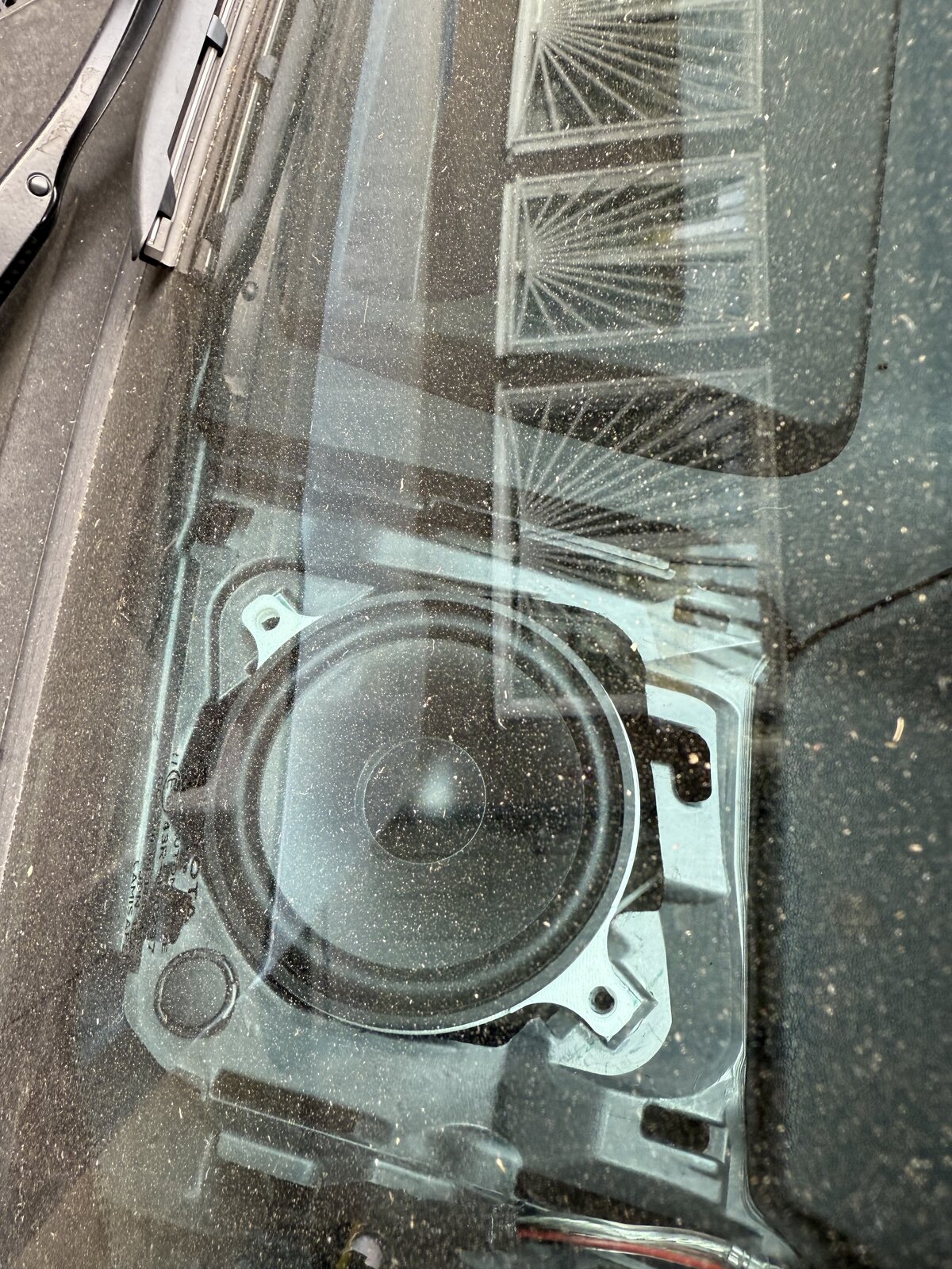

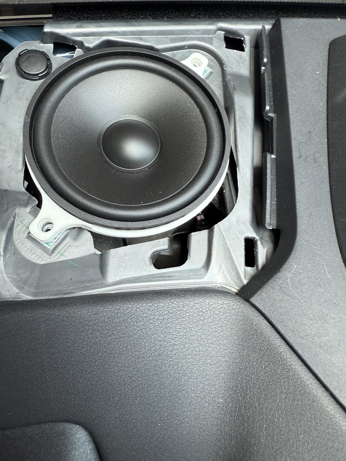

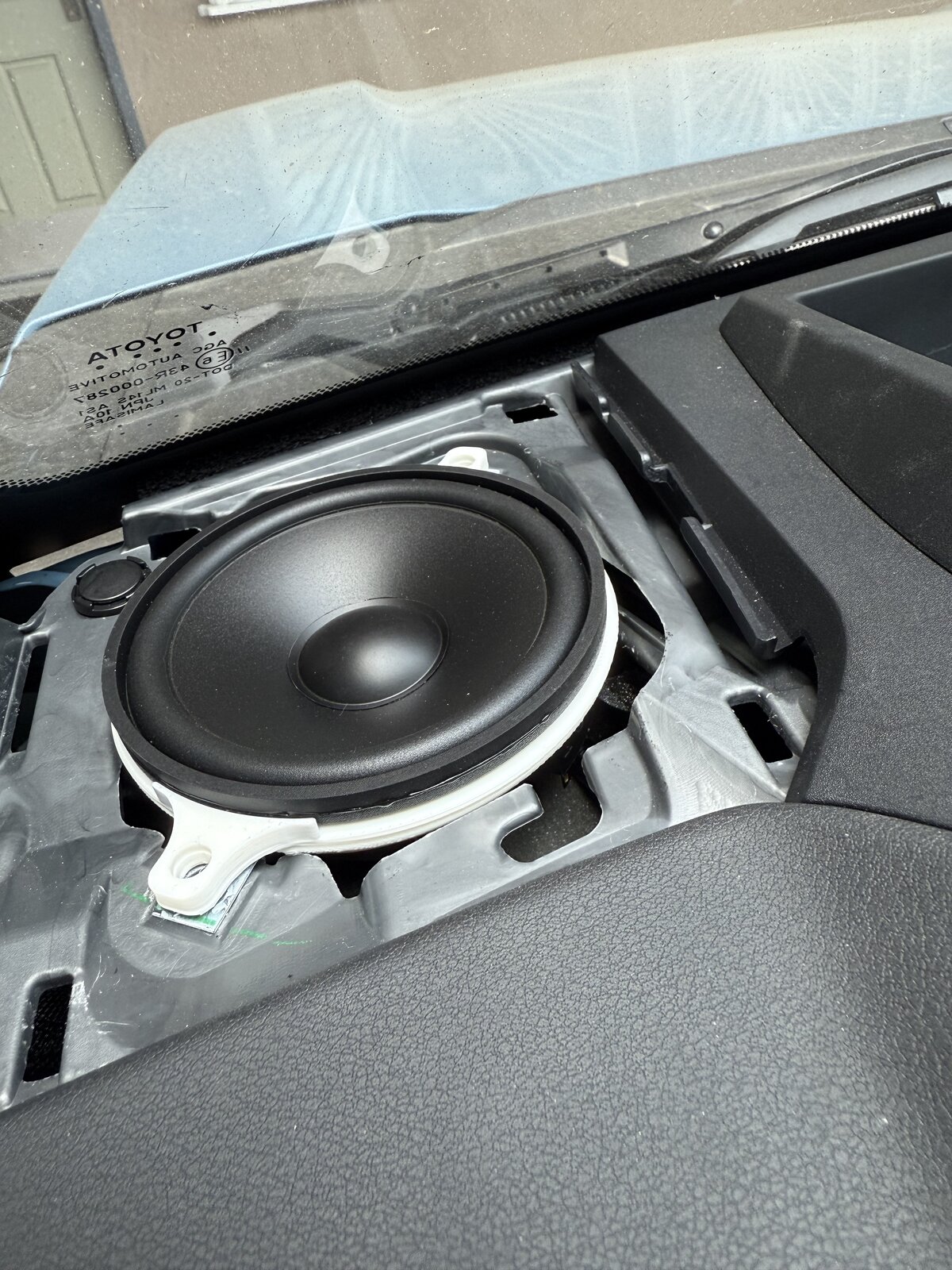

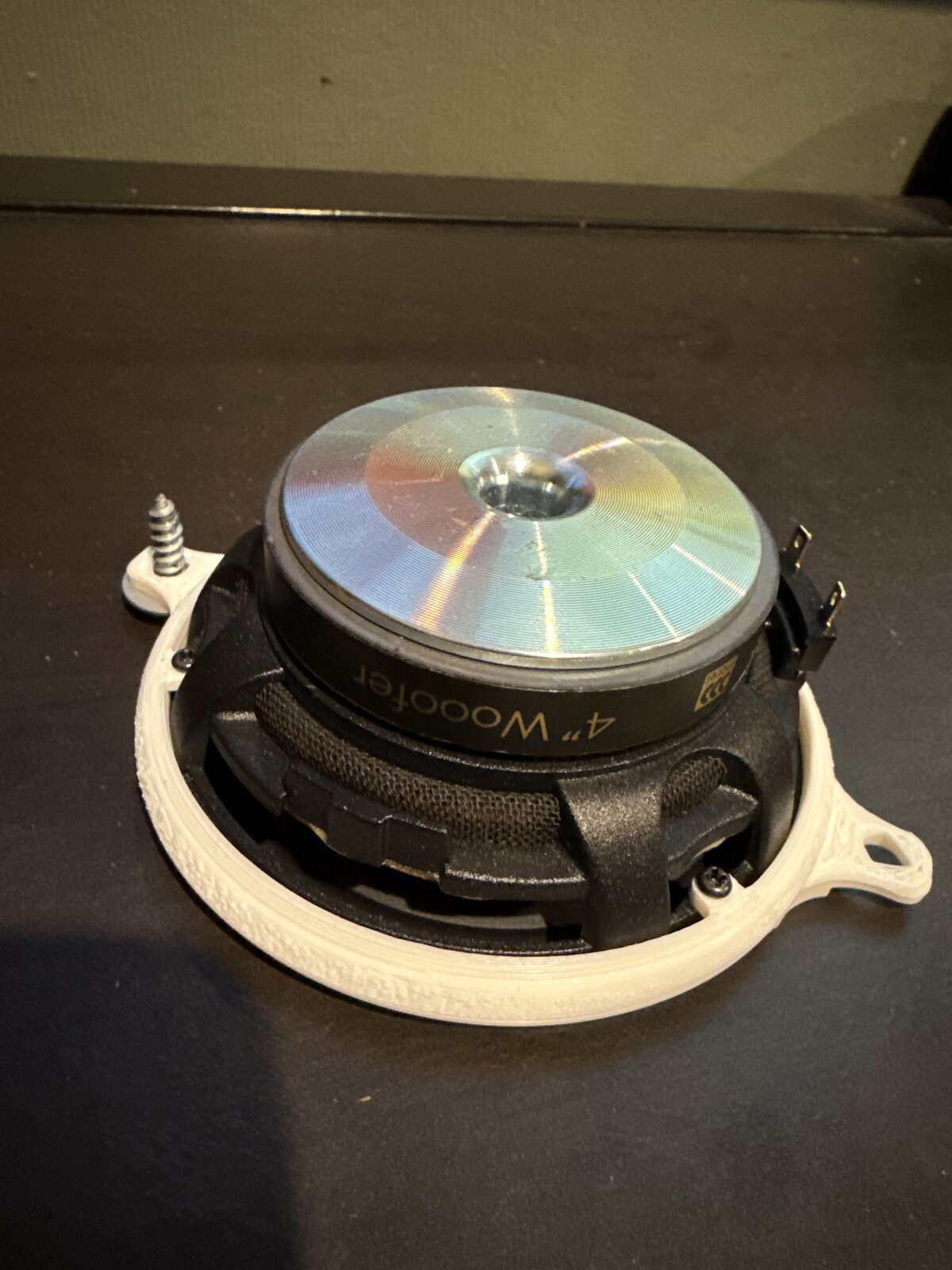

I was able to make these for the front left and right midrange speakers. They're designed for 3-inch speakers. Let me know if anyone's interested—I can make more. I haven’t tried them on the center yet; it should be the same, I think, but I won't know for sure until I try it.

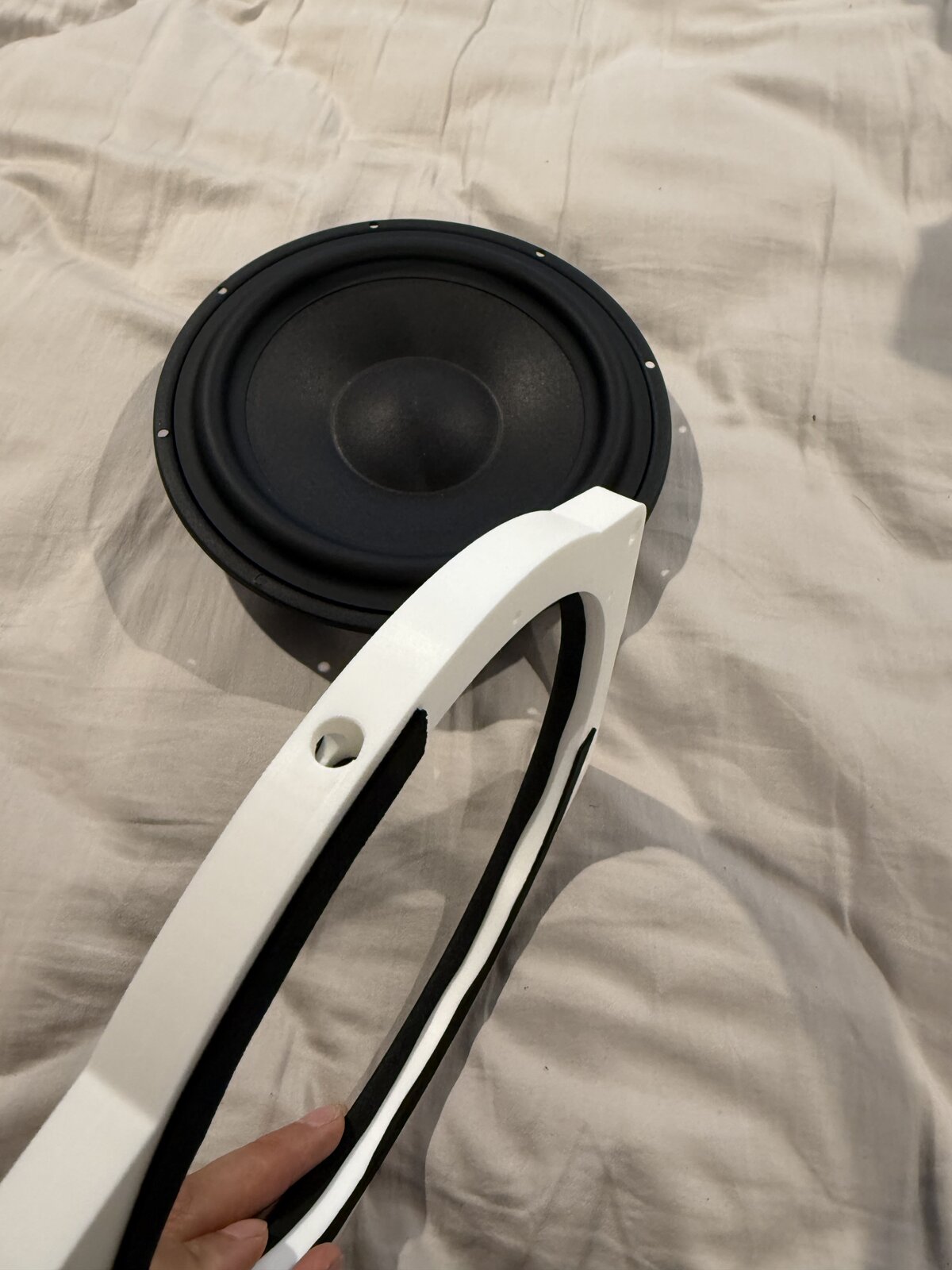

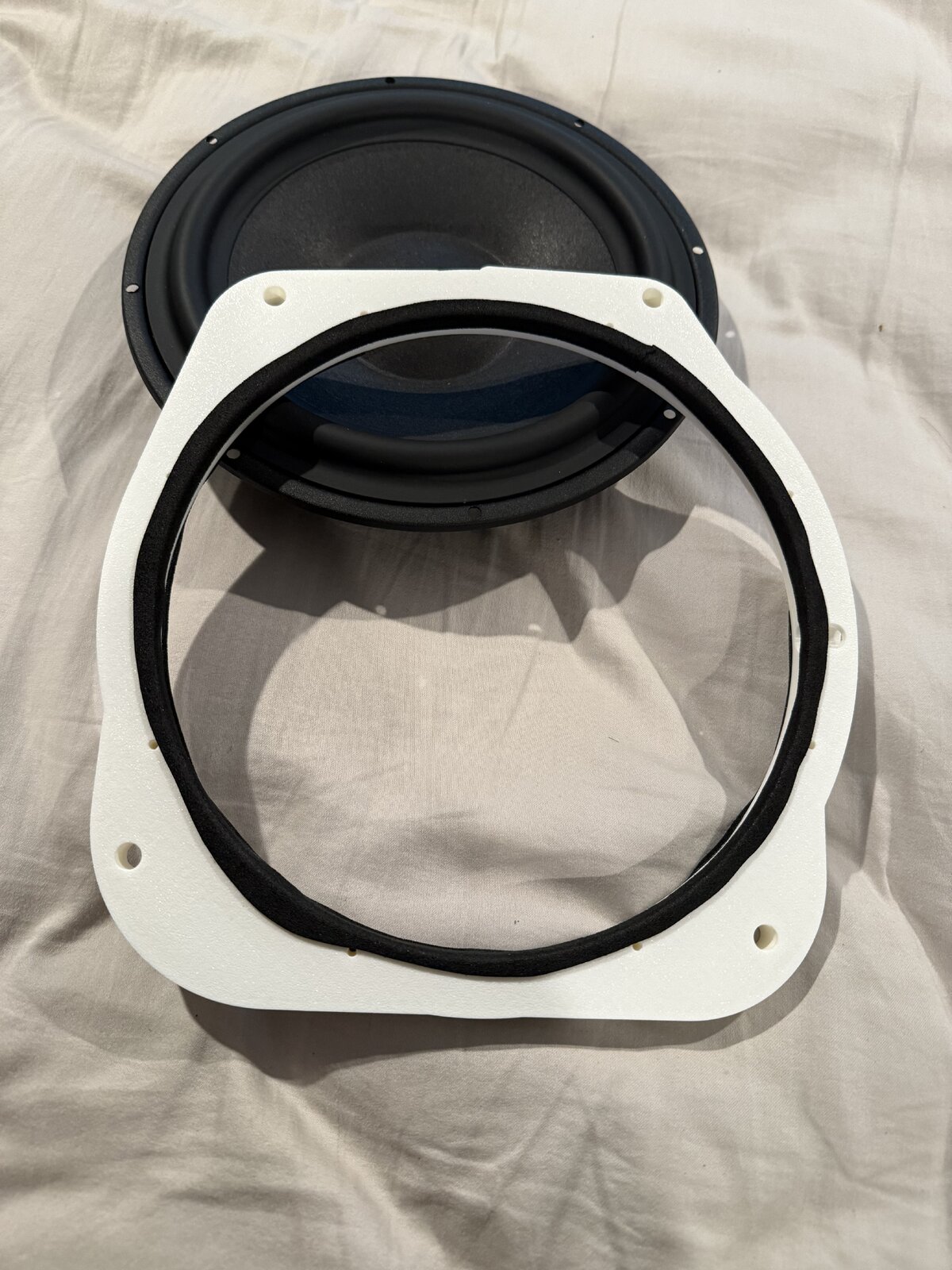

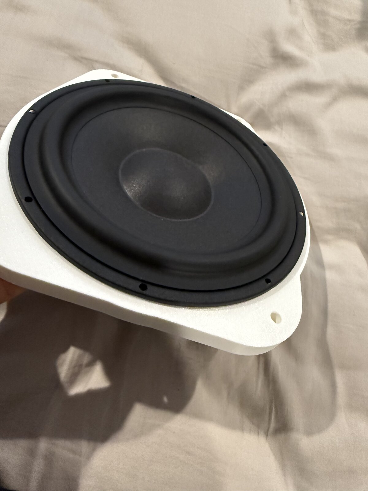

Rear hatch sub bracket, custom made for the Morel MSW 265 8-inch. This one took a lot of time—measuring and testing—but I finally got it dialed in. Morel uses a different mounting pattern, but I can reposition the holes to fit other subs if needed. I think I could even craft one for a 10-inch by increasing the bracket thickness, though removing the hatch panel is definitely a pain.

Nice work! If you happen to test out the one for the center channel keep us posted.
This 3D printing is on my “like to learn” one day list. Used to do a lot of CAD drawing back in the day and now kicking myself for not sticking with it and learning 3D printing.
Also, what is your thoughts on the Hertz pro 3 inch midrange?

I was looking for something like this for the rear hatch sub. If you can point me to where you can actually purchase a Morel MSW 265 then I'll get the bracket from you. It's backordered/not available everywhere
