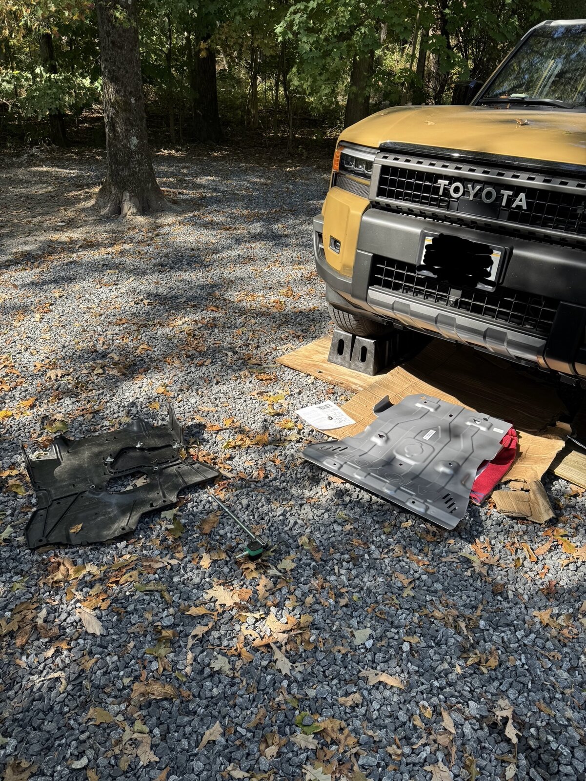

Just installed my skid plates. If you reuse the existing bolts you probably don't need the bolts it comes with, really the only critical pieces would be the threaded clips to attach the plastic trim. Install was pretty easy, didn't need to use a jack or anything to hold up the plates, the keyhole slots worked great. Most difficult part was installing the bracket at the front, and that's just because it's not super clear how it goes.

Extremely easy install with the PDF instructions shared in this thread. Feels like these simple things like changing the oil and swapping these skid plates come across much more difficult than they actually are. At least to a complete amateur like me.
Changing the oil will also be much easier now since only the front plate has to come off and it's literally removing 4 bolts and loosening 2.
Installed the full skid plate (front and transmission) today along with the premium horn (ordered off eBay). The premium horn uses the same connectors so it’s literally just changing the horn heads - easiest mod ever. The skid plates went on with no hiccups thanks to all the info and pictures posted here. Thanks everyone who posted in this thread.

Took one decent hit on my first trip offroad, there is a pic of the skid plate afterwards in the trip report thread. The front skid ended up flexing upward and contacting some metal on the frame above it, but no real damage, I'm happy with how it performed.
On the middle crossmember where the front of the transmission skid bolts down, there was a black metal piece on the drivers side that seemed maybe in the way. I unbolted the 2 forward bolts of this piece then just placed the transmission skid over it then rebolted the skid plate through everything. The front skid then overlaps over this area, and it worked out. (Some had mentioned installing the front skid first, then sliding the transmission skid under it..)
I wasn’t sure if I should’ve removed this metal piece, as it seems like if I removed it, there were 2 hooks in the transmission skid that could’ve threaded through some of the holes in the frame crossmember to hold it up. With the plate in place, the hooks were too low to thread anywhere. But, I left the piece as it covers some wires and such on the drivers side.
