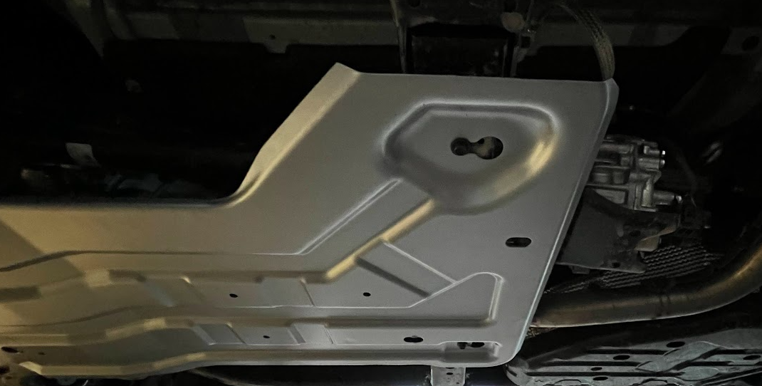

This is where the transmission skid ends:

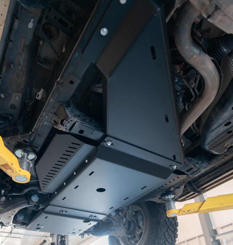

RCI transfer case skid plate:

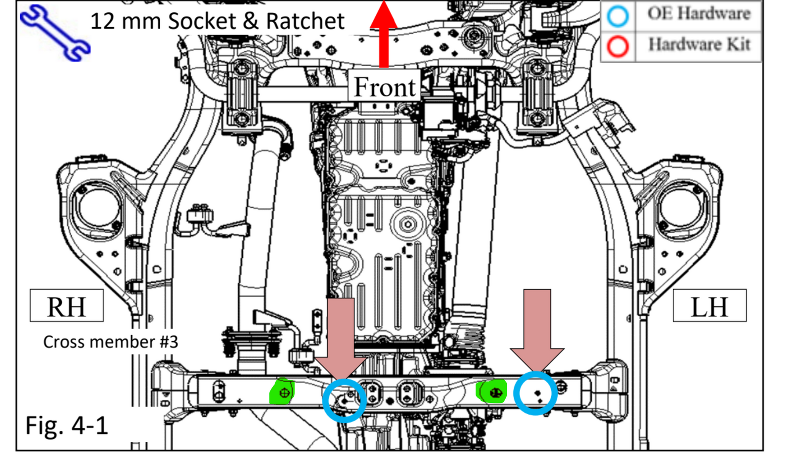

Green highlights show where RCI transfer skid bolts up. So the blue OE Hardware bolt would have to go through the RCI transfer skid on RH side:

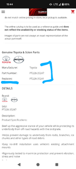

Possible updated transmission plate?
PT228-35247 replaces PT228-35241?
Typo?
*247 shows as skid plate for LC, Taco and 4runner
Originally purchased *247 thinking it was the rear diff plate (3 part numbers came up when Toyota Service searched for skid plates, the other two were *241 and *60242)
Typo?
I can’t find anything on it in TIS. The install doc hasn’t been updated.
