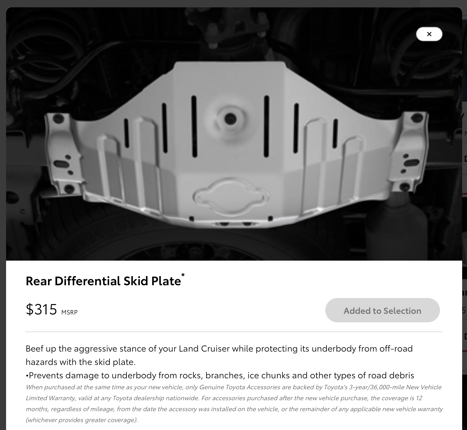

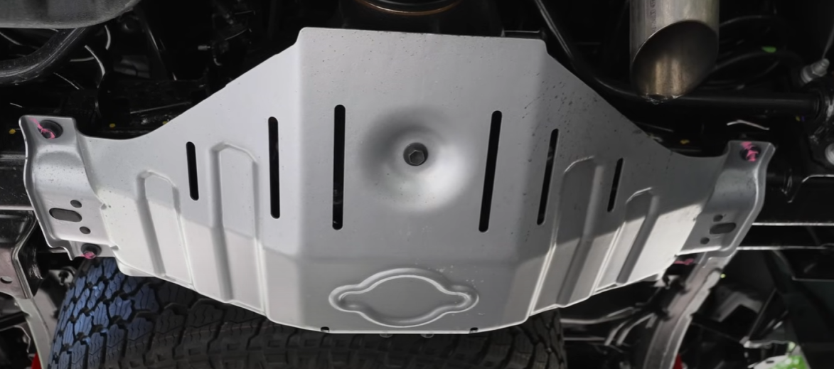

I got the skid it seems like there must be another bracket to get the center section to attach to the diff. Other than that it looks like it will mount to the diff.
Turbo8, are you saying that this part number rear diff skid plate will work with the LC250 as you received the kit...or do we need some other type of bracket to make it work? Thanks in advance.
Re: Rear Diff Skidplate, my local parts department said not in system, probably initially reserved for port installs until some future time. Didn't know if same as Tacoma, but I'd guess that black piece in center is different for the LC (since it didn't fit for @turbo8).

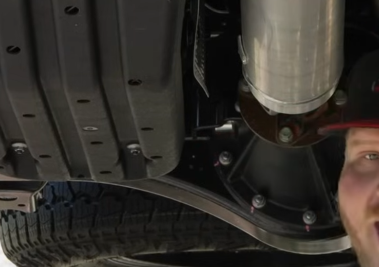

Yeah, no go until I figure out if there is another bracket or the trail hunter has a different axle housing\third member. I can't imagine there is a different housing. Truck king youtube channel compared a pro to a trail hunter and I didn't see any mounting points on the pro.

Just wondering if anyone has found the correct pn for the rear diff skid plate?

Yeah, no go until I figure out if there is another bracket or the trail hunter has a different axle housing\third member. I can't imagine there is a different housing. Truck king youtube channel compared a pro to a trail hunter and I didn't see any mounting points on the pro. View attachment 14291
I found this part number: PT228-35242
The listing (at least where I checked it) shows identical details to PT228-35245. Anyone know if that could be it, or are there two different versions for Tacoma?
Edit: never mind, found an eBay listing that says, "DOES NOT FIT THE NEW 2024 -2025 LAND CRUISER HYBRID."
An update on the rear diff skid plate, both BAM Wholesale and Beach Toyota told me the Land Cruiser rear diff skid isn't in the system yet.
From the videos I've watched on the FE, I believe it has "Toyota" written/engraved on the skid plate. I haven't noticed that on any other model; so I am assuming it is a variant of the other models.
I could be completely wrong on this as well.
