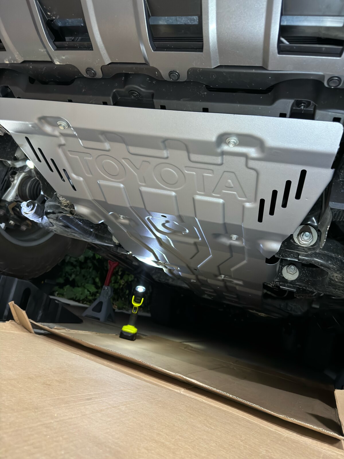

Skid plate install last night was pretty straight forward. I highly highly highly recommend printing out the TIS skid plate installation document. The little paper you get with the front skid is useless. With the actual installation instructions, it was pretty straight forward as long as you patiently go step by step through the doc. It also provides torque specs.
It was also a wonderful time to do a break-in oil change at the same time. So a fun night working on the cruiser with a buddy and some beers!

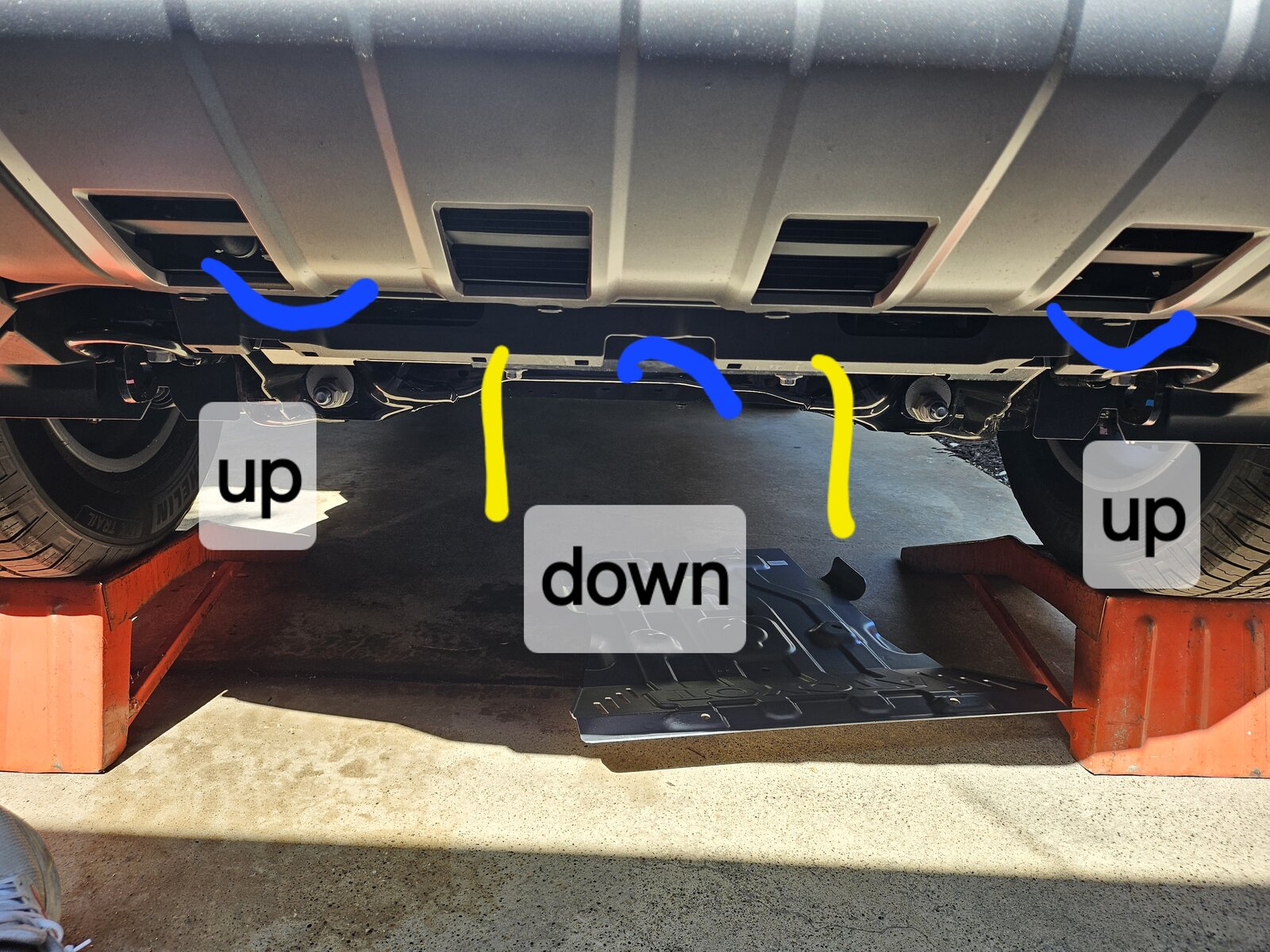

Ok seen all the pics but nothing that showed me how to get there. So took apart and restarted. Here are the steps

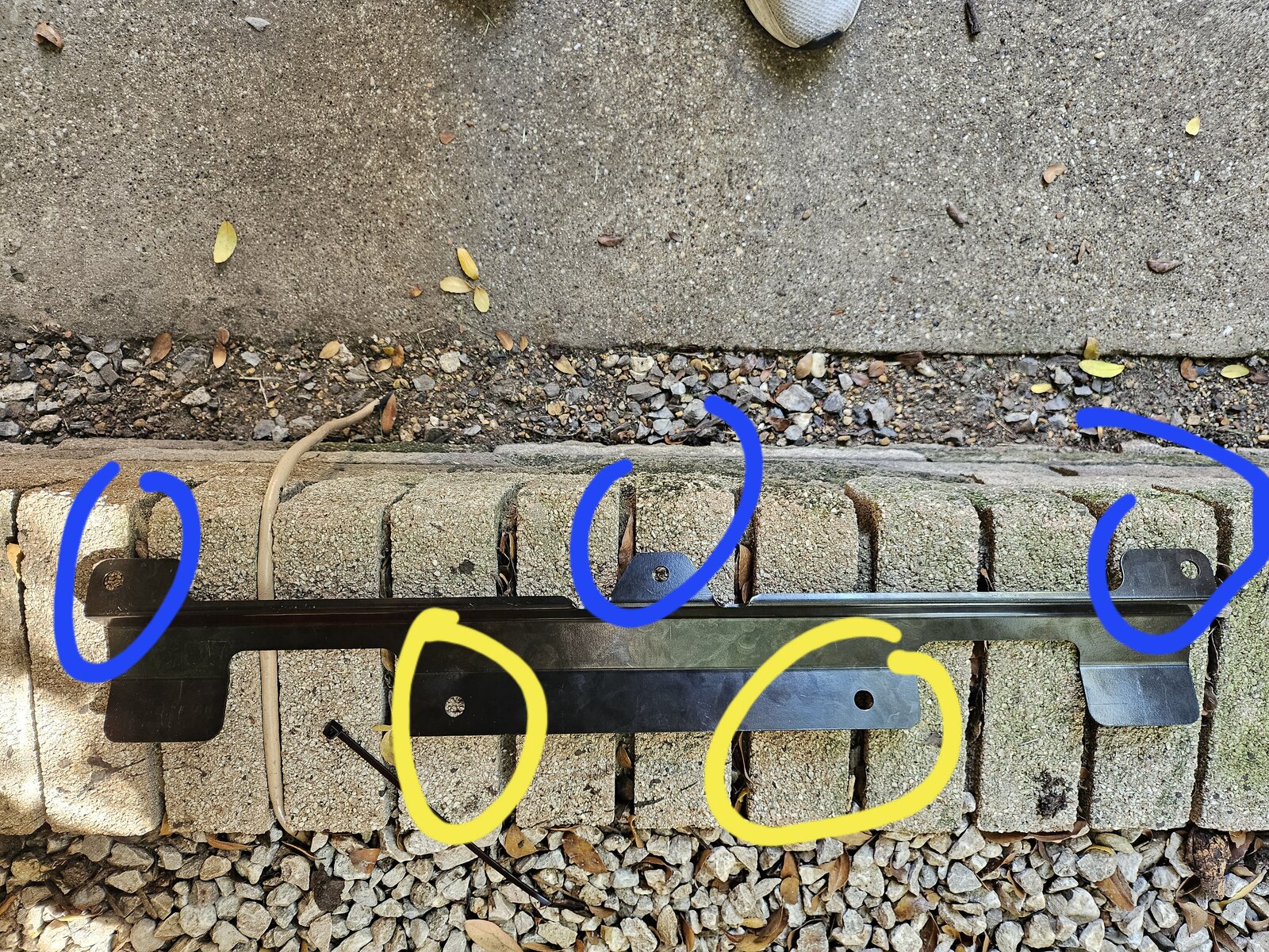

This is the metal piece that comes with new skid plate. The 3 holes in blue you will use to attach your existing plastic cover to.

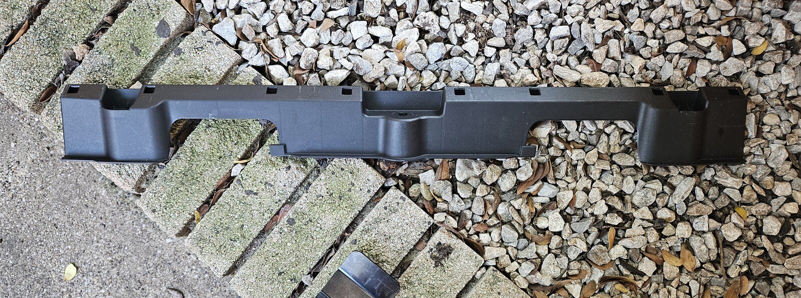

This is the plastic cover that is on your car already. You will need to take it off and re-use it.
Drop the plastic cover piece on the metal bracket so the 2 big side cut outs are facing up and the holes align with the 3 holes in blue. The 2 holes in yellow are going to be where you bolt the metal piece to the lc.

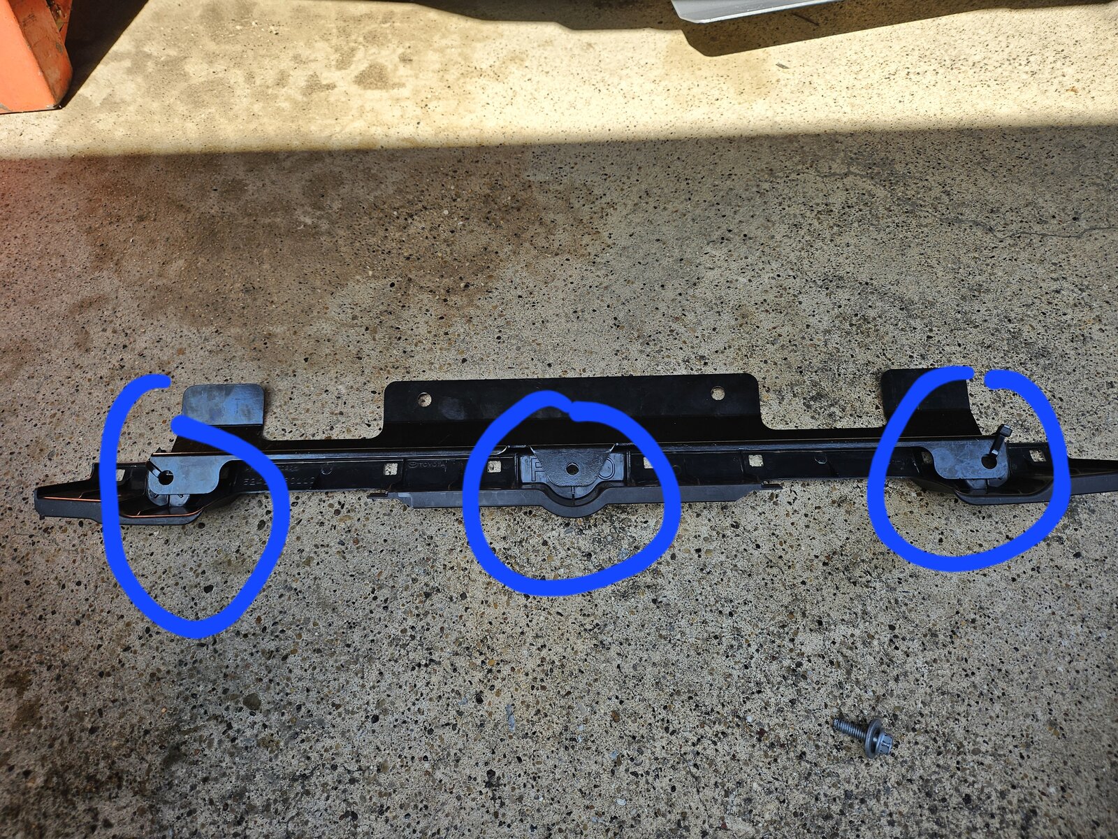

Take 2 of the extra bolts from when you removed the orginal skid plate and use them to attach the metal piece to the frame (where the yellow lines are represents where the bolt holes are on the frame)
Once installed your plastic trim pieces should have a large side cut out on each side facing up (there is a small cut out on each side that will face down- not marked in pic) and the center cut out facing down- marked in blue.
Now your black metal piece and trim are done. Install skid plate (so much easier) and all set.

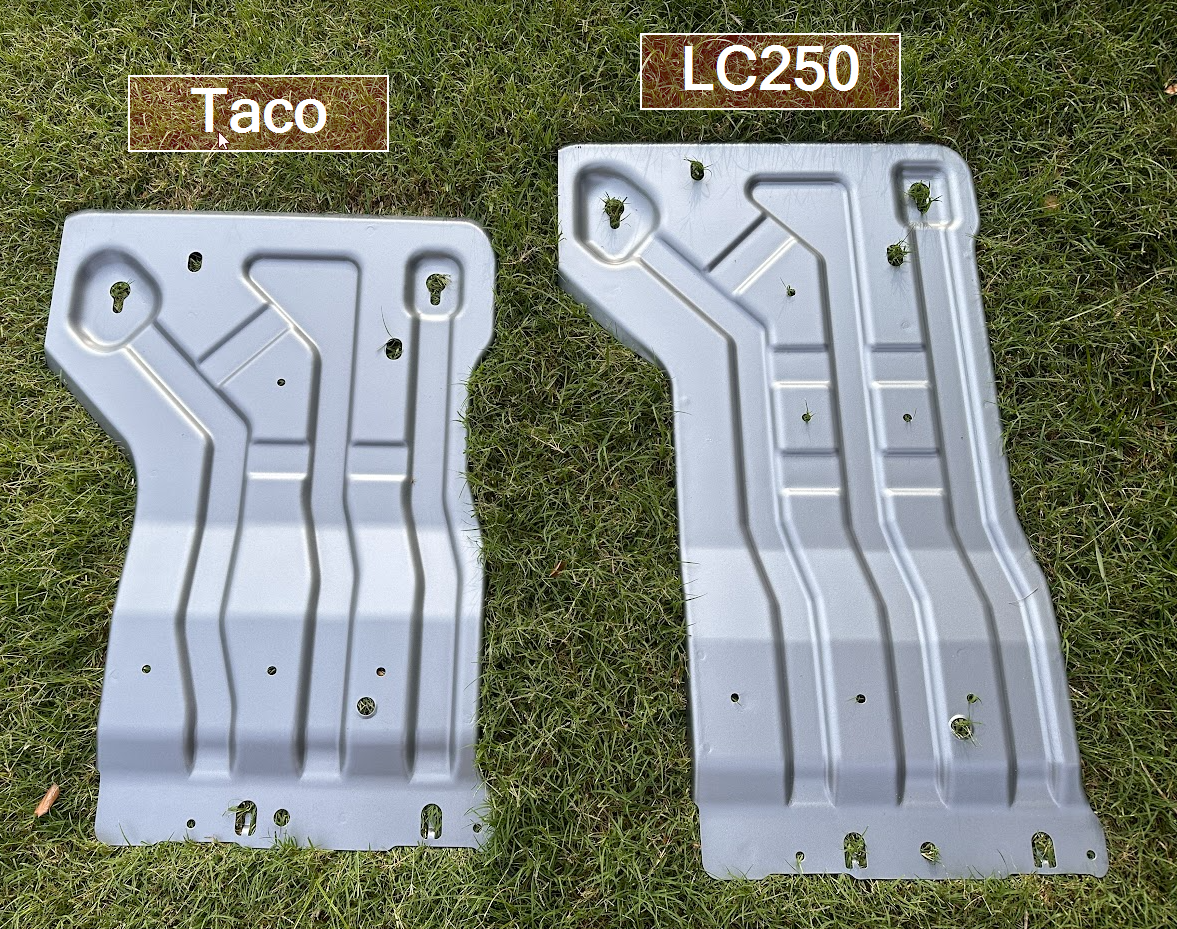

Accidentally ordered the PT228-35244 part number. Haven’t installed it yet though. Anyone confirm this is the exact same part as PT228-35241?
It's different (shorter). See this post (PT228-35244 on the left, PT228-35241 on the right):
Here are the 2 skid plates side by side so you can see the differences and why it could be easy to confuse them if you were looking at the picture alone.

This is the wrong transfer skid. Need the one that ends in 41, not 44. 41 is shorter and fits the Taco only.
