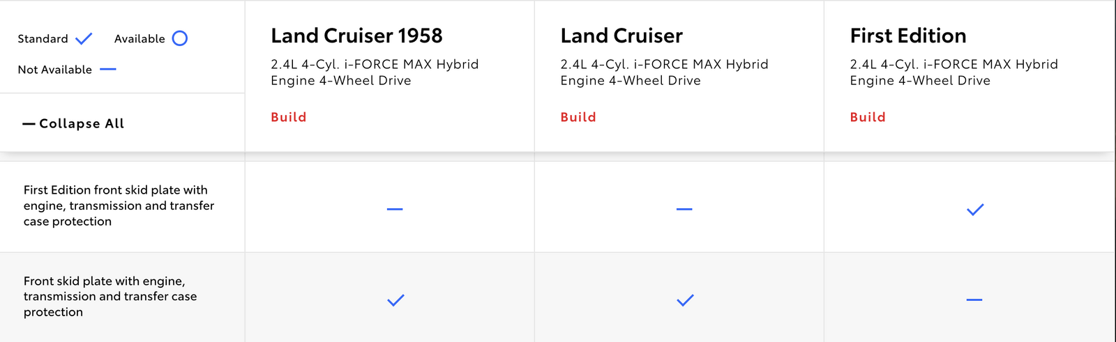

All trim levels have an engine/transmission skid plate, the FE just has an "upgraded" skid plate, which others have mentioned has unique Toyota branding.View attachment 1669

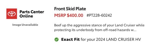

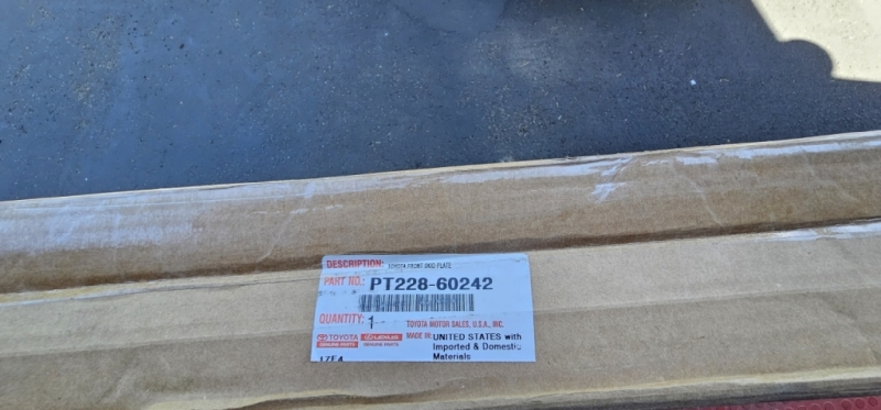

FYI....I own the Land Cruiser edition and I ordered and received this Toyota branded front skid plate. On the Toyota accessories website for owners it asked me for the VIN number then listed out the parts and accessories that were available for my vehicle. It was $330 after dealer discount. This skid plate is 2.64mm vs the stock skid plate which is 1.7mm. Hopefully it fits. If anyone has the part number for the matching transfer case skid plate please share I think it is PT228-35244 but not totally sure. Thank you.

Part Number​
Part Name​
PT228-60242​
Lndc Frskp​
PT228-35241​
Taco Lndc Skpl Under​
These part numbers worked for me on a 2024 LC Trim. Engine plate + transmission plate from Ed Martin Toyota in Indiana.

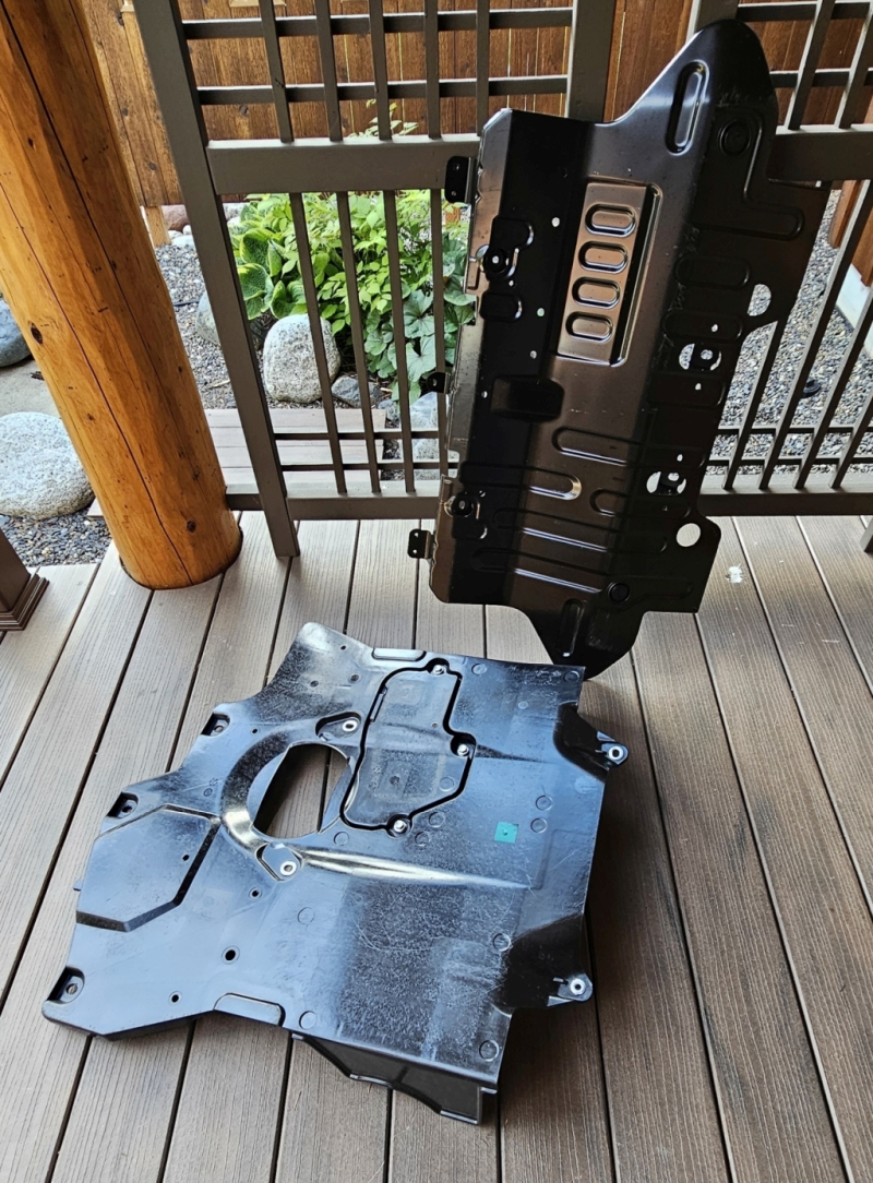

I swapped out the skid that came with my LC LC with Premium for the same skid that is in the FE. As you can see the front one is thin metal the back one is plastic, looks like ABS, but that is just a guess. The part number is for the same skid that is on the FE.
View attachment 3317View attachment 3318
How long it take you to swap out the skid plates? Any tips you can offer?
Factoring in that I just laid on the floor and crawled under, no lift or jack. I would say three hours or so including the learning curve. I know this is obvious; however, be sure to put the rear one on first. As opposed to me putting the front one on. Also, I eventually needed a helper for the front one, that's after it fell off and gave me a split fat lip. There is a bracket that covers the sway bar disconnect mechanism, that needs to come off for the rear skid to sit properly. Hopefully this will help.
