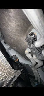

its not this one.. passenger side towards the front side above the fuel tank you will see it above the shield and its orange not red colorHere's what mine looks like. 25 LC. Looks okay, i guess.View attachment 78442
yep that is the source of this exact recall.. it looks like not a part defect issue but rather a design/location issue of this exact kind of clips.. looks like zip tie is the way to go until toyota makes a protective cover or replace the whole connector with a new designThese fuel line issues have been documented in the forum for some time. It’s clearly an issue, so I’ll take a peak to make sure the clip looks fine, but otherwise I’ll keep driving until the remedy is available.

This was very helpful thank you! I’m going on a off roading trip next weekend and was feeling a bit nervous. Confirmed my clip is still on.If anyone is curious where the clamp is located, it’s above the fuel tank at the front edge, passenger side. I had to use a flashlight and hold my phone up there to get a view, but some of you young flexible folks might be able to see it without a digital aid.
