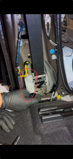

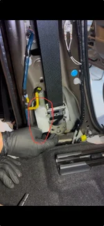

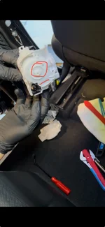

I finally found the source. At first, I thought it was the glass rattling in the door, the door striker, or an issue with the seals. It is the driver's seatbelt pulley mechanism. It’s located at the base of the B pillar, right behind the driver's seatbelt pulley mechanism base. I localized it by taking off the lower B pillar plastic cover, and my wife drove the LC while I sat in the back seat over washboard dirt roads. It rattled away more than ever. I have videos but cannot upload the video and audio on this site. Perhaps file size? I’ve attached pictures and circled the culprit in red. I’m sure the dealer will attempt to replace it with the same garbage part. For now, I insulated the inside of the B pillar plastic cover with sound-deadening foam until a proper TSB comes out. They will likely have to replace the entire driver's side seatbelt mechanism. I haven’t had time to take it in for them to confirm and develop a solution.
I noticed that on mine too, wrapped in sound deadening material and put everything back together and the sound was still there. So for me, that didn't solve the issue, but was another issue all together.
