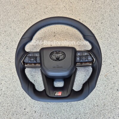

Tested paddles and the cable, the resistances are to spec.
What else could I be missing?
Does the spiral cable just have pins that aren't connected to anything?
Mine came equipped with the paddle shifters. I didn't see any options to enable/disable paddle shift when I connected Carista.
I can't speak for Toyota specific software to say whether they have to be coded for the vehicle or enabled (but it is a possibility). Your local dealer may know.
I'm new to the Toyota world, but I've owned and modified many cars and 4x4s, and with every model from the last 20 years, whenever I've added a new gadget or replaced a part needed for the electronics to function, even OEM parts, I've had to register it with the car's ECU. I would try that first, then double-check all the connections, and finally verify that the hardware has all the necessary connections with the software. Good luck, and let us know how it goes.
