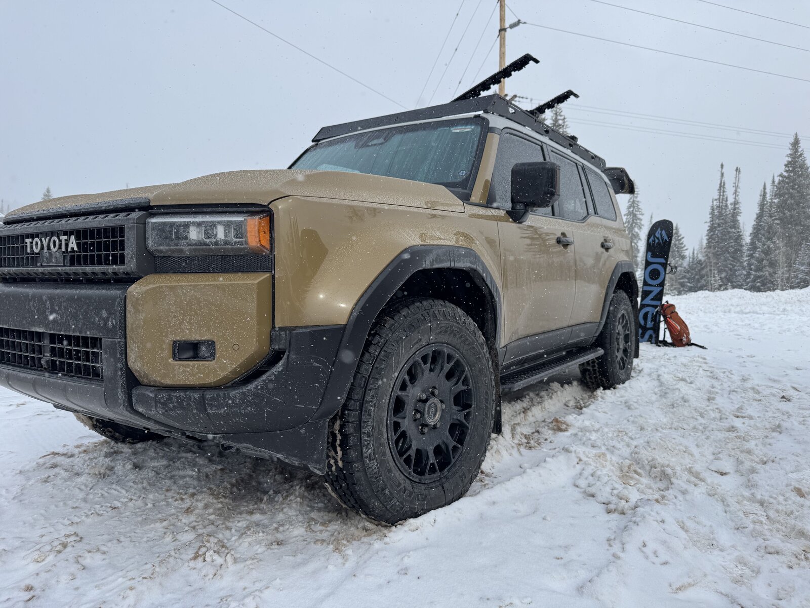

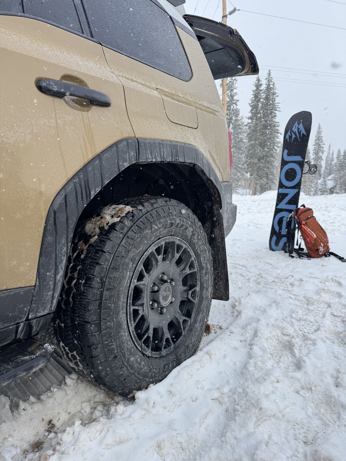

Have put around 1000 miles on the Bridgestone Dueler Ascent so far and really liking them. VERY good road manners and their snow performance has been excellent. I really like that the have full depth sipes and even when worn will be good in the snow, and sipes typically help with slick roads, ice and snow. They have been great so far in loose and packed snow, slush, and limited ice.

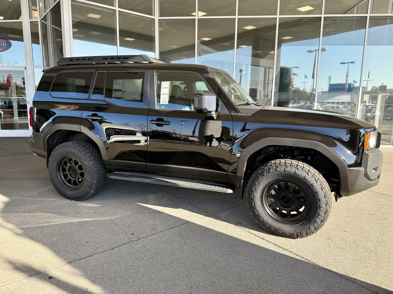

View attachment 27717View attachment 27718
Wheels and tires look perfect. What kind of MPGs are you getting with these now that you’ve had them for a while?
