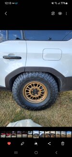

Anyone running wheels with approximately +20 offset—do you mind sharing pics of your poke?
My OEM wheels have been relegated to snow tire duty, so I’m shopping for summer wheels. Would like to stay at 18” and upgrade to Bead Grip wheels, but Method’s only options are +0 and +18 poke, which is annoying. Can get close to that magic +40 number by downsizing to 17” but seems like it’s a tight fit 😒 Backup plan is the Tacoma wheels, but want to see if the community can assuage my concerns about hitting the fender when the wheel is fully stuffed.
I skimmed all 61 pages of this thread and found a few examples, but they all seemed to be wider tires, so it’s hard to gauge if it’ll be an issue (I probably missed some too)
These are +25 offset. The poke really isn't that bad for me. Lots of folks are after the OEM+ look; for me, if I'm going to spend some money, I don't want it to still look stock lol
From other angles, it looks perfect imo
The rear stuffs just fine
The front very slightly scrapes the inner fender. With a bit of tire wear, that'll go away. Mostly happens when I'm driving really fast down the beach and hit a low point and flex down
