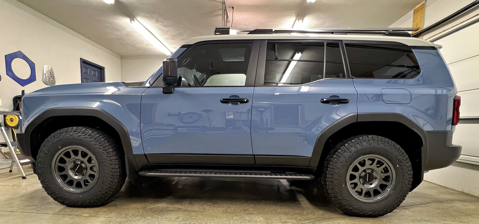

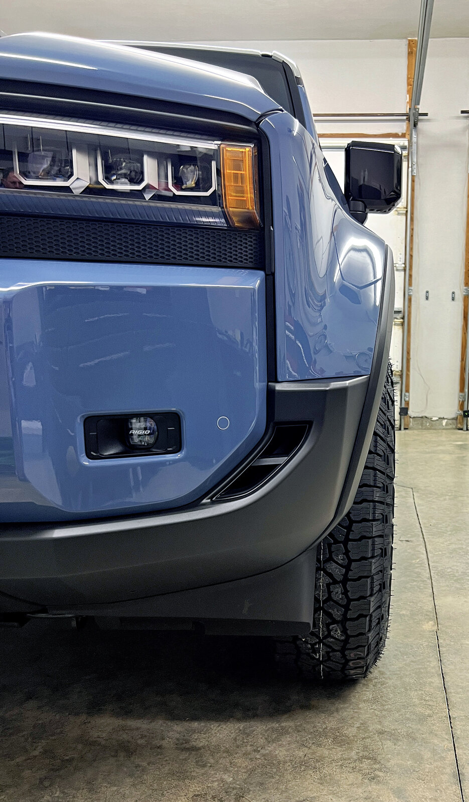

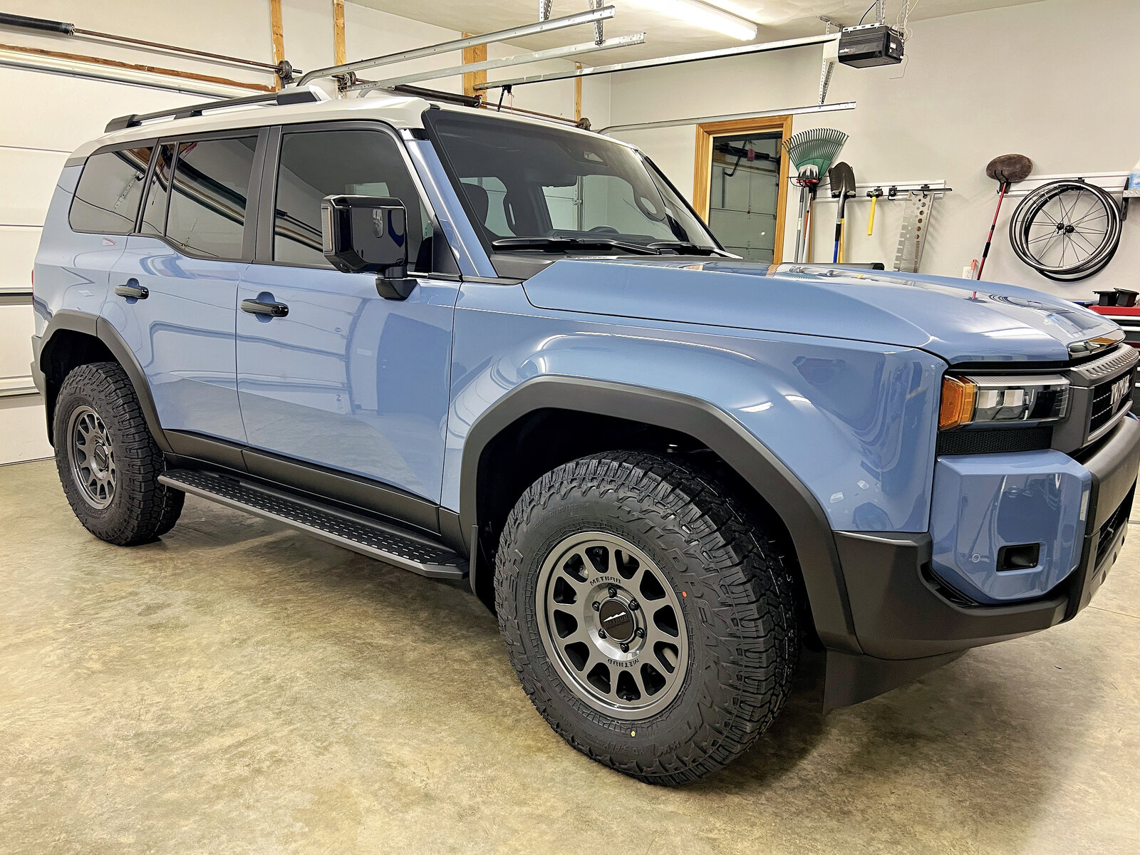

Method 703 wheels, 17" +35, Gloss Titanium
Falken WildPeak AT4W, LT255/80R17 (33")
Currently running the new tires at 39 PSI per Falken's Tables
The new wheel/tire combo gives me about 3/4" more clearance underneath than I had with the 265/60R20 tires.
I bought a set of Toyota TPMS sensors and had no issues connecting them (I'm keeping my 20" wheels and will switch out between the two sets depending on the time of year and whether or not I'm going off-road.)

It rides better on the roads with the stock tires. And, as ridiculous as this sounds, my wife actually likes it better with the 20" wheels (n). She's wrong, obviously. I'm not saying that's grounds for divorce, but it's gotta be close. :ROFLMAO:

Would you be willing to provide one more pic taken from the rear of the vehicle down the side so that I can gauge the offset of that wheel just a bit better?
Thanks!
Thanks!
Just about perfect in terms of fit and poke.

I'm not sure why it's been suggested that 17" rims could be problematic. I've had less clearance between the rims and the brakes on other cars with OEM wheels. The front has more clearance than the rear, but the rear isn't exceptionally tight either. The easiest way for me to explain is that I can get my wheel brush in between the calipers and the barrels when I clean them. I've had more than one car where that wasn't possible.
