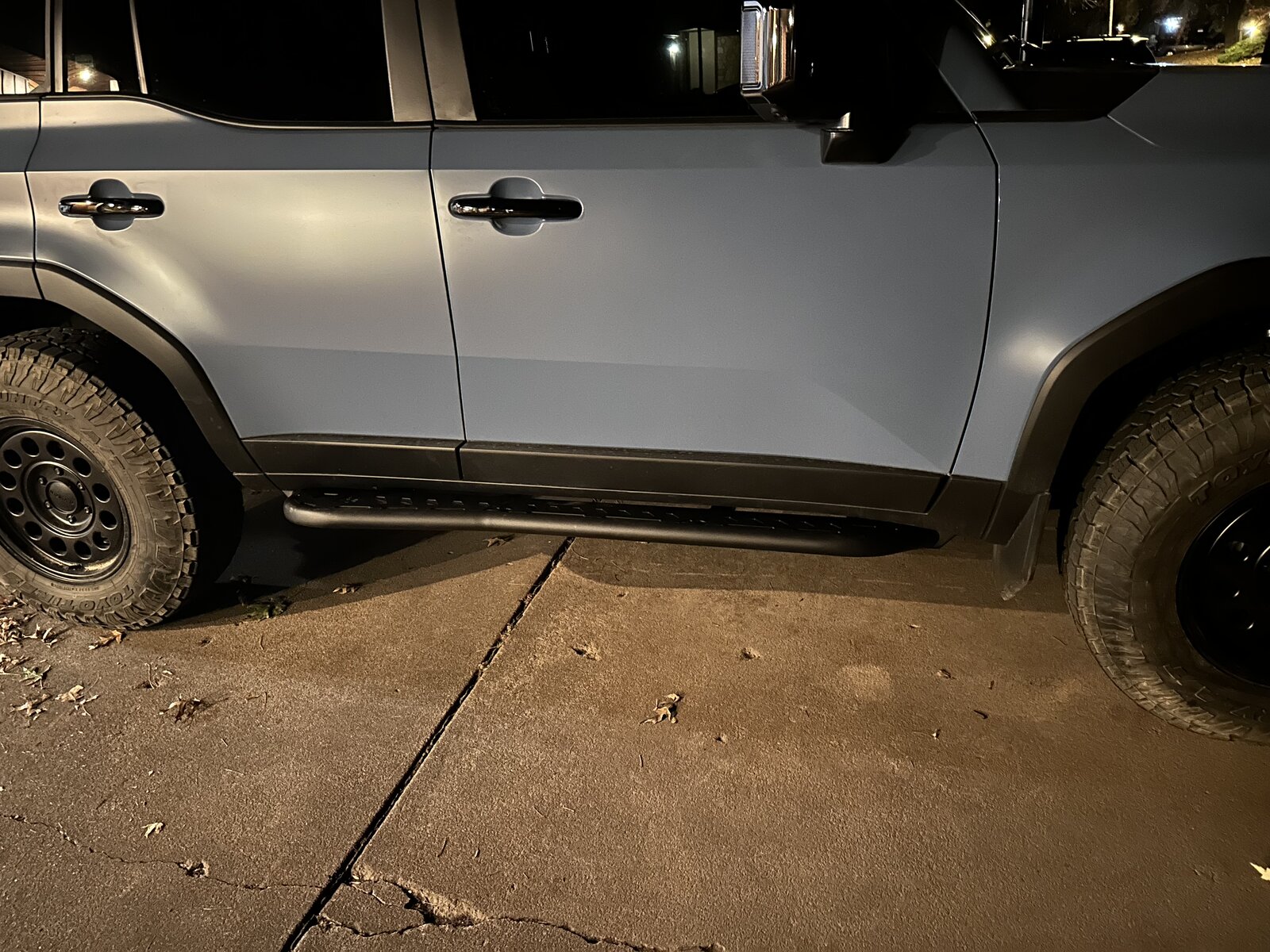

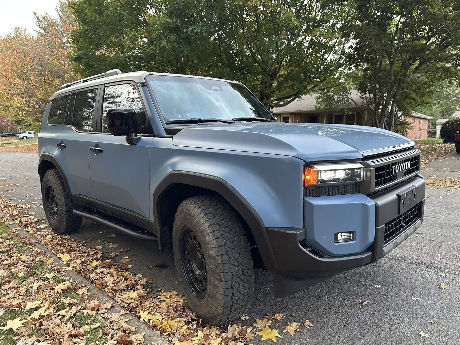

My winter upgrade.

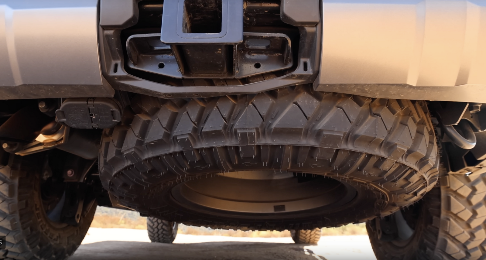

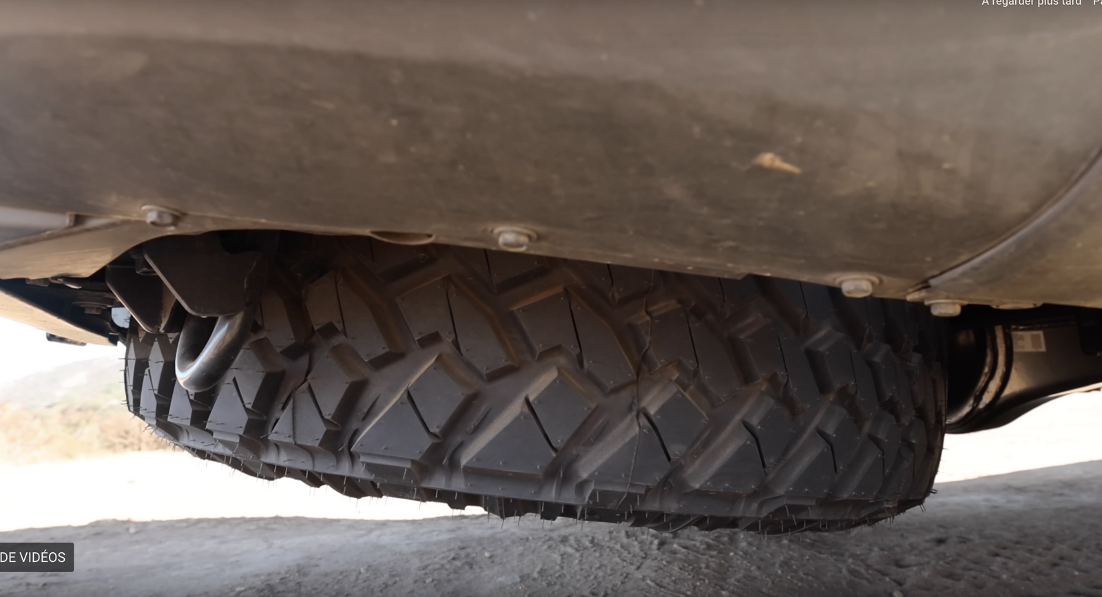

One of my biggest gripes about the LC is that they made it a hatchback and put the spare under the truck. What was wrong with the swinging door with tire carrier on back of truck I don't know, but they thought of so many great improvements for the LC but then turn around and make it a damned hatchback.

I like a skinnier tire and 17" seems to have better options in that regard. I like this look @kerner with the 255/80/17. Basically a 33" x 10". Probably keeps the mpg's pretty good too.
