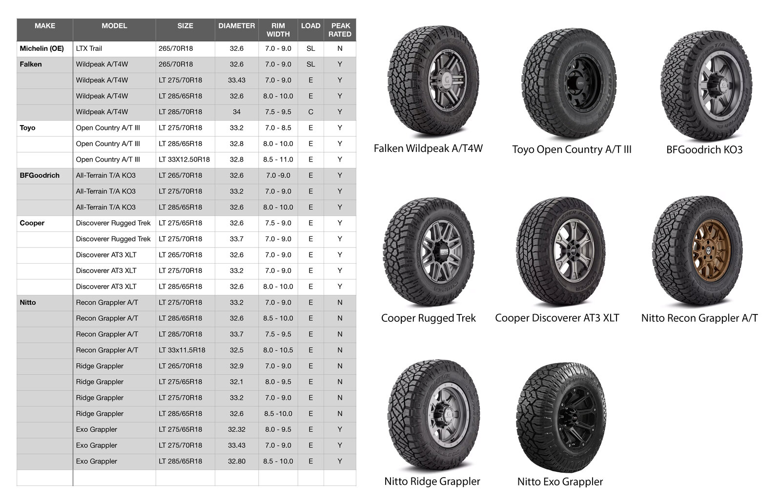

This is a good point. So with too much time on my hands to obsess about my LC arriving, I created a comparison sheet for tires I'm looking at with specs that include the actual diameter and rim width requirement. Sharing in case others find it helpful.View attachment 1895
Great list! Such a bummer we don't get more Load C and D options in these sizes.

Post some prices also. Some of these tires are more than 33% more by going up one size. Most of you guys are not going even close to off-road. Thatโ€™s a lot to spend for a pavement princess.

Also, some of the sizes and load limits donโ€™t exist for some off these brands.
A search of the KO3โ€™s on discount tire show only the 265s are available.

Sizes below straight from BFGoodrich website. My local tirestore has all the sizes I showed available through their distributer (ADT).

Have we met? Pavement princess?! And if you want prices posted, go for it. I'm just posting the info I wanted, in case other people find it helpful. If you don't, then just move on.

That's awesome! What tire are you leaning towards?
Are you concerned about the weight of the tire at all? I've been going back and forth between the KO3 and A/T4w.
KO3 275/70r18 - 60 pounds
A/T4w 275/70r18 - 54 pounds

Iโ€™m currently deciding between the Wildpeaks and Open Country. I live in the PNW and read too many bad reviews about KO2 performance on wet roads, not sure if KO3 improved this. The weight is one factor for me, the Wildpeaks come in heavier for the sizes Iโ€™m looking at.

Unfortunately, it doesn't look like the new K03s are any better on wet pavement. Check out the video below at about the 17:30 mark for a real-world test of the new K03s on wet pavement. He doesn't a bunch of drifting around earlier in the video as well, but comments on the tires about the 17:30 into the video.
