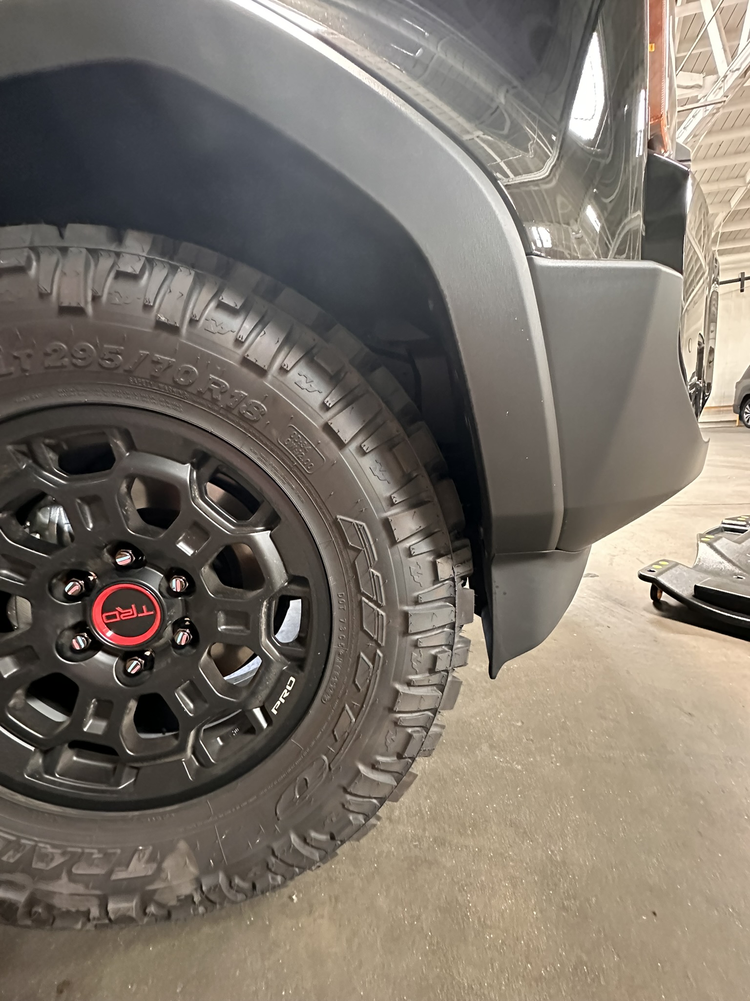

Anyone done or planning to try 285โ€™s in an AT (KO2,etc) on the stock rims?
I'm going to try 285s, but mine just arrived at port yesterday, so not sure how long until I can test it. When is yours arriving, and are you trying 285s?

Same, don't want to do any lift (maybe leveling kit if needed) but would like bigger. I've seen others get 275/70s and say they wish they'd gone bigger, but clearly 295/70s won't work per wmah523's test. Hope 285s will be a sweet spot ๐Ÿคž
I REALLY want to think 285/70s will fit, but just not sureโ€ฆโ€ฆ
