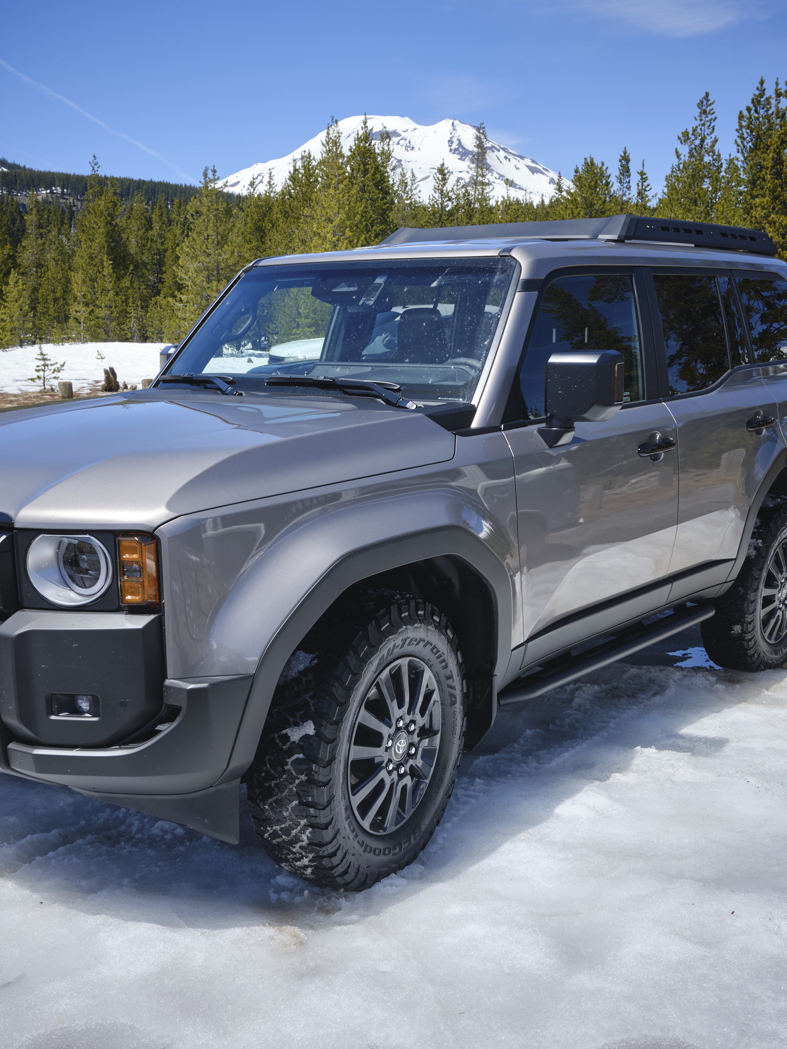

I ended up going with the 18" Toyota TRD wheels with some Falken Wildpeak AT4W in 285/65/R18 (SL). I started with the E-Load 265/70/R18 but they rode stiff enough to correct for my personal taste. I also tried the Method 703's in 17" with AT4W's (SL) and KO3's (C) in approximately the same size. If anyone is interested I'm selling my factory OEM 20's with wheel/tire/sensors. Also selling the 17" Method 703's. Black "Toyota" center caps and bumper covers coming!!

I personally liked the look of the TRD wheels better than the Method 703's once they were on the vehicle. Just a slight difference in offset and I still got the look I was going for. The Methods were amazing wheels - Just personal choice more or less.
The C rated KO3's were a nightmare to balance - We got decent road force numbers at the cost of excessive weight per tire. I had the same exact issues with my KO2's on the Raptor and BFG is starting to leave a bad taste in my mouth.... I think they look amazing but hated the wet performance (KO2's) and balancing issues with both.
I wish you luck in your journey - its a tough one!
Those Falken AT4W's you quoted are 68 pounds per tire at 34x11.5"- You will feel that on this vehicle. I would strongly suggest anyone that has 80-90% pavement driving go with C rated (6ply) or lower. On smooth pavement the E rated tires felt fine - but most roads around here aren't perfect by any means.

I like the setup you are running. It looks fantastic. Off topic question, how has it been coming from the Raptor to the LC? Current DD is a '22 37pp Raptor. I love it, but it cant fit on some of the back trails I routinely tread. Any huge regrets moving on from the Raptor?

I’m a Toyota die hard as I’ve had great reliability over the years with them. I didn’t have the best of luck with my Raptor and I only owned it for 3 years and 60k miles before moving back to Toyota. Looks wise - The Raptor is tough to beat. The Raptor has a spacious cab but lacks the conditioned trunk and it doesn’t fit in the garage. The LC is so new to me that I will need some time with it before making a good personal comparison. So far - I love it
