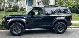

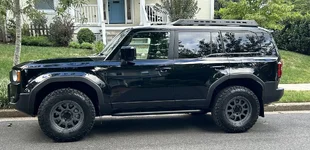

With a debt of gratitude to the insights from this forum - and @Markarian421 in particular for putting together his spreadsheet - I finally settled on 275/70/18 KO2s mounted on Method 316s with +18mm offset in Titanium Grey. I did the spare too, and as you can see from the rear photo, it fits, but droops about 1-2” below stock. Can’t wait to get them off-road and get them dirty.
So far, after about 500 miles, I’m averaging about 18.7 mpg (about 20.7 on a recent road trip). Ride with the E-rated tires is only noticeably stiffer over potholes at speed. Road noise was noticeable if you were listening for it above 70mph, but not intrusive.

so nice ...like the titanium.... do you need a level kit ? looks like the tire is still in the wheel well so that's a plus do you feel it sticks out ? we have strict safety inspection laws where im from...
I had both, currently run 275/70/R18 Toyo Open Country AT3. Longtime BFG customer, the Toyo tires, hands down better tire. Barely hear it, not noticeable unless you are listening, rides great. MPG is negligible IMO, we are driving a brick. MPG is a bonus, but may have lost 1 to 2 mpg, but jury is still out. What I came from, anything over 12-17mpg is a win in my book!
Yeah I have them on my older landcruiser and love them. They are E rated. I think the E rating vs SL or whatever is overhyped and you don't notice the difference. If anything my landcruiser actually feels better with the E rated tires more planted and doesn't wander as much but that may just be me and confirmation bias.
Thanks! - wanted some contrast for the black car, black tires, etc., but bronze seemed a bit showy.
No level. The change in offset may have helped a bit with fit. No issues with rub at all, but I like that poke is still minimal. I came form a squatched Bronco, and that was too much. Think the outer wall is outside the fender by around a half inch. Not sure if that flies for you, but not an issue for us.
thank you for the info ...looks great I have a black 58 on order....same thinking as you bronze a bit too much so i was going with black rims but i like yours it gives it some style but still looks tough ...congrats again ....cant wait might have to copy you !!!!!

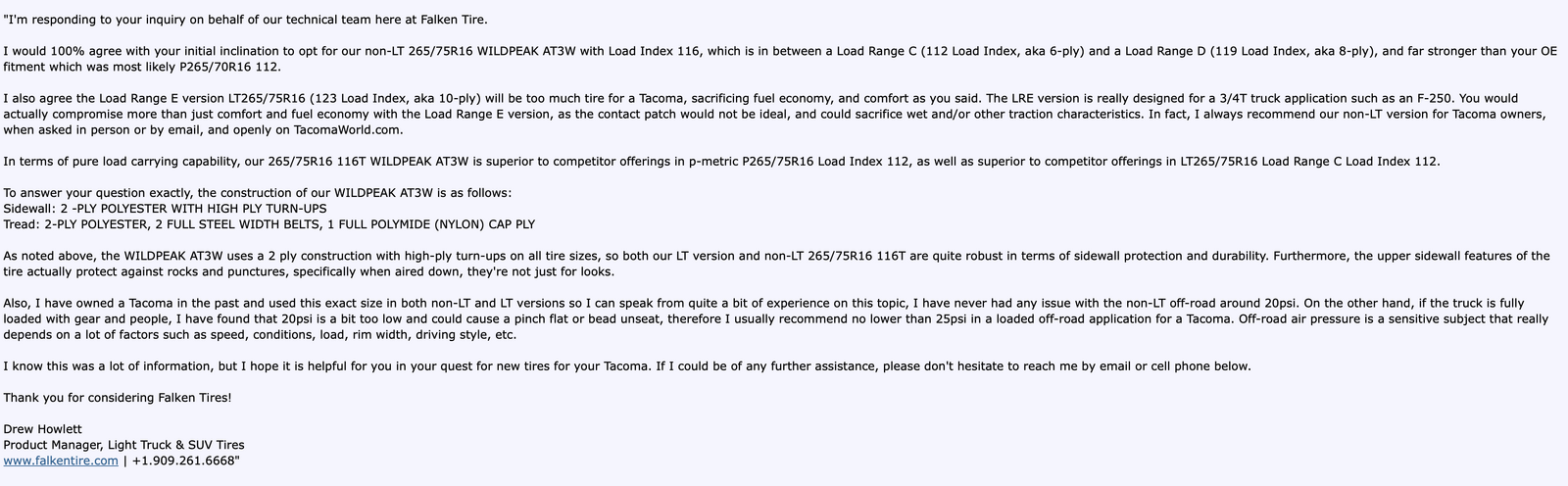

As many of us are struggling with how to replace the OEM tires with something more appropriate, I came across the following. The information below from a Falken product manager is a few years old and from a Tacoma forum but should be relevant as we look for tires that can handle off-road and winter use cases while giving us a comfortable and fuel-efficient ride while we get to our off-road destinations.
FWIW, I do run Wildpeak LTs on a heavily loaded Gladiator that perform like a champ off-road but I'm coming to the conclusion that they would not be ideal for the new LC.
Also, I believed that the AT4 has a strengthened sidewall compared to the AT3. I would not buy AT3 today unless Falken exprility states that they intend to continue production, as future tire replacement could become an issue.
I may very well buy the AT4, but I feel the 4x4 forums biased towards Falken as they used to be for KO2. All $300+ AT tires have very good durability. The most important quality indicator of a tire is that it is expensive.
The reality is that Falken design choices are focused on work trucks. Tire capable of very high mileage are not a primary characteristic most LC owners actually want because it's a tradeoff to other desirable characteristics.
The 10lb lighter expensive Goodrich Ascent is targeted at recreational 4x4. In a rational world that is the type of tire Toyota should have put on the vehicle instead of their choice ending up being sent to the dump. We won't see that waste in any environmental impact report for Toyota.
