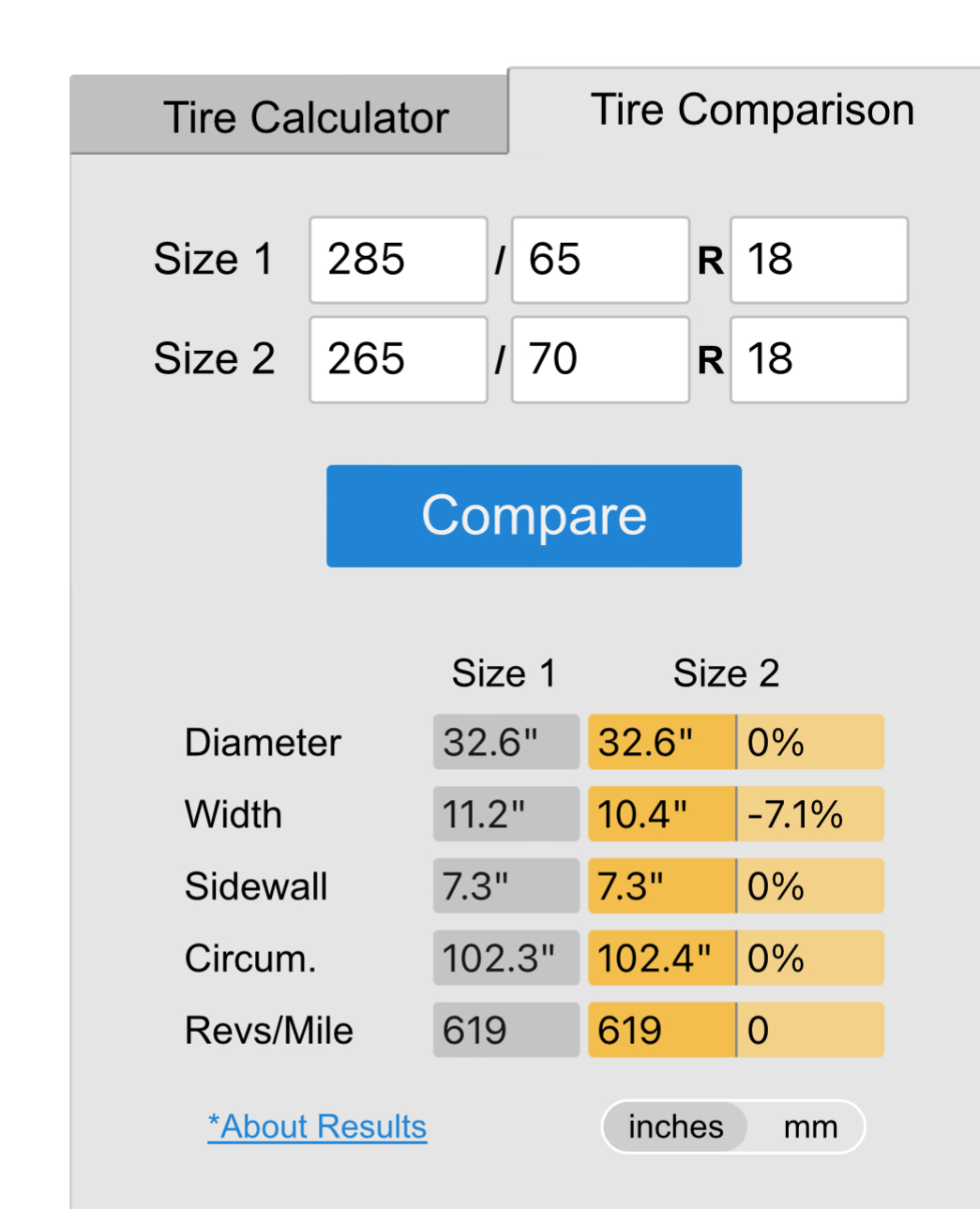

Late to the thread, but I wanted to mention that 285/65/18 tires are exactly the same rolling diameter as the OEM 265/70/18s. I’ll paste the tire size calculator result below. This would mean we could safely keep the OEM spare.
I have Wildpeak AT3 on my [outgoing] Tahoe, I see they are available in 285/65/18. Has anyone tried them on a LC?
The few I've looked at generally require a minimum 8 or 8.5" wide wheel, wider than stock -- you'd need to upgrade your wheels. Do you know of any standard load options in that size? I might have to check, the few I've looked at are E load, a standard load or C load might work on the stock rims. It will hang down noticeably in the spare location.
Edit: WildPeak A/T4W comes in standard load in that size, requires a minimum 8" rim.
My oem stock tires are 245 70 r18
Fair point. I hadn’t gotten as far as figuring out the OEM wheel width, Sounds like it’s 7”.
7" on the 1958, 7.5" on the other two trims. The two most common (so far) Toyota wheels people are getting (mostly to replace the 20" once) are 8" and 8.5". See the second tab of the spread sheet at: 2024 Land Cruiser Stock 18" Wheel Tire Options
After a quick search, the only standard load AT type tire I found in that size that fits the 7.5" rims is the Yokohama Geolandar X-AT.

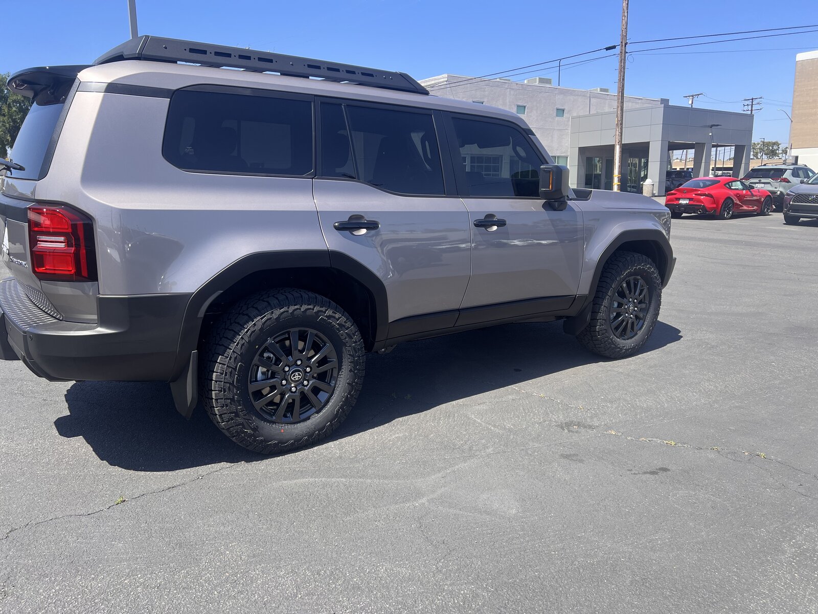

Upgraded tires on stock 18 inch wheel. Went Toyo Open Country AT3 275/70/18. Ride great.

Did you have Michelins? If so, do you notice any degradation of ride quality, increased tire noise, or decrease of fuel economy?
My next purchase…
Yes, ditched those. Ride is probably a little better imo, no decrease in mpg, and these tires are quiet compared to other BFG All Terrains I've had on my Jeeps.
any rub lock to lock? Did you also replace the spare?
