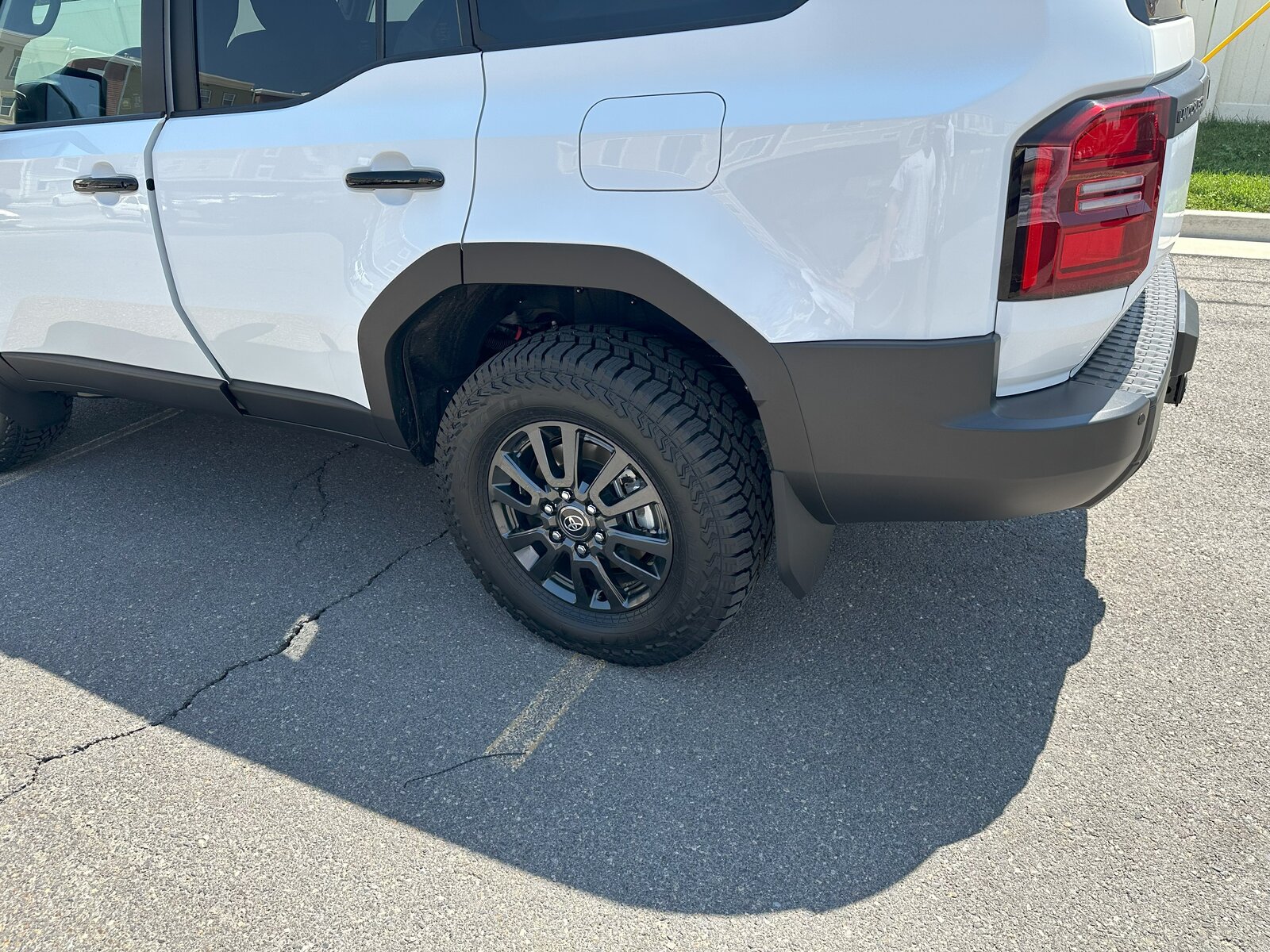

Multiple fittings, Ended up with 275 70 18 falcons at4 on my stock 1958 wheels. Fits great .
Looks great, I am thinking about getting the same tires, how do you feel it runs on the highway? Did you try 285’s on stock? I am going to try 285/70R18 on Stock with a westcott collar, but we will see…I actually like the Toyota wheels and want to keep them! Have you noticed acceleration to bog down a little or not really?
