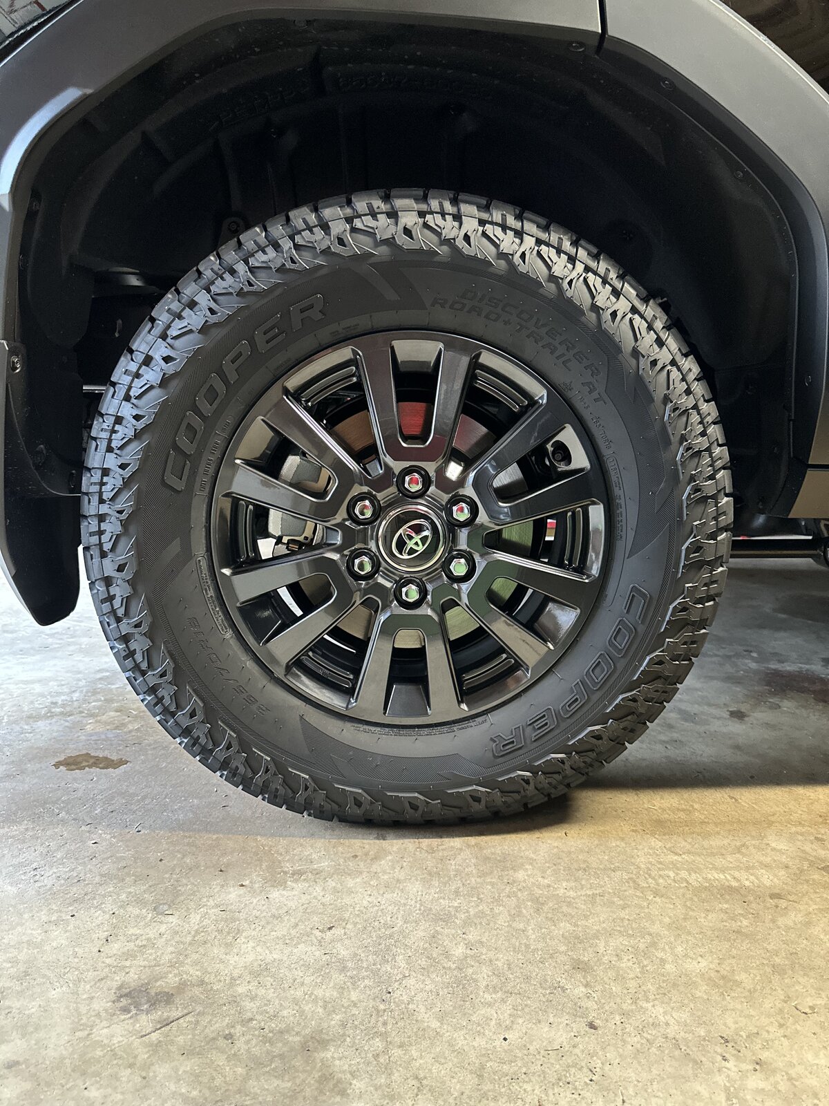

Will be getting installed tomorrow in 265/70R18 on a 1958, will report back.
Only drove about 20 miles at up to 75 MPH. Initial impressions are mostly very positive. The good: road noise is extremely low, perhaps quieter than the OEM Geolander; ride is awesome compared to OEM, it soaks everything up, even being a little overinflated from the install - there's no harshness now; feels planted and handles well; looks really good; and it (unexpectedly) lifted it about an inch, lowest point of ground clearance is a little over 9" compared to 8" before. The not so good: the on center feel is a little loose, but is to be expected with an A/T; steering wheel is slightly off now and the on center play doesn't help - it was perfectly straight before. Personal preference: was expecting it to lift about Β½" per tire specs, but it turns out the OEM tires are almost 1.5" inch shorter than spec - that's not necessary "bad" but it is now extremely close to not being able to open the hatch in my garage (ΒΌ" of clearance) and adding roof rails will be getting close now, I don't know that raised crossbars will fit under garage door; it turns out the speedo was apparently off because the OEM tires are smaller than spec, not because it was programmed for 265/70's as I had thought, so now the speedo is off 2 MPH at highway speeds and the mileage is off too - I personally don't like this at all on a new vehicle.
Let me know if you have specific questions, I'll try to answer them and update over time. All in all very happy with them so far, but everything has trade offs. One concern is how much of an MPG hit it will be as these look much more like a Toyo Open Country III or KO2 than I was expecting.

Don’t worry the road noise will increase as they wear. Cooper makes a good at tire that is tough but in my experience they wear bad.

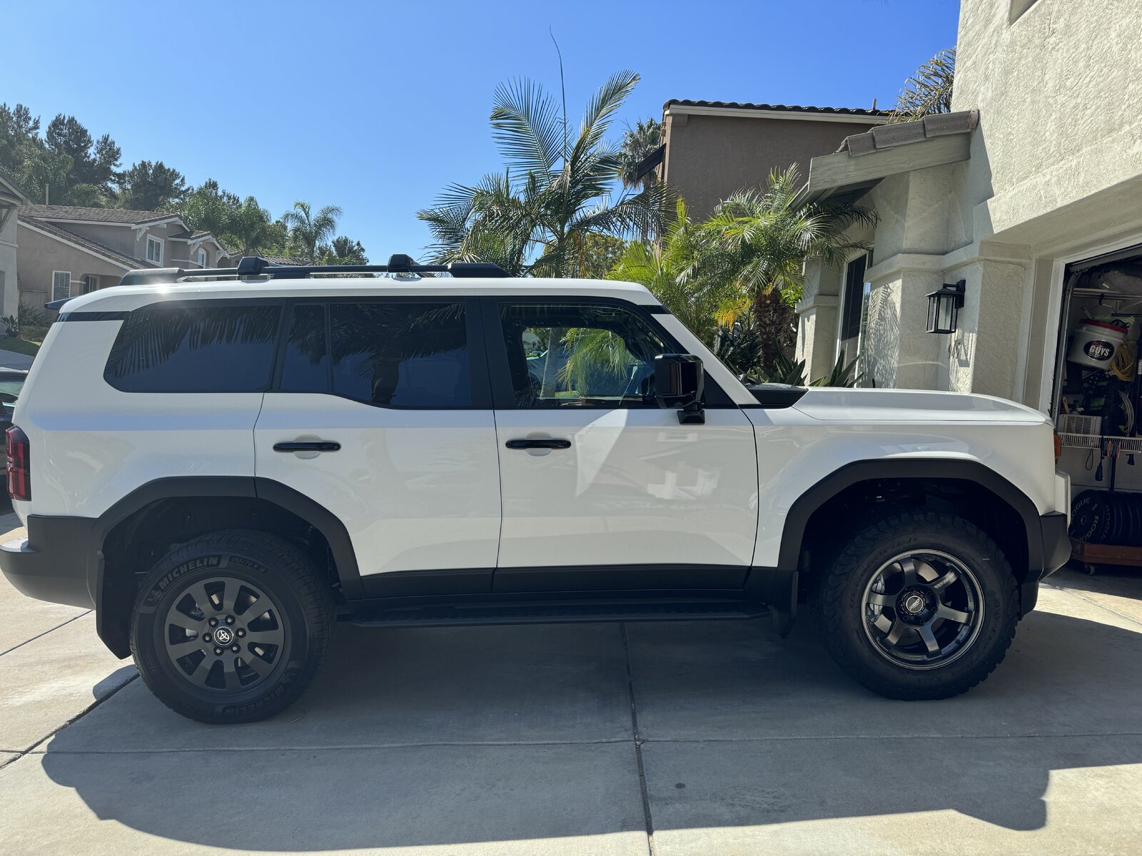

To me, this look from @bobs619 is the best combination of wheel and tire sizing I have yet seen: 18x9 and 0 offset wheels, paired with 275/65/18 KO2s. I would like to do Method MR305NVs in combination with 275/65/18 KO3s. Any idea if this will fit in the spare compartment? Thanks!

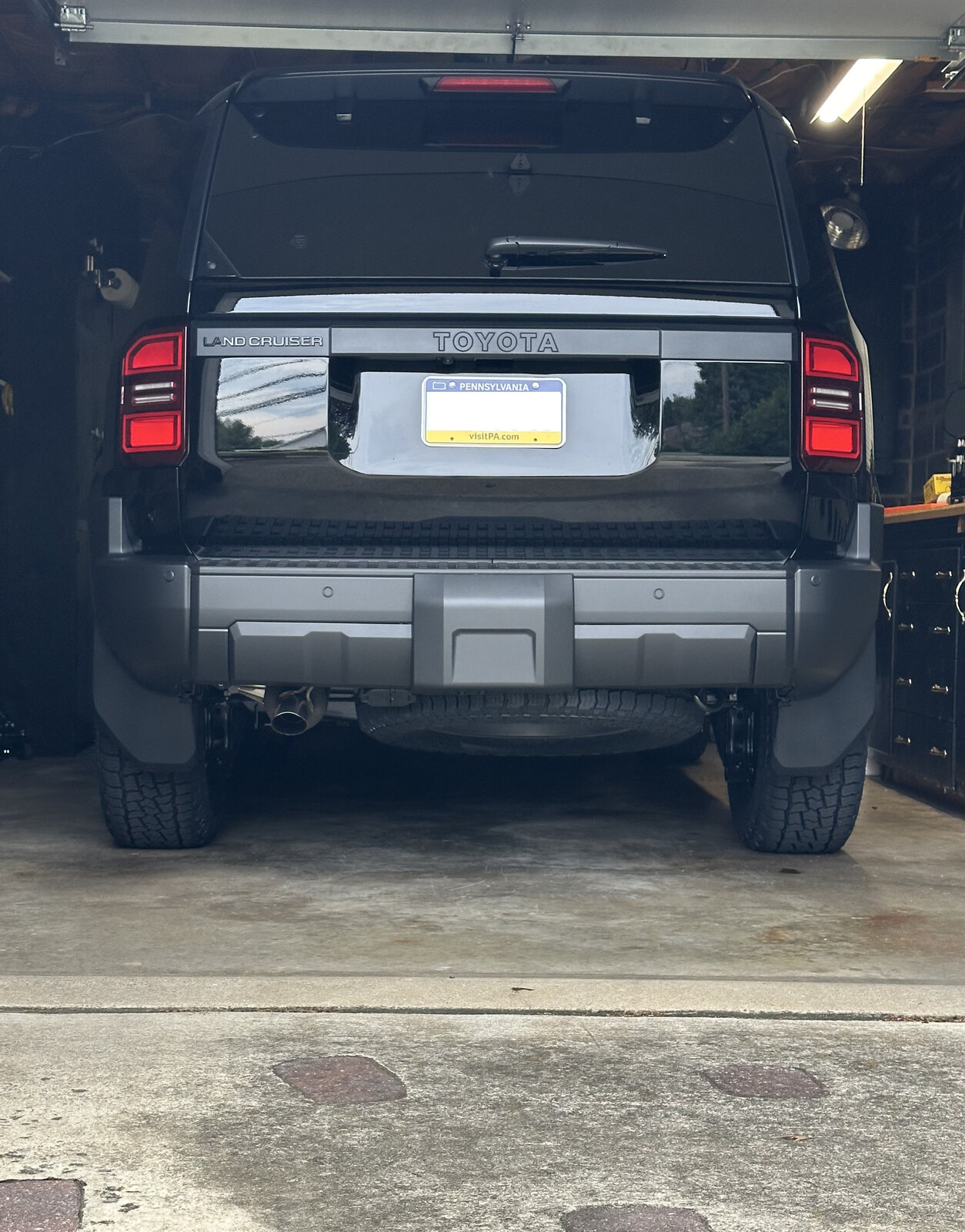

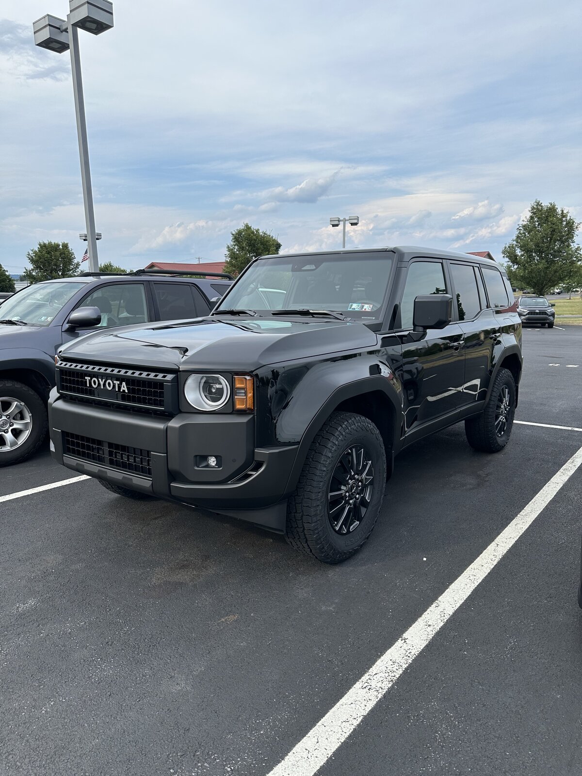

Here u go bro. Switched up to 275/70 ko3. Slighty taller and skinny tire to match height of stock and minimize poke.
*had to do some "adjustment" to front fender liner to prevent rubbing at full lock (on incline). A + size offset might have better clearance.
Not sure many people on here will be actively looking to put smaller tires on the LC then what comes stock... the 275 is slightly wider, but smaller in diameter, sidewall and circumference. No reason at all why it wouldnt fit in the spare location.
