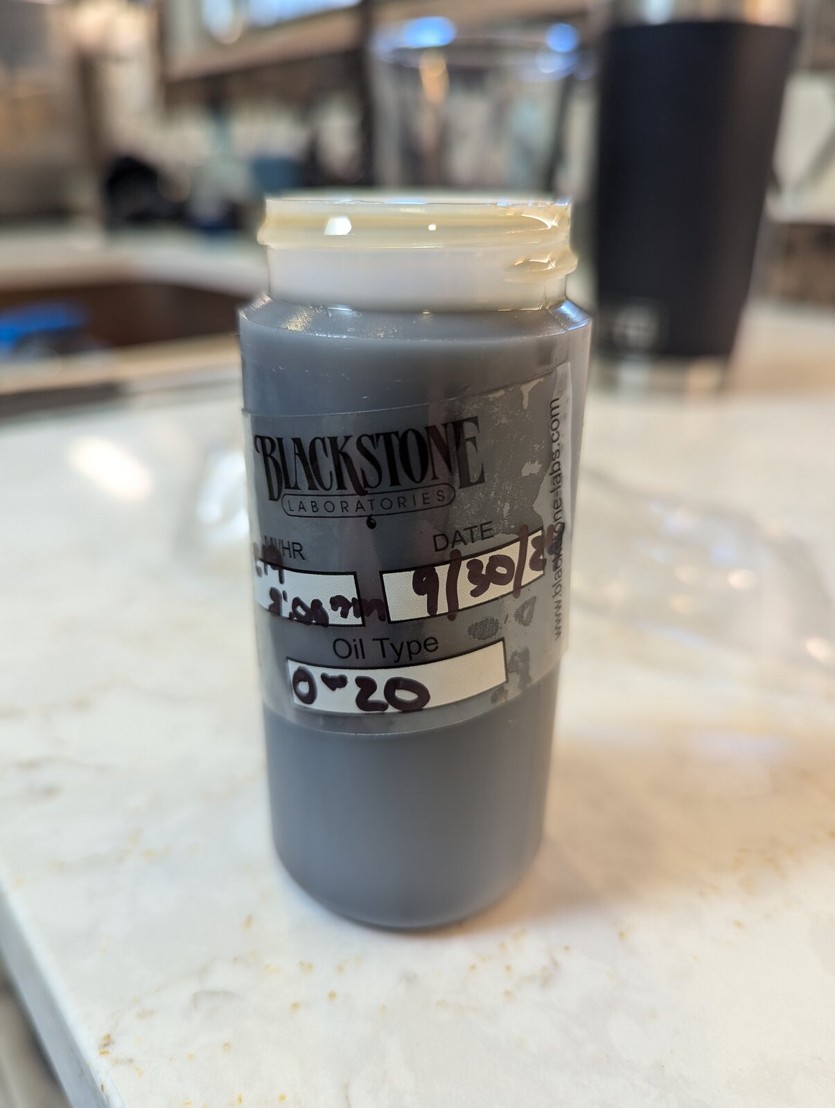

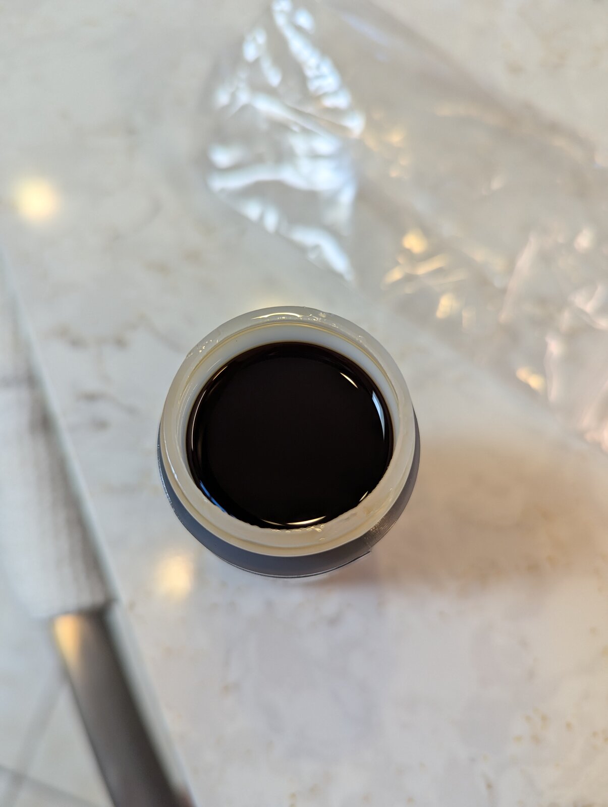

I'm with you D-Train, I've had my LC ~ 50 days and am going to be driving from Santa Fe to Granby, CO with my dog ~ 18 hours round trip plus driving dogs all over a wide expanse for training daily. Took the LC to a shop that works on a lot of high end vehicles including Land Cruisers, the owner has a LC. 604 miles, the owner asked me if I would want to wait for oil analysis as the oil would likely be the dirtiest it would ever be and would likely not give accurate answers and I said I wanted to send regardless. I brought Pennzoil ultra platinum 0w-20 and new Ecoguard synthetic 10k filter to them. The oil was pitch black and the gas smell was through the roof. Part of that might be from me driving 80/20 city/hwy and being soft on the accelerator until almost 500 miles then intermittently short spurts of 2500 - 4k rpm. My point of reference on these small turbo engines is my wife's 2019 turbo convertible Beetle. She has ~ 30k on it and last oil change was 9 months ago at the same shop and has gone ~ 4300 miles and the oil is not remotely close to black. I'm probably going to go to 5k - 5.5k mileage before changing again.
Forgot to mention in my post that my oil was pretty damn black.. in addition to the glitter and few very small machining parts at the bottom of the drain pan. No gas smell that I could discern? I'll probably stick to a 5K OCI schedule moving forward.

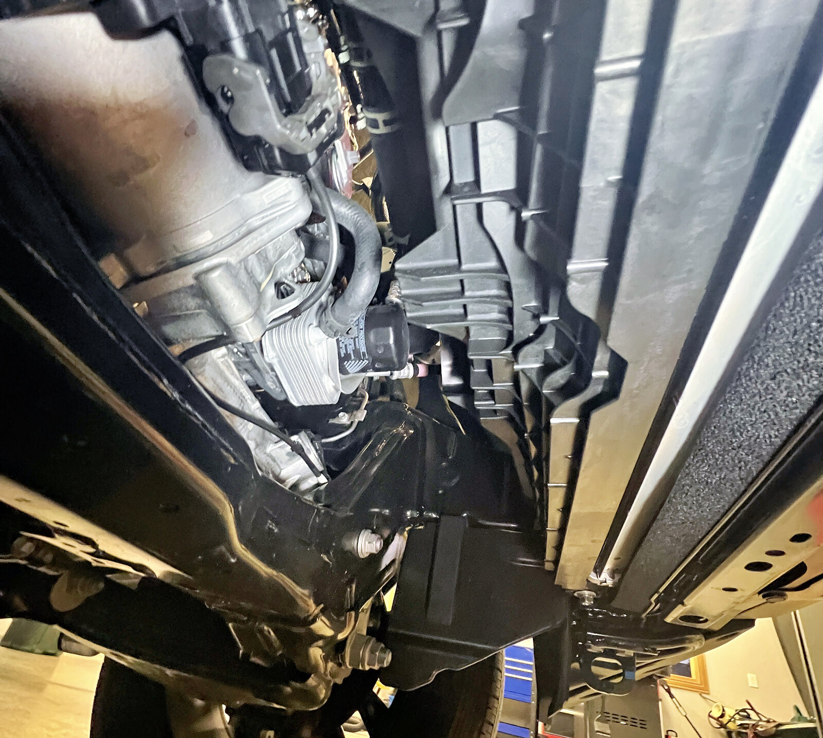

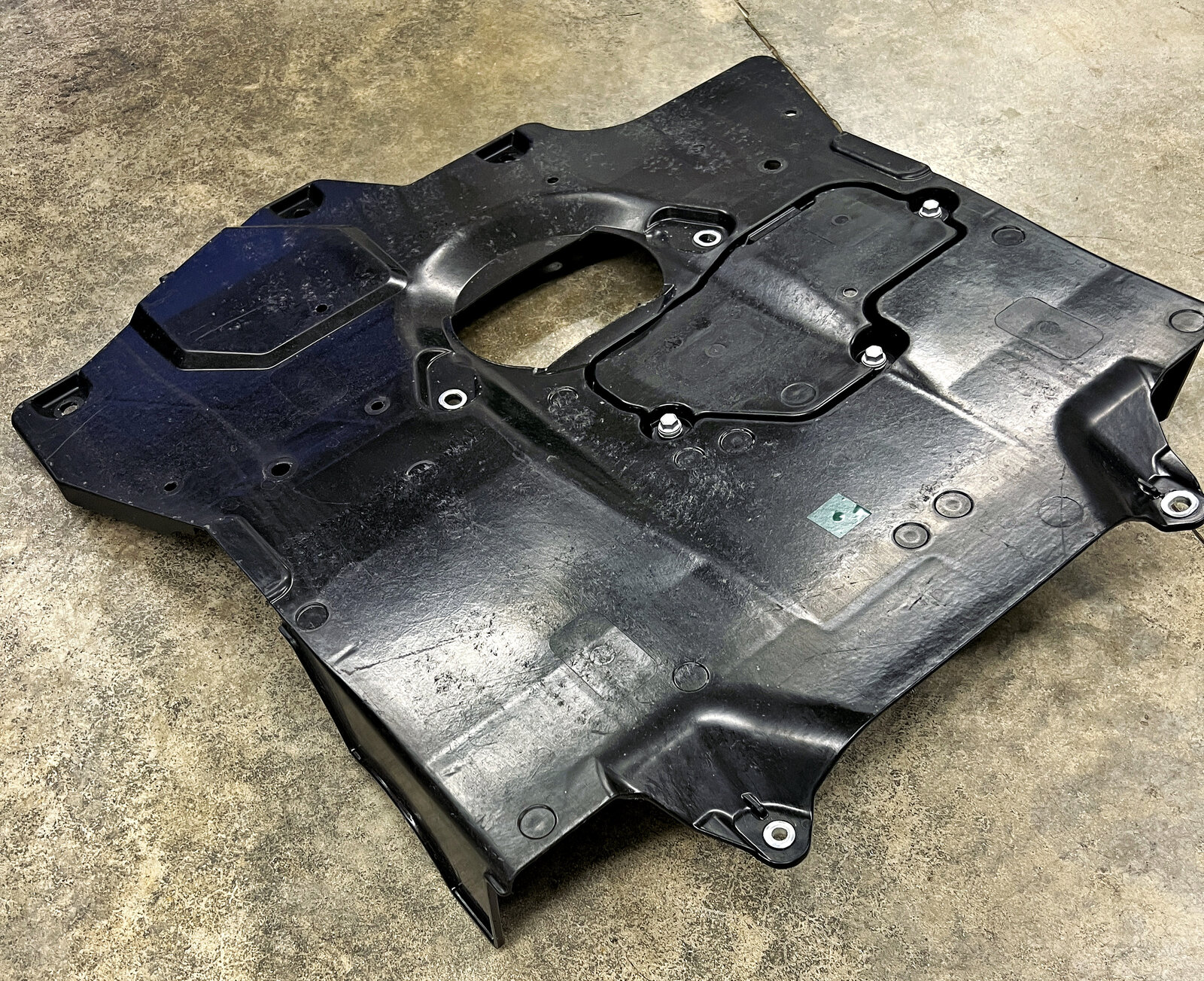

Took the LC on a road trip and changed the oil today after getting back (1200 miles). I was surprised to find that the "transmission and transfer case protection" is a plastic shield. Seriously? I'll be upgrading the skid plates sooner rather than later. The oil flows out sideways from the drain pan. I thought I was prepared for the flow, but the oil came out so fast that it splashed out of the pan and onto the passenger side wheel. Not great. But, the oil filter design with the lip to help get the oil to drain into the pan instead of on the frame is nice :)

1. Rear skid plate...err...plastic shield that won't protect anything. Note the access panel which can be removed to drain the oil. I removed the entire plate - it's only four bolts instead of the three for the access panel.

2. Here's a shot of the oil pan. Notice that the drain plug is angled at about 45 degrees to ensure the oil shoots out way to the left. Nice - if you like oil everywhere.

3. Here's a pic of the oil cooler/oil filter with the front skid plate removed. You must remove the skid plate for access.

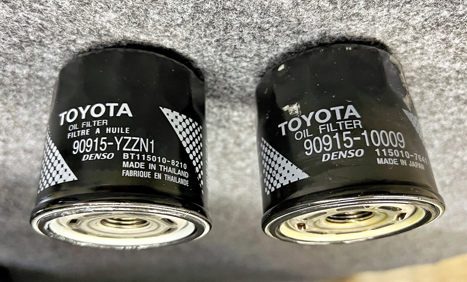

5. New and old oil filter. Note that the original oil filter was made in Japan by Denso, but the replacement was made in Thailand by Denso. Not sure why they have different part numbers, other than the country of origin.

6. A shot of the rear skid plate. I mean "transmission and transfer case protection."

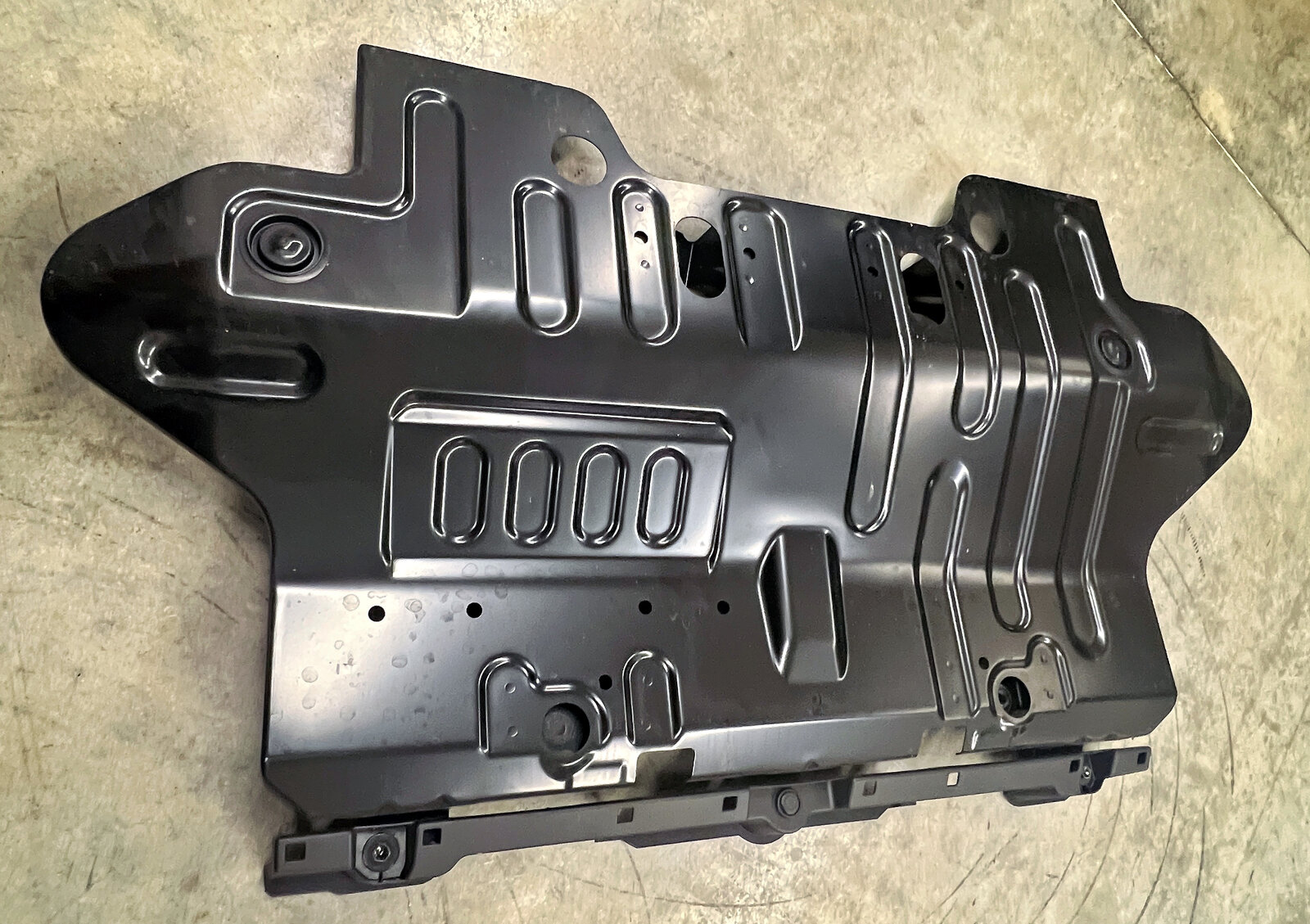

7. A shot of the front skid plate. It's steel, but about 1 mm thinner than the upgraded skid plate on the FE.

I am sending in my oil to Blackstone for analysis. Given the recent history of Toyota - think Taco transmission issues and V6 Twin Turbo failures - I want to know if any debris is found in my oil. Plus, it'll give me a baseline moving forward.
