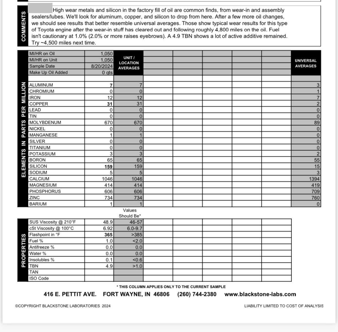

I did my first oil change at 1050 miles and second at 3150 miles. This is the oil from break in @ 1050 miles. This is very similar to others at the same mileage. The metal material is high but normal for a new engine. IMO high metal content will cause more wear. I plan on 1k, 3k, 5k and 5k intervals after. Will post the results of the oil content after I get the results. Once the metal content stabilizes 4-5k intervals or yearly should be good.

I think I heard that TBN was only needed, useful for Diesel engines? Might have been a YouTube video from The Motor Oil Geek, but I don’t recall.

TBN is useful in gasoline engines as well. It neutralizes acids that result from combustion. It was more important in the days of high sulfur fuel, but it still plays a role today.

Yea.. I know that. I have been using Blackstone for over 8 years, and paying for TBN analysis… Avalanche, Subaru 3.6R, BMW R1200GS Adventure, Gravely ZTR, SO’s Nissan pathfinder, X SO’s Chevy diesel truck, another R1200GS Adventure,…
The point was, that TBN is not as useful in gasoline engines, as in Diesel engines, according to the motor oil geek.. just passing along info.
