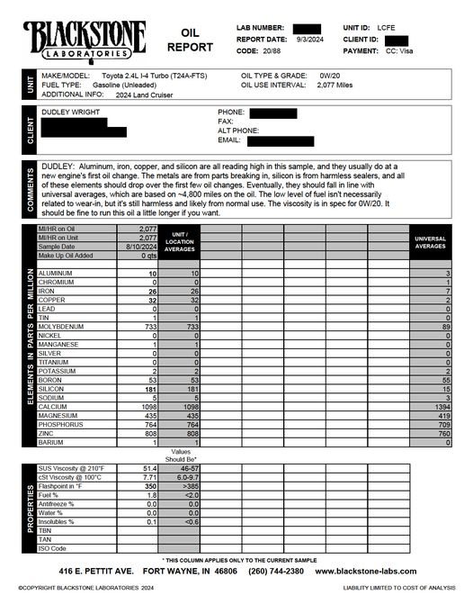

This my my Blackstone report after 200 miles and just prior to my first oil change.

Is this a good report?
It is completely what you'd expect to find when the engine is first run in. IMO, a blackstone analysis that early doesn't tell us anything because the oil is literally brand new. It hasn't even had a chance to really become contaminated with anything but some metal debris. It is like asking someone to run a 5K to judge if they are prepared to run a marathon.
