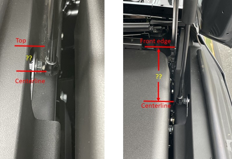

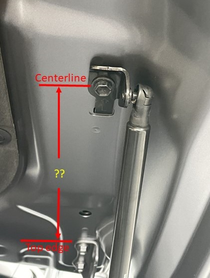

Ok here we go on the GX 550 the "gas" shocks for the hood that we are talking about are actually called Hood Lift Support. the part numbers is the following: 53440-0W590. This number is taken right off a support from my wife's GX. However there are also brackets and hardware that goes along with it. Those I do not have the numbers for. Additionally there are "rights and lefts".
If you have time, could you please take some precise measurements?
1 - Overall length of strut
2 - From the front edge of the hinge to the center of the bolt (hood parts)
3 - From the front of the curved part of the hinge (or firewall) to the center of the strut ball (bottom strut mount).
4 - From the top of the fender to the center of the strut ball (bottom strut mount).
Thanks in advance!
Thanks in advance!

For sure, it appears the FE has two locating holes predrilled in the hood. Not for a strut mount but rather for aligning the inner and outer structures of the hood during manufacturing. Depending on exact measurement of the ball mount, I think they could be used to secure a fabricated mount. The fender has a dimple in the approx location for the other ball mount, and may be as simple as drilling and tapping a hole.
Since it sounds like you are actually serious...
Also pay attention to the bending strength of the hood where you attach a strut. In these days of weight reduction everywhere they may not reinforce a hood designed for a prop rod the same way as one made for struts.
Thanks in advance!
Thanks in advance!
1. Over all 21 3/4
2. Front edge of hinge to center line of bolt 12 3/4
3. Front of curved part of hinge to center line strut ball 4 3/4
4. Top of fender to center line of strut ball 1/2
Hope this helps!
