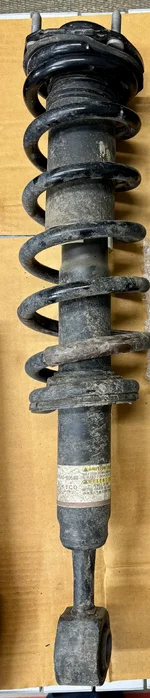

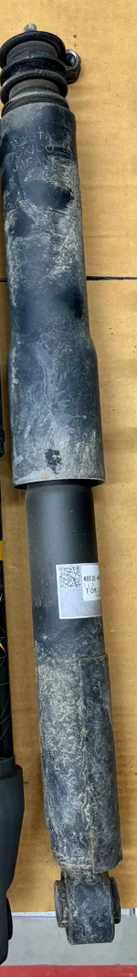

@Bad1975 do you stilll have your takeoffs handy?
If so, might be helpful to snap a photo quick? I am out of town but here is the best I can do:
Thinking if itโ€™s either Bilstein/OME they should be clearly marked on the โ€˜26 LCs
View attachment 62039View attachment 62040
Thanks for the pics. Looks like your shocks are marked 48510-60560 which is what the documents call for mine are marked 48510-60591. I wonder if some of us got the wrong shocks installed? Anyone out there have 48510-60591 and have a decent dampening over bumps? Mine shudders like 3 to 5 times over every bump big or small and it is frustrating.

@Farrell48 are both front shocks the same number?
48510-60591: is listed for these destinations LHD EU: (ARL,GCC,GEN,RUS,SA)
48510-60560: is listed for these regions, A, R, U (I would assume U is for United States?)
There are 5 different part numbers including two for a special package, looks to be NATO/Military/Industrial use type support requirements possibly?
I can definitely see shock valving being different based upon region being shipped to and quality of roads not to mention different engine configurations and therefore weight over the front end, wonder if Toyota ran out of stock and started substituting? The rears are all the same no matter destination unless configured for Egypt/Special package.
Based on this if it were me and the difference is that profound I'd ask Toyota to swap in the correct configuration parts or prove the valving is the same, taking it all the way to corporate/brand engagement if need be. May be a good idea to file a safety concern with NHTSA as well due the weight differences in engine configurations and possible valving differences will have an impact on handling and braking.

Thanks for the info. Both shocks are marked 48510-60591.

Mine are 48510-60570 fronts and 48530-60600 rears and it's a diesel model which may have different shocks than petrol models due to the heavier diesel engine on the front.
