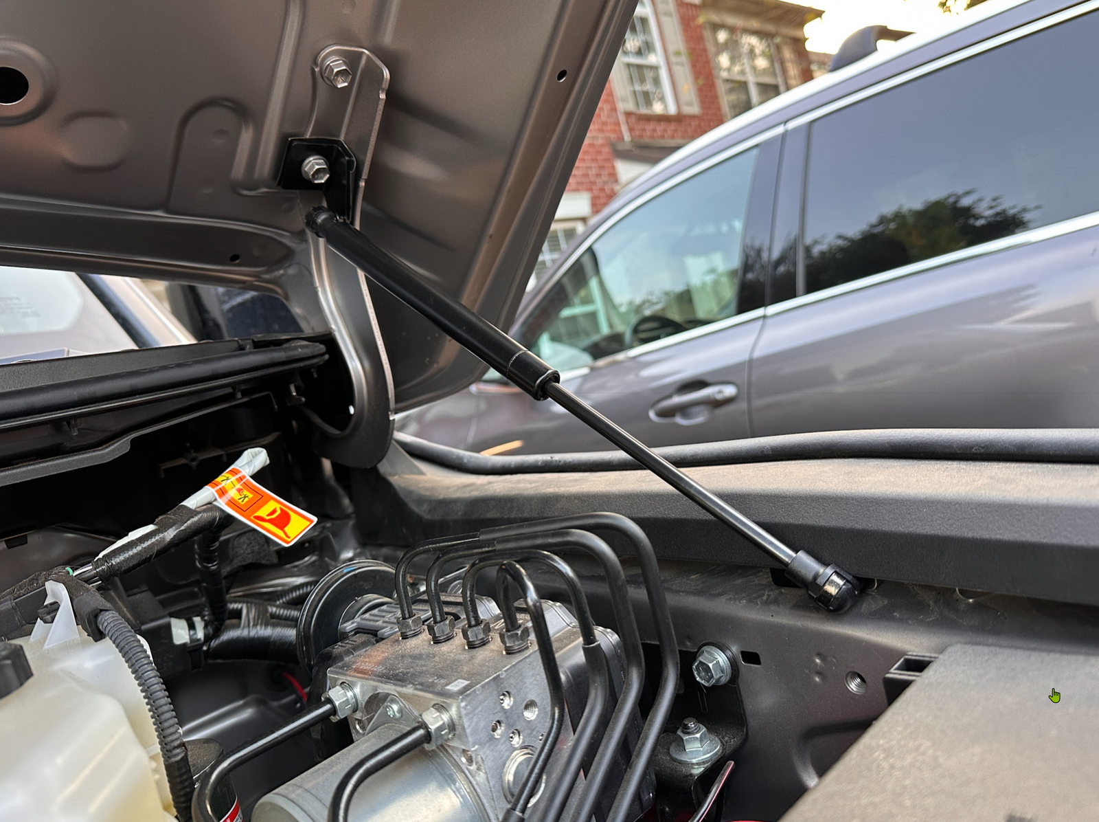

They finally arrive and I finally got a chance to install them:
All in all, I'd rate them as "OK", 3 out of 5 stars.
Pros:
  • They do help lift the hood
  • They do hold the hood up when it is fully opened
  • Easy to install
  • You CAN put the plastic trim back in place without trimming
Cons:
  • They do not lift the hood unassisted
  • The hardware is not stainless and will begin to rust relatively soon I believe
  • I wouldn't trust it 100% to not fail and crack my skull
They do work to allow you to lift the hood with one hand and stay in place which is convenient if you happen to have tools in the other hand. I'd be ok leaving it open without the hood stand for quick things but if I were going to be under the hood for extended periods, I'd put the stand up as well. When I have some time, I'll swap out the bolts and washers that came with them for some stainless hardware. I might trim the plastic just a bit to sit a little more flush but it's workable out of the box.

I think my summary from this early feedback is to wait? Or did anybody feel like yeah "full steam ahead" ?
It's not a lift assisted feeling as with the Redline kit on my Taco. It's of a "not as heavy" lift, if you let go before the hood is fully raised, it'll slam back down, but after it reaches "full open" it'll stay open and takes a slight amount of force to start it closing. Once you start the downward motion, you have to lower the hood vs pull it down. The good part is there probably zero stress on the fender mounted stud ball.
