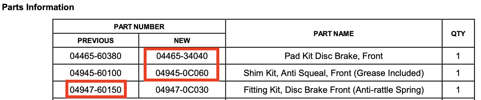

Well, the good news is they replaced the parts without much of a fuss. The bad news is they used the old part instead of the new part for one of the three parts (Anti-rattle Spring). I didn't notice until I got home and looked over the receipt. I guess I'll find out how important that is to the whole thing?
