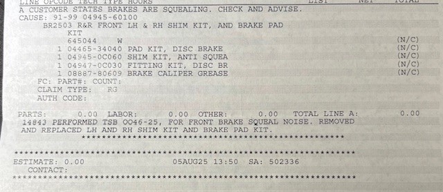

Got the TSB done today.
Here is the story.
2024 - 1958 - Now about 15k miles
Dealer - Baxter Lincoln, Ne.
First reported to dealer @ 5k check (sound started @3k) - Confirmed sound by dealer and documented.
TSB came out and I called and made an appointment to "take a look" and will order the parts for the TSB "if needed" but I had to come in first to confirm what's wrong. (Already did @ 5k check- documented)
Went in for appointment today, they confirmed it was the issue. Easy because mine screeches/howls EVERYTIME I back up and apply the brakes.
Came back to me and said they have all the parts already and will do it right now. I then confirmed they are using the part numbers from the TSB and they said yes.
Its done and it was quiet for the first time in almost a year of backing up.
Had mine in today for the TSB. Well, an hour and a half later all good to go. Squeal is gone. Hope this does the trick.
