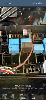

hello, ai ordered the wireless killswitch for the land cruiser 250 and I got in the box 2 relays? do any of you know why they supply 2x not 1.
is there a place to connect directly the power to a terminal instead of connecting it to an empty fuse as suggested in this thread and is there any issue in doing that , I ask because I dont have the female fuse and I need to install the killswitch before a trip urgently

• Relay: use the “Reverse” one for LC
(Universally, There are 2 relays are included: regular and reverse because some vehicles work with regular, but some vehicles work with reverse on)
• Power: you can connect the wires of kill switch directly to jump start post in engine bay ( positive /red wire of the unit to positive post of power on the passenger side. Negative/ground/black wire to any “ground” bolts

hi, just to confirm.. there 2x 10A fuses connected to this mini fuze female ? and why 2?
Do you have a link for the website? Do they make a 'blank' switch (i.e. no light or markings)? If it blended in with the other blanks, even more 'hidden in plain sight'. I'm liking this idea!
I assume the fuse tapp is for the "remote" version of the 41.22 kit.
The two fuses are due to it's a fuse tapp....... 1 fuse is for the original circuit protection and the 2nd fuse is for the "new" circuit protection......... if you didn't have an empty fuse slot and had to use an existing "fused slot" this would be proper.
Since you are able to take advantage of a blank/empty slot, two fuses are needed to make the internal wiring of the fuse tapp, make the connection. There are "fuse extension" pig tails that can be used along with a single inline fuse holder. but that just makes the fuse box cluttered and unnecessarily messy, where as adding an additional fuse keeps everything tidy.
