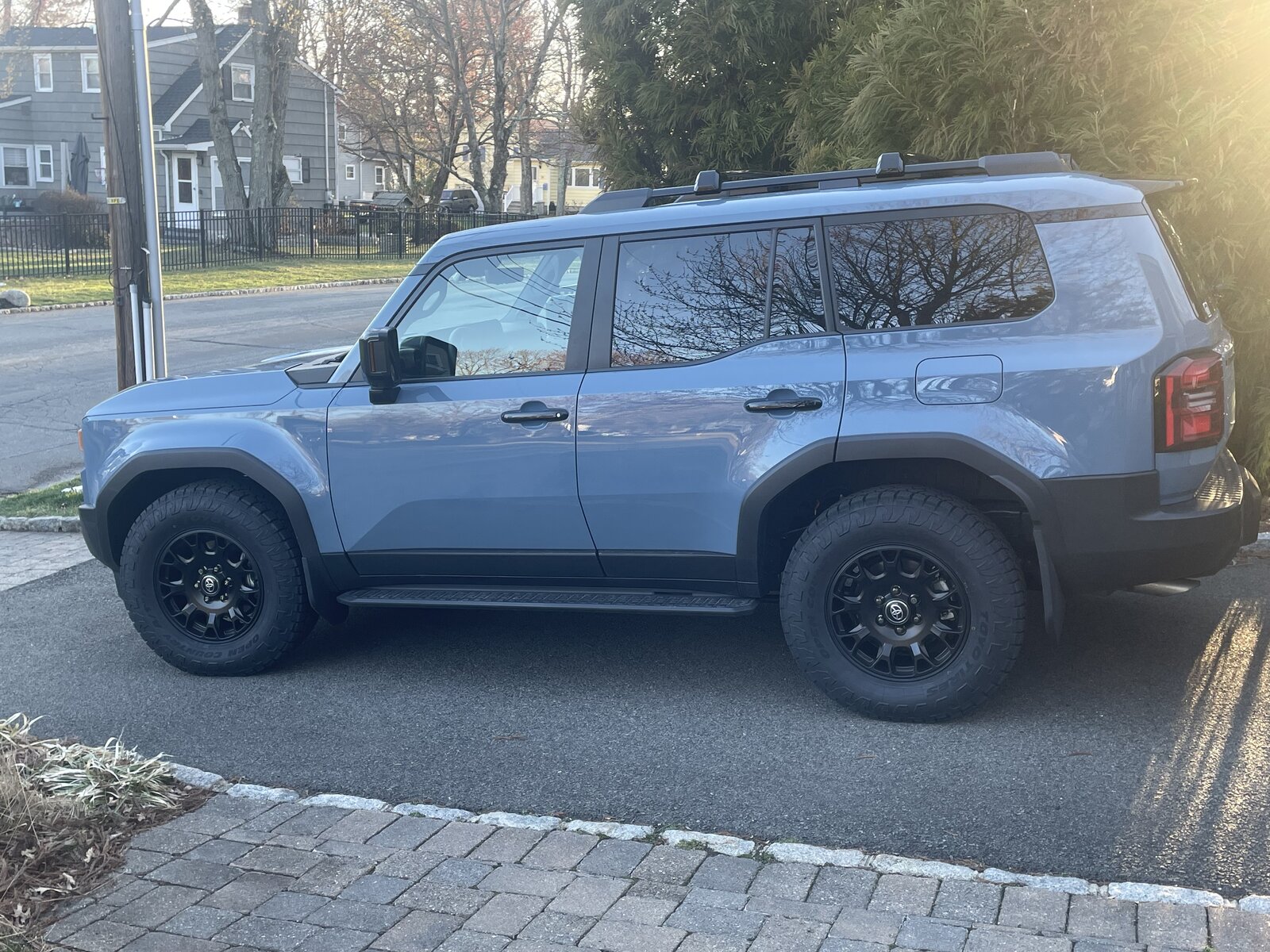

Got them at our local Quality Tire / Tire Pro. Had them in a day. Driven all of 12 miles but the new 18” wheel vs the 20” wheel seems to have given it a better more planted ride (more rubber). Will update the group as we get more miles. Very happy with the Toyo 275/70/18 ATIII EV.
Are those wheels from a Trail Hunter Tacoma? Doubting they are from a 4Runner, as I don’t think the Trail Hunter or Pro 4R’s have hit the dealerships as of yet. Wonder if the Trail Hunter wheel on the Taco and the 4R have the same specs?

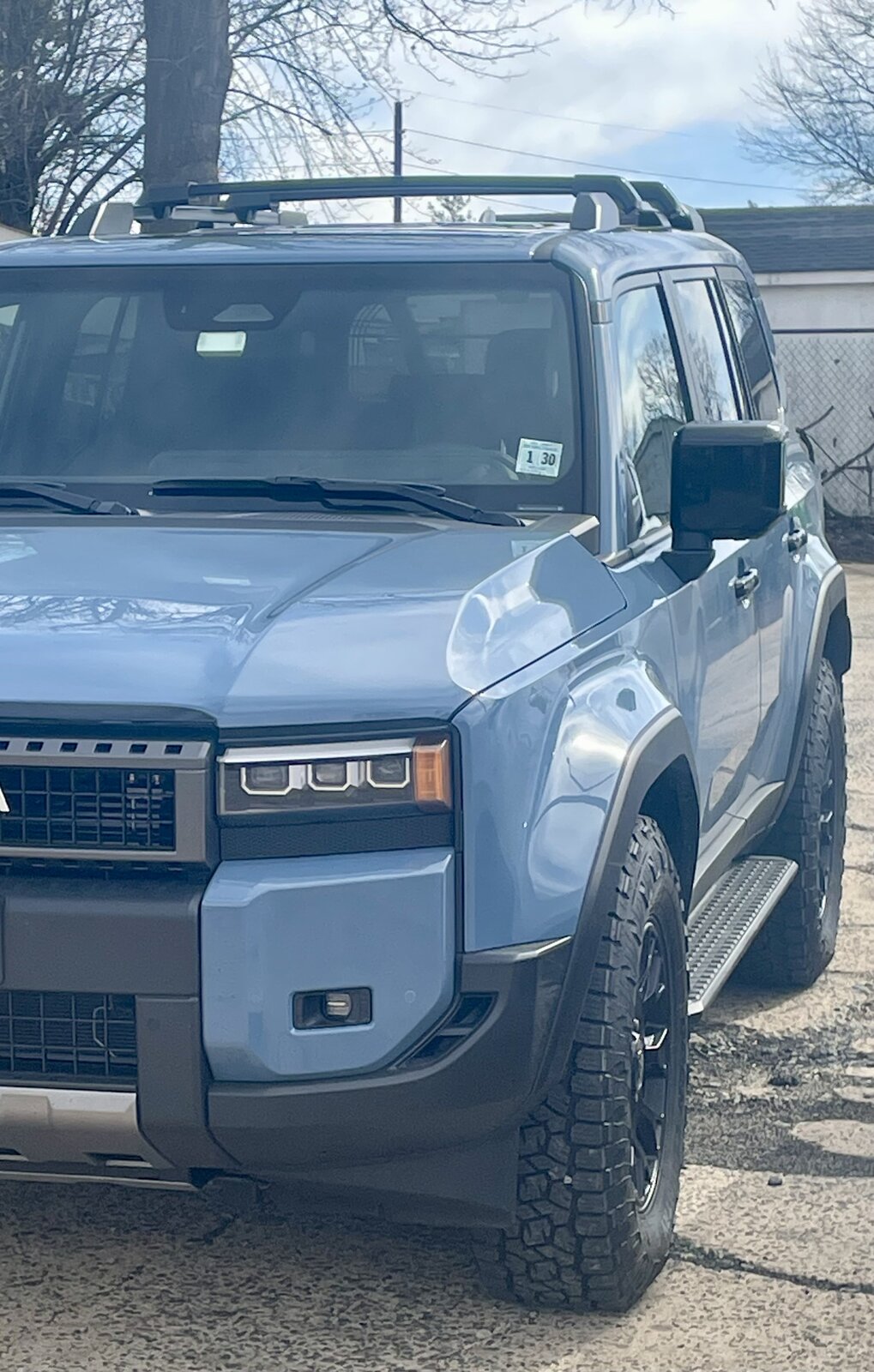

Just completed switching from the stock 20” dunlops to the Tacoma TRD 18” wheels and the Toyo Open Country AT3 EV 275/70R18.
Initial thoughts. The tires are light, I had them delivered from Tire Rack and then my local shop installed them. Off the rims they felt almost too light, but that’s kinda the point of them so ok I guess.
Ive completed half a tank this weekend running errands, longest trip 20 miles (23mpg that trip), most trips under 10 miles, temps here about 55 so the LC has rarely been warmed up and I am at exactly 20.0mpg since I reset after install.
That is about the same as I got on the stock oem setup and when manually calculated may be slightly better with the larger tire.
The offset of the TRD rims is exactly what I wanted as it pushed the tires out just enough so the treads are inside the mudflaps, and the overall tire incl sidewall are just perfectly inside the wheel arch.
There is definitely a drone at 50mph and it’s noticeable - but there always is with nice looking A/T tires and it’s no worse than the Wildpeaks I had on my T4R. Around town it isn’t noticeable, above 50 the wind noise kicks in and I usually have the stereo on at that point so not a big concern.

Looks great! Are you running the SL or E version?
SL - I really only plan on light trails with this vehicle so went with the SLs to preserve mpg as they are 10lbs lighter than the E rated LT version.
