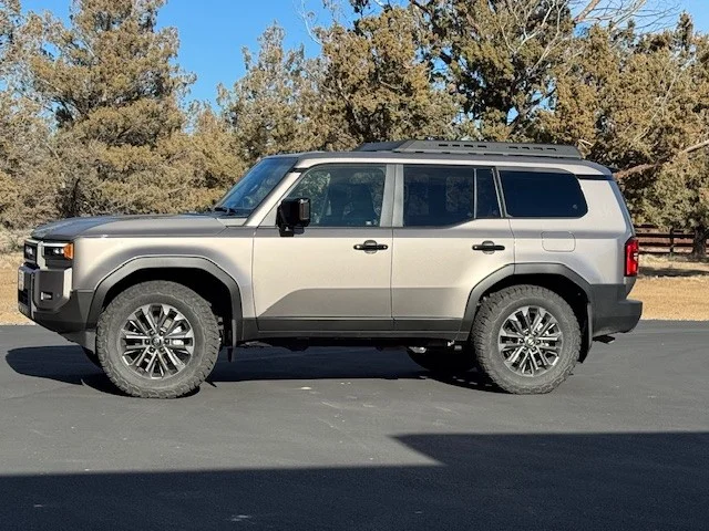

I’ve looked at every tire and wheel thread there is over the last few weeks. I know there are a few 20” wheel post with a pic, but most are buried in large threads or the few that are running the 20” wheel mention it and are without a pic. I really like the 20” wheels and for my future use case, they will be fine. Only planning on light off-road/camping and 95% highway use.
That said, I’d like to see some different pics to help me decide on a 265 vs 275 tire. Would love to see those who are out there running the 20” wheel with AT tires post a pic and state the tire size. I will likely go with the Bridgestone Dueler A/T Ascents, but regardless of what tire you have chosen it would be nice to see some examples in the same thread with the stock 265 vs. slightly larger 275. I am leaning towards staying with the 265 unless it’s significantly better looking with the 275.

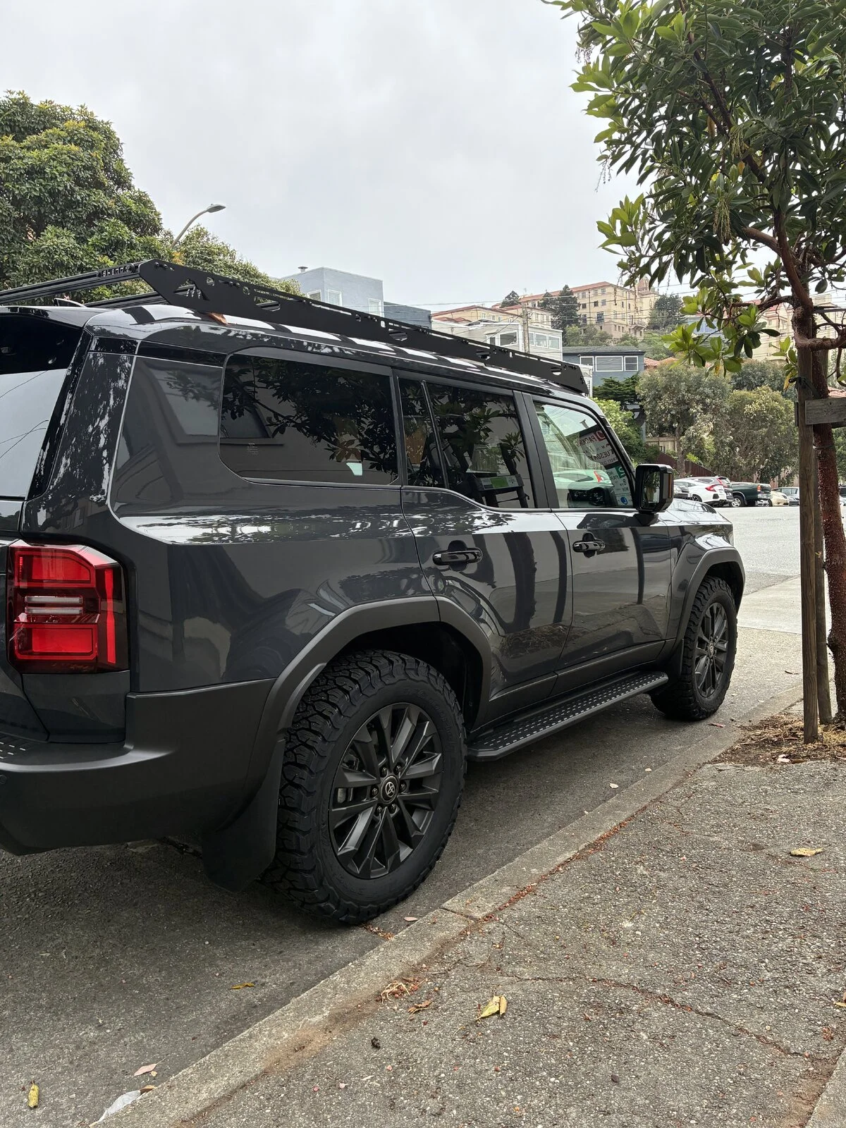

BFG KO3s in 275/60-20. I run them at 40 psi. The ride is much improved with the slightly taller sidewall. Mileage penalty is minimal so far. Maybe 1 mpg. Could not be happier with this upgrade from the stock Geolanders.

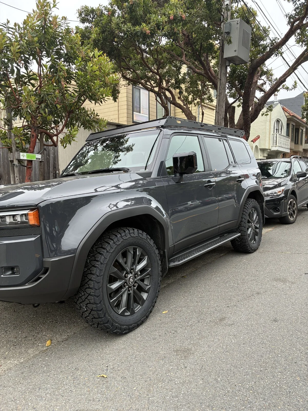

Hey guys! First post here after reading through all of these wheel postings, I went with 275/60/20 in the K03's. Love the look, put them at 40 PSI after reading, will let you know how it goes. I live in SF and do mostly city driving but wanted something that could tackle some moderate trails and the Tahoe ski trips in the winter. Heard these may not be the best in snow, but assuming they are still much better than the stock geolanders...

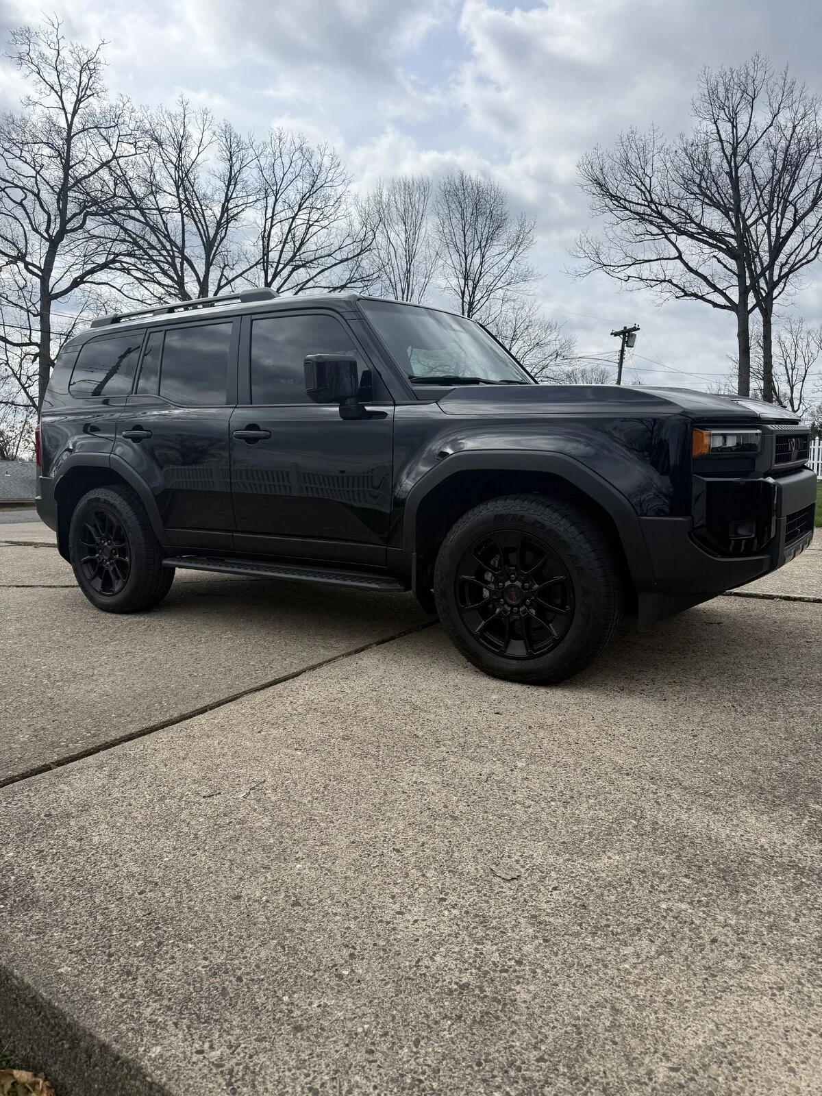

I couldn’t stand the 20” rims that came with my wife’s LC because the car is almost totally black, but the premium wheels were more gunmetal or gray. After 20,000 miles I finally pulled the trigger and got these 20” TRD wheels and tires off of a 1794 Sequoia. I would have preferred 18s from the TRD Pro Tundra/Sequoia, or the 18s on the Tacomas/4Runners, but for the price (and the zero percent chance she ever does any off roading), I really think these 20s are a great option on black and/or white LCs.
Looks good. I'm in the same position and hate the factory 20". I would prefer 18" wheels from Tundra/ Sequoia, 4R, or Tacoma, but there aren't many around that I like on the secondhand market. I wasn't considering 20" but those are nice with ATs.

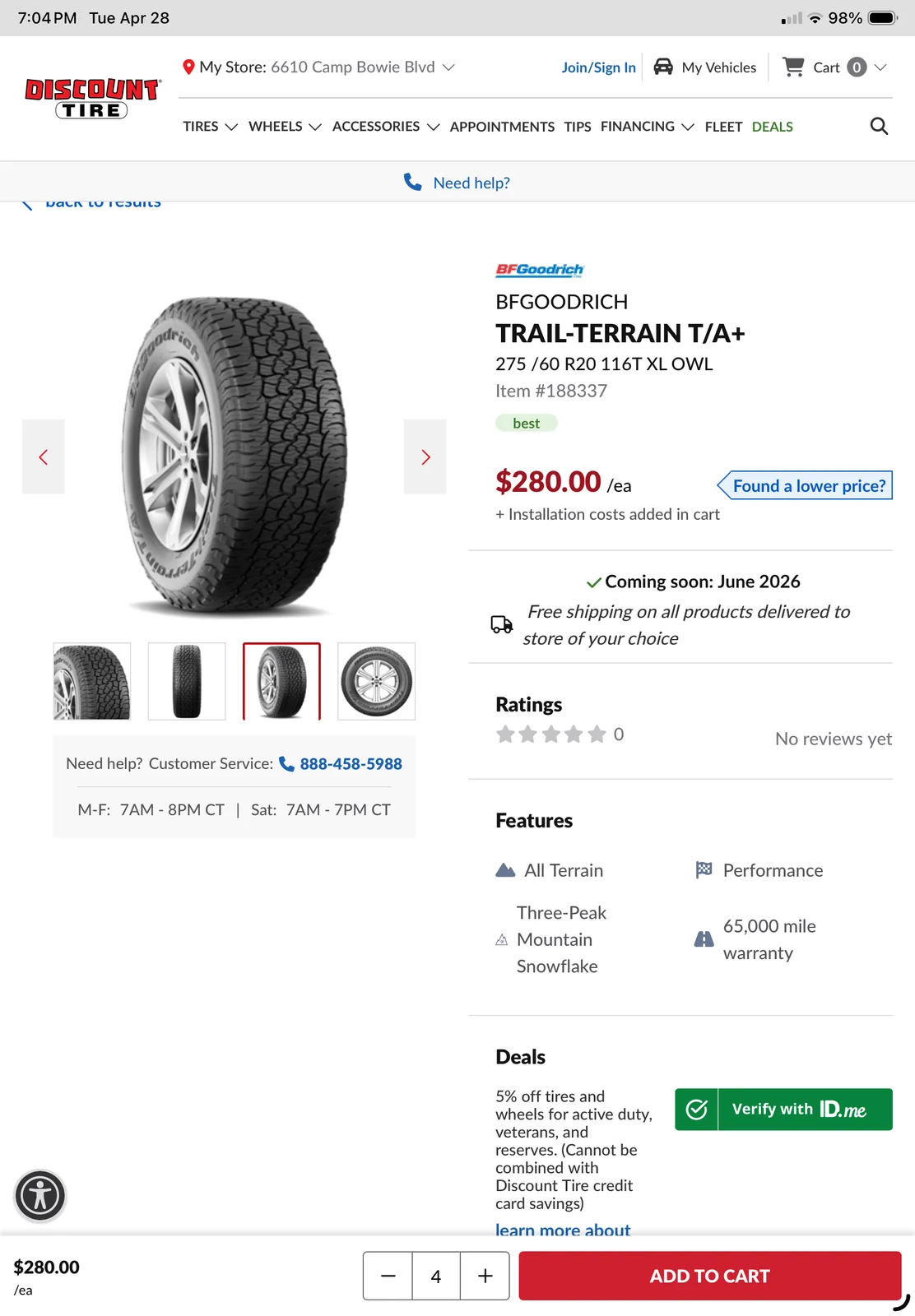

What Matt said! 20” rim is pretty heavy & adding LT tire you will feel the weight in acceleration & braking. Was on Discount tire site few months back shopping & saw BFG had a new tire coming out this summer called Trail Terrain that peaked my interest. Just might be my next set in hopefully 50-60K miles if the Wildpeaks hold up.
Midway between street & AT tread pattern, $280, 46#, rated to 118mph, XL rated.
Regarding the trail terrain t/a's, these have been out for several years. I had these on my 2017 Armada for about 25k miles, I was happy when my son ran over a landscaping stake and I had a reeason to get rid of them. If you look at the edges of the tread, they are solid. In dry conditions, they were fine and actually quiet, but in rain or slushy snow, there is no place for the water to escape, so they are very prone to hydroplaning. I almost got in 2 accidents because of it, fortunately I regained grip just in time to avoid guard rails going around a curve.
